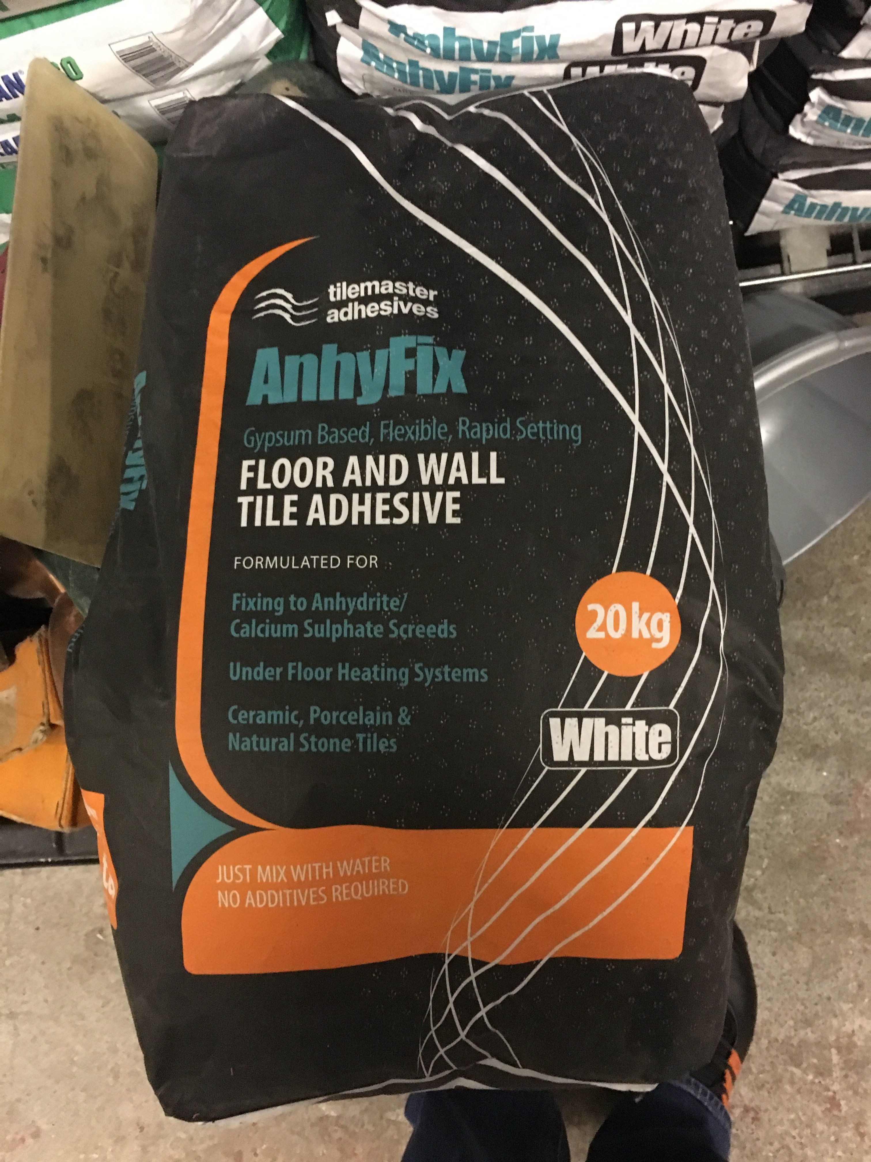

I've done a few gypsum floors & give me them any day over a cement screed.
Anhyfix for adhesive & as long as all rules are followed then there's nothing to be worried about.

Are gypsum based adhesives recommended with British standards??.....I'm sure even if it comes to annhy screeds then British standards recommend priming then cement base addy:confused2:
Can any of you technical gurus confirm???
I'm not sure what British standards state but why take the chance of putting cement in contact with gypsum when they are not compatible unless you create a barrier between the 2?
Totally see where you are coming from there Stef........it just baffles me why gypsum based adhesives are not mentioned within British standards regarding tiling onto gypsum screeds, so you have Ardex, Bal & Mapei that all recommend priming then using cement based addy and this is British standards they follow, so regarding gypsum based adhesive who makes the rules
They probably haven't caught up yet or haven't a clue about usage of it....
