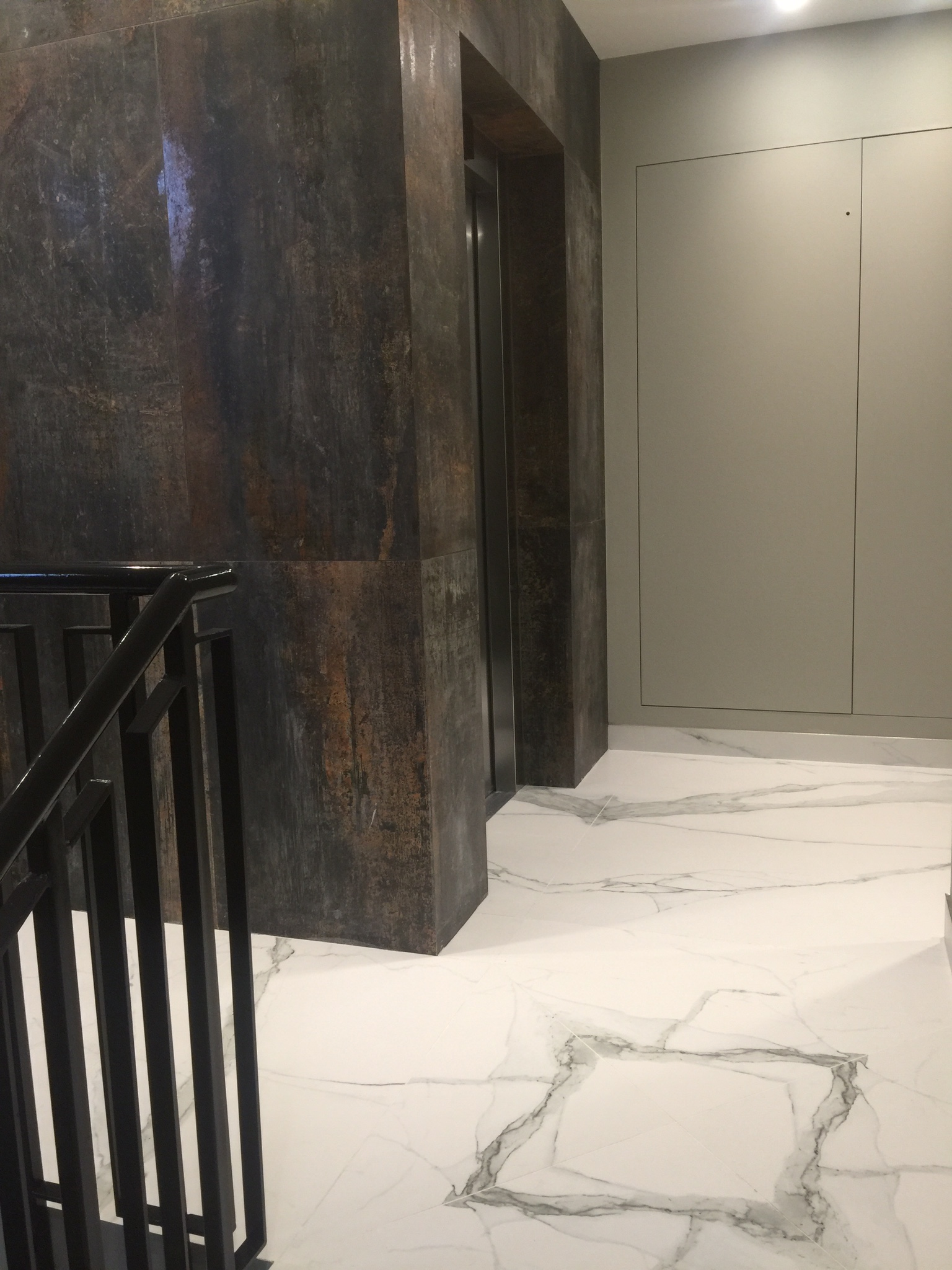

These dark tiles were 12mm and some were cut with a flashline, rest on a 3e3m.
If you need a full time cutter which is used virtually every week, that’s another thread.
EDB8D7CB-BD31-476A-8F5C-65875FEDA433.jpeg B81EE60E-BAB9-416F-BC85-74659679E125.jpeg
