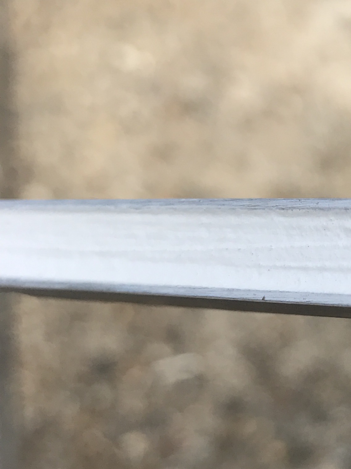

Isomat Smalto 1-8. White grout.
Takes couple of days to dry out completely, but super white.
It also has a porcelain effect finish, which means it dries with a slight sheen.
It's also all the anti whatever's you need for a bathroom.
Used it earlier this year on some bookmatch and it was whiter than the tile.
They use crushed white marble as aggregates.
Acorn Ceramics (Mike Mansell) may be able to help, he's a stockist now.
Comes in 2,4,20kg bags.
I've taken an image to see if I can show the sheen, not sure how successfully it'll translate on here tho.
