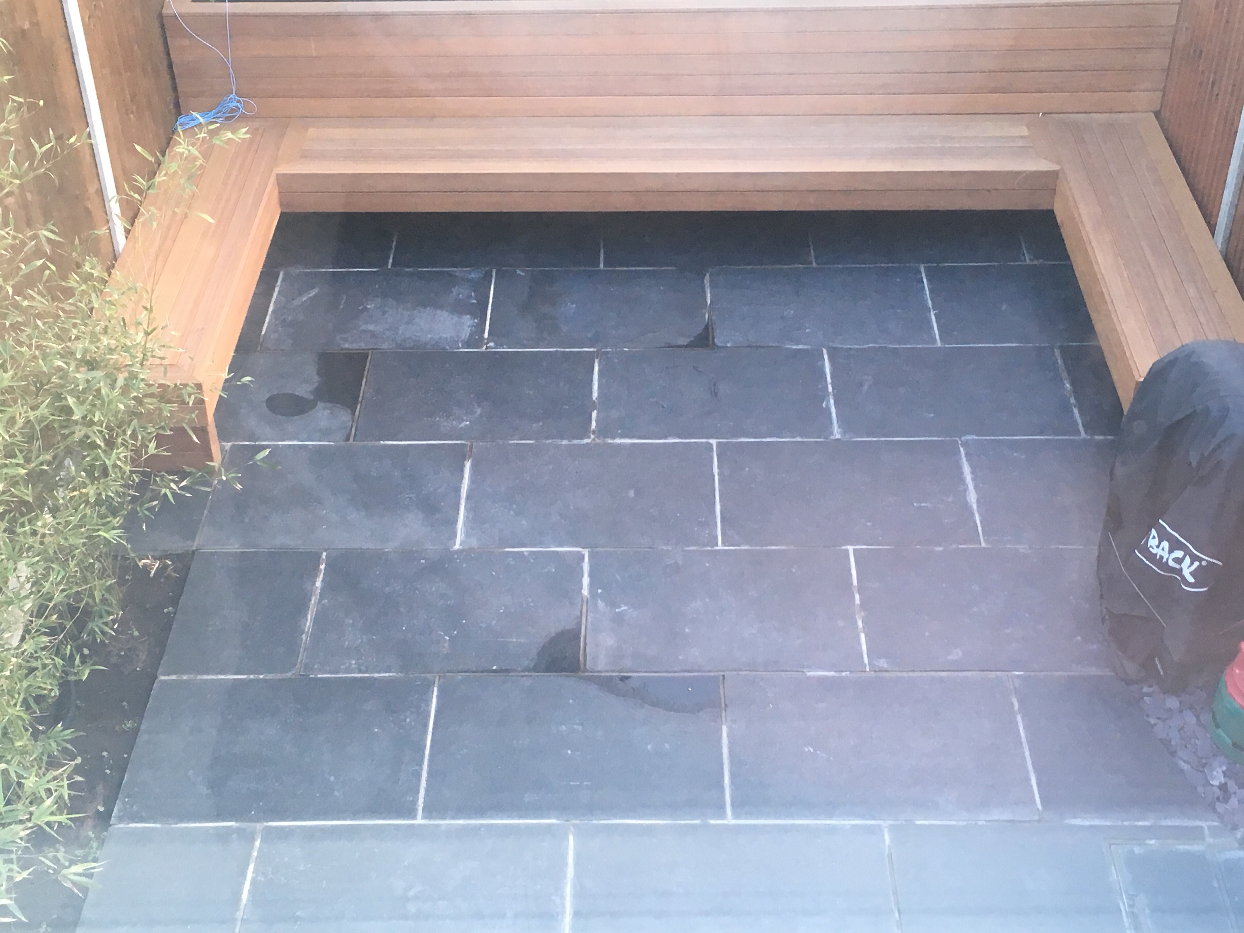

Hello,
Last summer I had a black limestone patio laid. Pretty much straight away white marks showed up on it. I assumed I’d be able to clean them off but I was wrong…
I have read various posts on this forum which have been helpful however I’m a bit lost for what my next step should be.
I have to used LTP Grimex and it made little or no difference, even undiluted.
I’m wondering if I should risk using an acid based cleaner like ‘LTP Grout Stain Remover’. I’ve read never to use an acid based cleaner on limestone as it can lighten in. However I’ve also read this product can be used to remove the white marks.
So I’m thinking maybe I could do this. On a test stone try using some TP Grout Stain Remover. Then use LTP Stone Oil to seal. Finally using LTP colour intensifier and stainblock.
Does this sound sensible or can someone suggest an alternative approach ?
Thanks

First off, don't use Grout Stain remover, Does just cause marks, it will dissolve the limestone and etch it. Instead, try the LTP Powerstripper to remove any previous sealer. Seal with the the Colour Intensifier. Not wise to mix oil based followed by synthetic as the latter will just film over. Just stick to the one.
What was it sealed with previously and also, is there a membrane under the concrete slab/screed?
Aaaannnnndddd....... if it is a newish screed, when was it laid (month), how thick is it, and long was it left to dry before tiling?
No further questions your honour.
AngryBunny
I had the patio laid for me so some of the questions I can't give an exact answer.
I've text the company to ask them what type of sealer was used.
There was a membrane laid. I know they used concrete to secure the stone to the ground. Was this incorrect? ( I know in a house you can lay a screed then leave it a month to dry out), is that what you're supposed to do with a patio as well and is this an issue with moisture escaping as it cures?
(It was laid in October I think)
(It's a bit disappointing as this company have good reviews, etc)
Tommcd
Phil -not a patio expert
I had this problem, didn't read into the problem of black limestone before filling in the cracks with Mortar.
I have managed to removed 90% of the stains by a combination of Karcher and scrubbing with a little bit of 'pink stuff' cleaner. Then applied LTP external stone sealer (water based).
Hope that helps.
