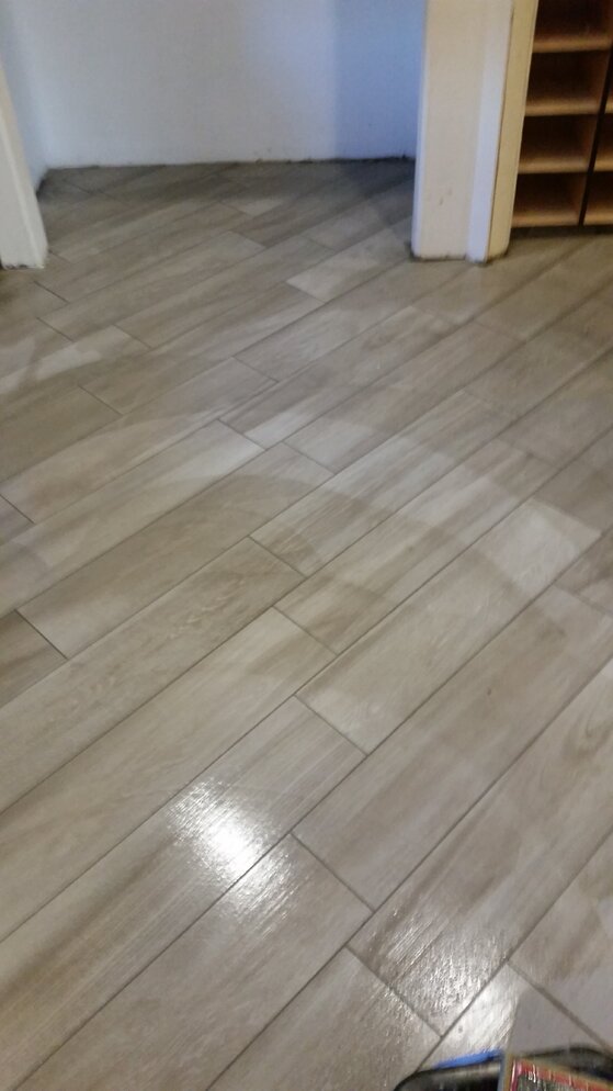

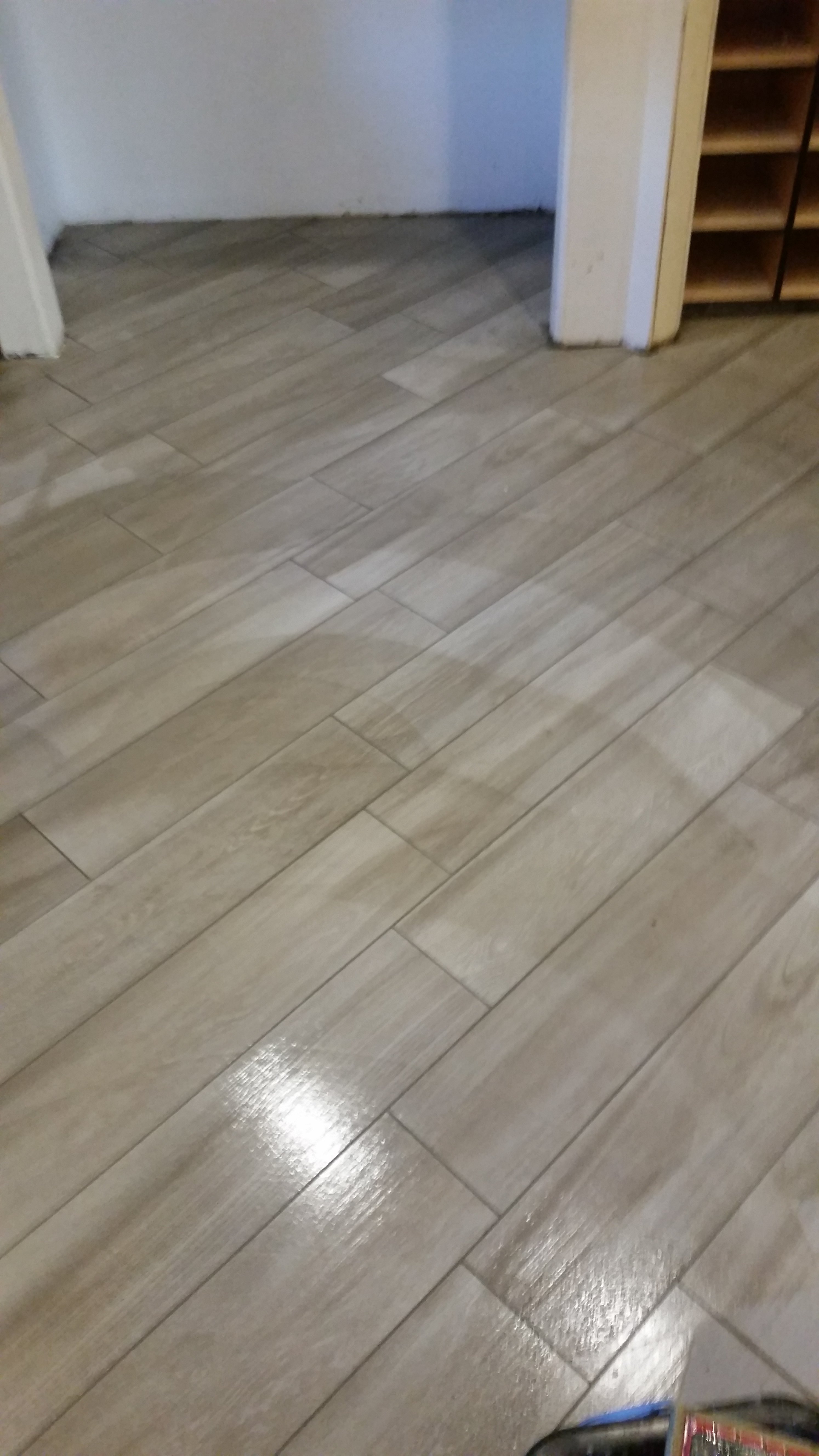

I agree with setting them random, but I did one recently and had some joints too close. That would be my only warning, Make sure you don't set joints too close. Looks bad with tile, not with real wood.
Years ago a customer insisted on broken / stretcher bond.... ( against manufacturers advice) Although looked OK .. As we know because of the nature ( bend ) that is common in these tiles .. A slight high spot can occur...
Deffo random is the way to go ....both for looks and finish
