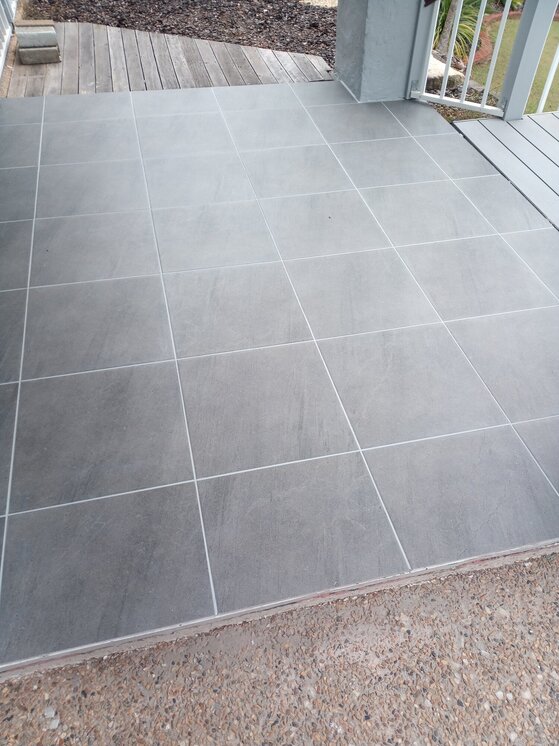

Have a look at this product . This is an Australian site but is also available in the UK. groutperfect.com.au. A 250mil mil bottle goes a long way , I used less than half a bottle for 14 sqm of 450 x 450 porcelain tiles with 3 mm grout lines . It gives a natural , matte finish and seals at the same time . It will only work on grout lines that are " recessed " otherwise you'll continually be wiping it out of the lines and only apply to a small section at a time. One advantage is you can stop and start as often as you like without the risk of uneven colouring . I used it in Australian conditions on a semi-covered patio and found it easier to remove the excess if I wiped over each section with a damp sponge before applying . Hope this helps , it's definitely an easier option to regrouting with no risk of damage to tiles .
