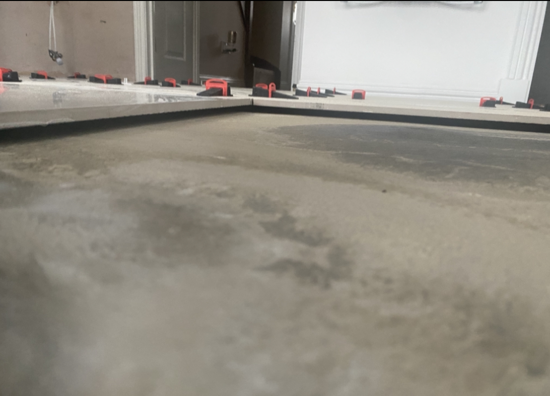

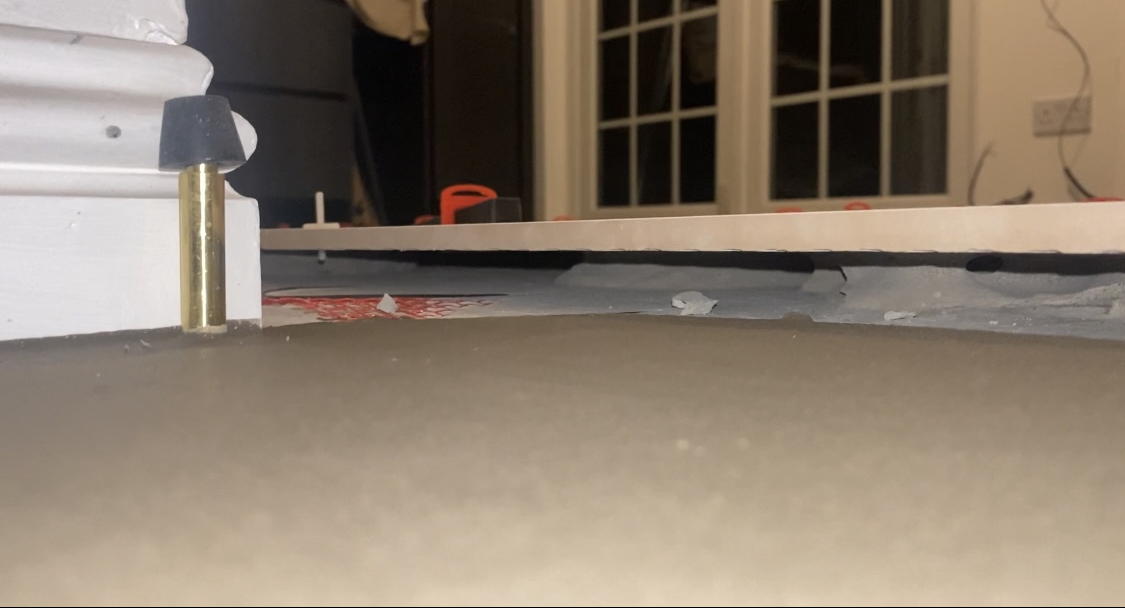

Hi,

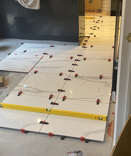

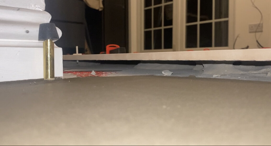

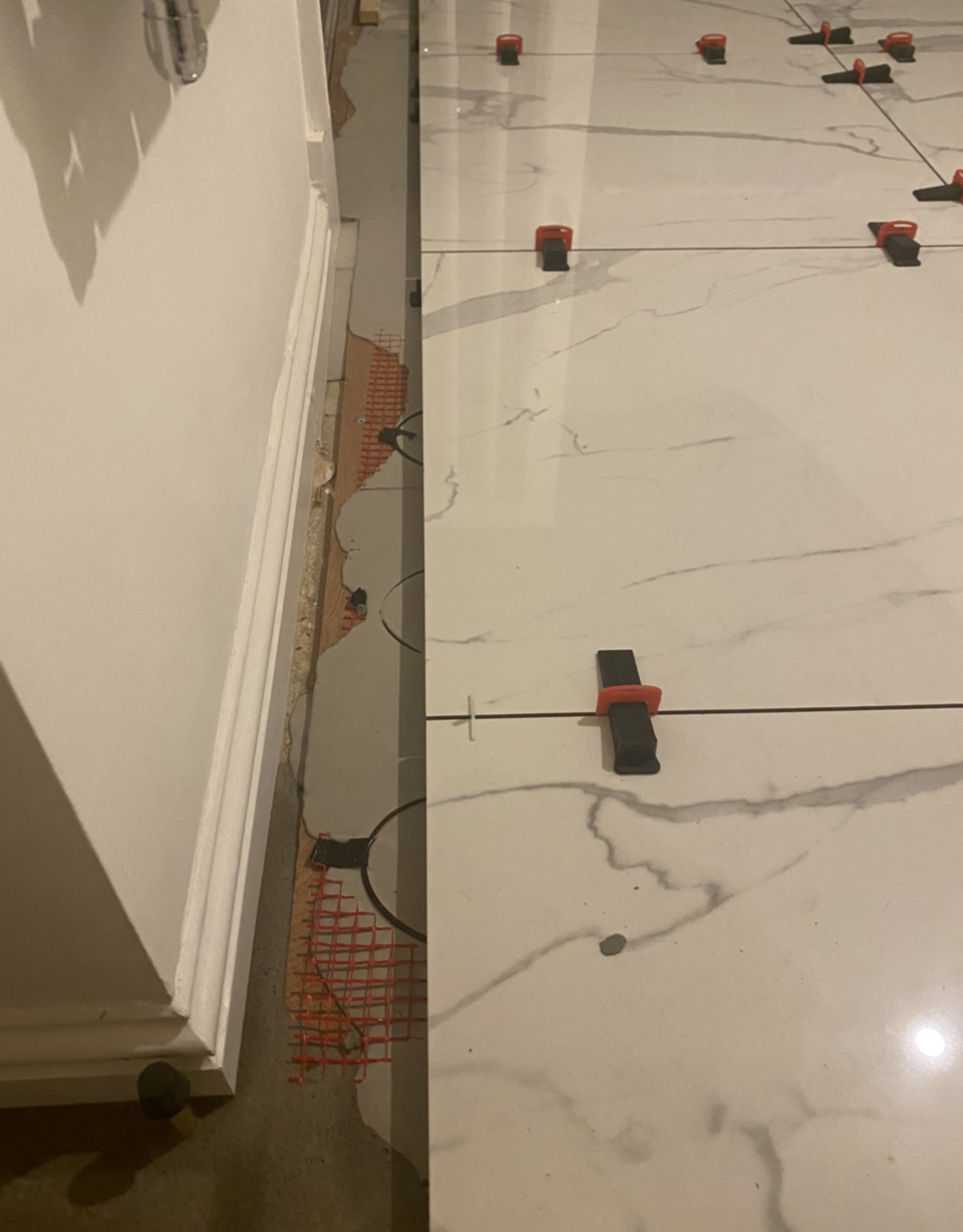

I’m not a tiler - which is why I have one in working away on my new kitchen floor! However I struggle to see the floor lasting very long due to the amount of void under the tiles.
I raised my concerns with the man in charge of the project who said the tiler has since explained that he will ‘pump the gaps with adhesive’.
So can someone help me out to validate my fears or alleviate them….

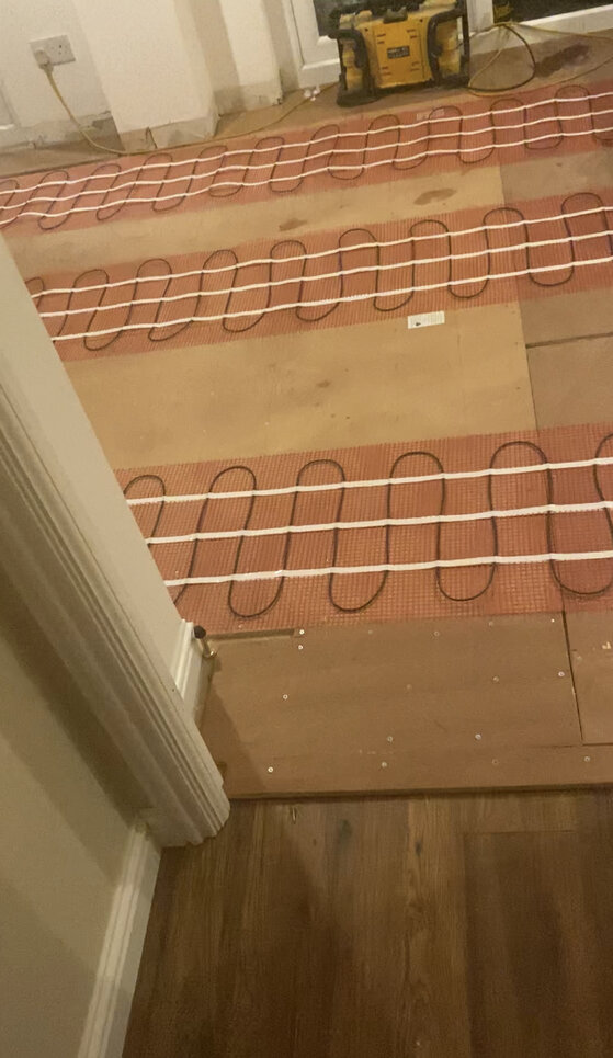

The floor was uneven and a little unsteady previously. It has been ply’d out and a LOT of screws/nails put in. Afterwards some electric heating mats were put down and then there was a self levelling screed poured. MThe electric mats are just to take the chill off the tiles, not heat the room. Every other picture I’ve seen has the mats tightly packed but I seem to have only half the coverage - is this adequte for a gentle heat dispersion across the tiles?
The screed dried very quickly and tiling work commenced the next day. After a couple of days I am just looking at the tiles and I fear the tiles will be prone to snapping due load distribution. When the tiles were going down I think the tiler was back buttering and then slapping down about 5 big globs of adhesive on top before pressing onto the screed.
Is this being followed up with ‘pumping in adhesive’ (which wasn’t mentioned until I questioned the work) a normal technique or am I being taken for a ride now the job is underway? The guys have been really good up until now and there has been some trust built - but I would really appreciate another set of eyes on it as it is sitting uneasy and the explanation wasn’t convincing…

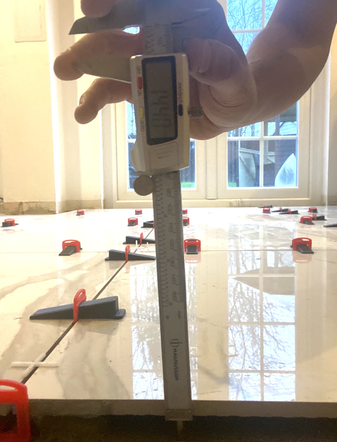

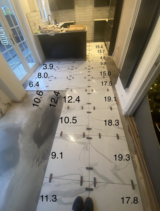

I’ve measured the ‘air gap’ in mm at the midpoint of each tile around the edge in that photo to give you pros an idea of what’s going on.
It appears they are using Mapei ProFast Leveller and Mapei ProFlexible.
Thanks in advance!
