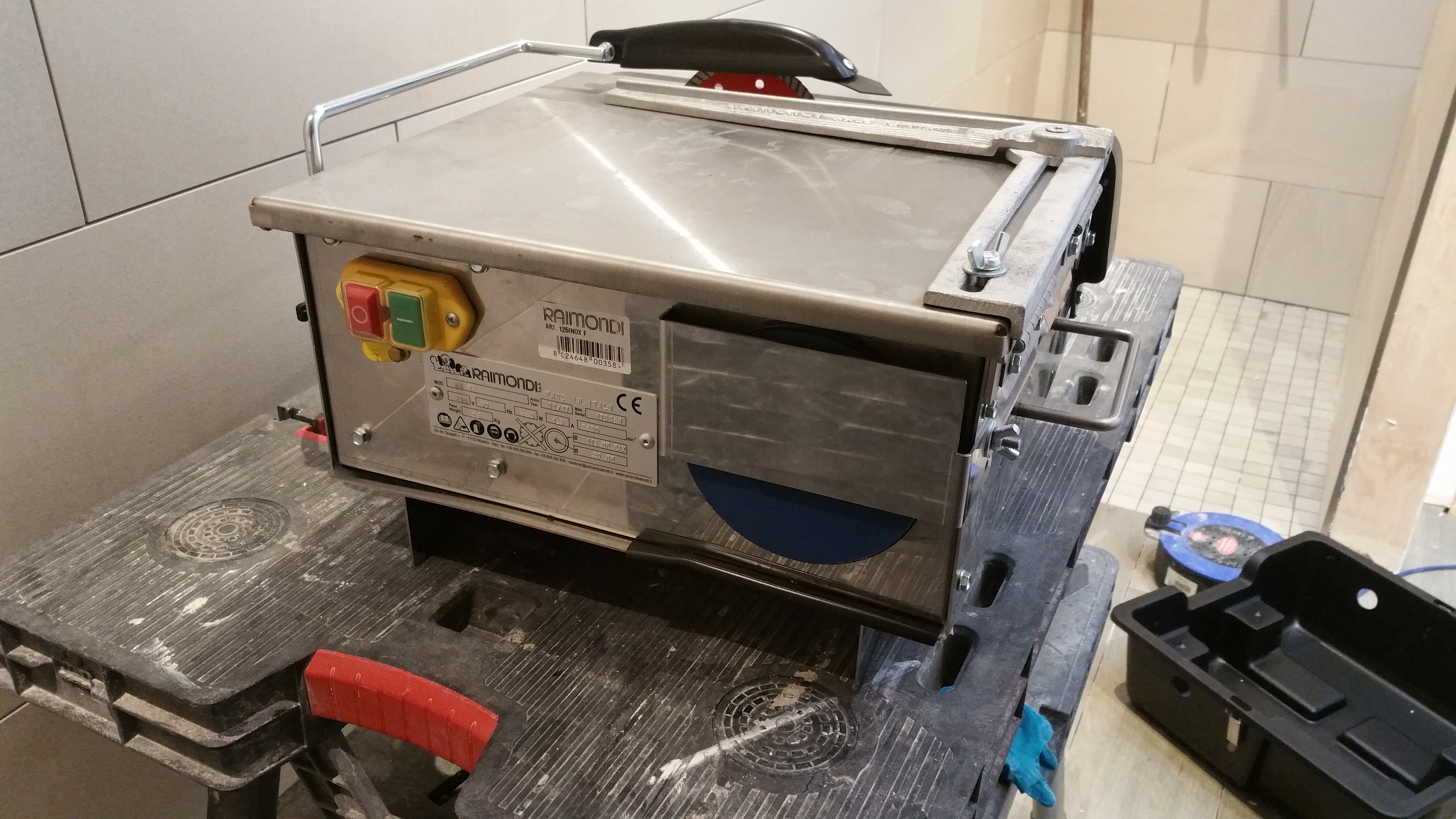

It's a surprisingly small and even more surprisingly heavy box.
Measures 450x450x300mm and weighs about 25kg.
Out of the box, it is encased in a very tough plastic shell with stainless steel clips keeping both halves joined securely.
It is made seemingly entirely from very heavy gauge stainless steel - looks to be about 2.5mm thick - hence the weight.

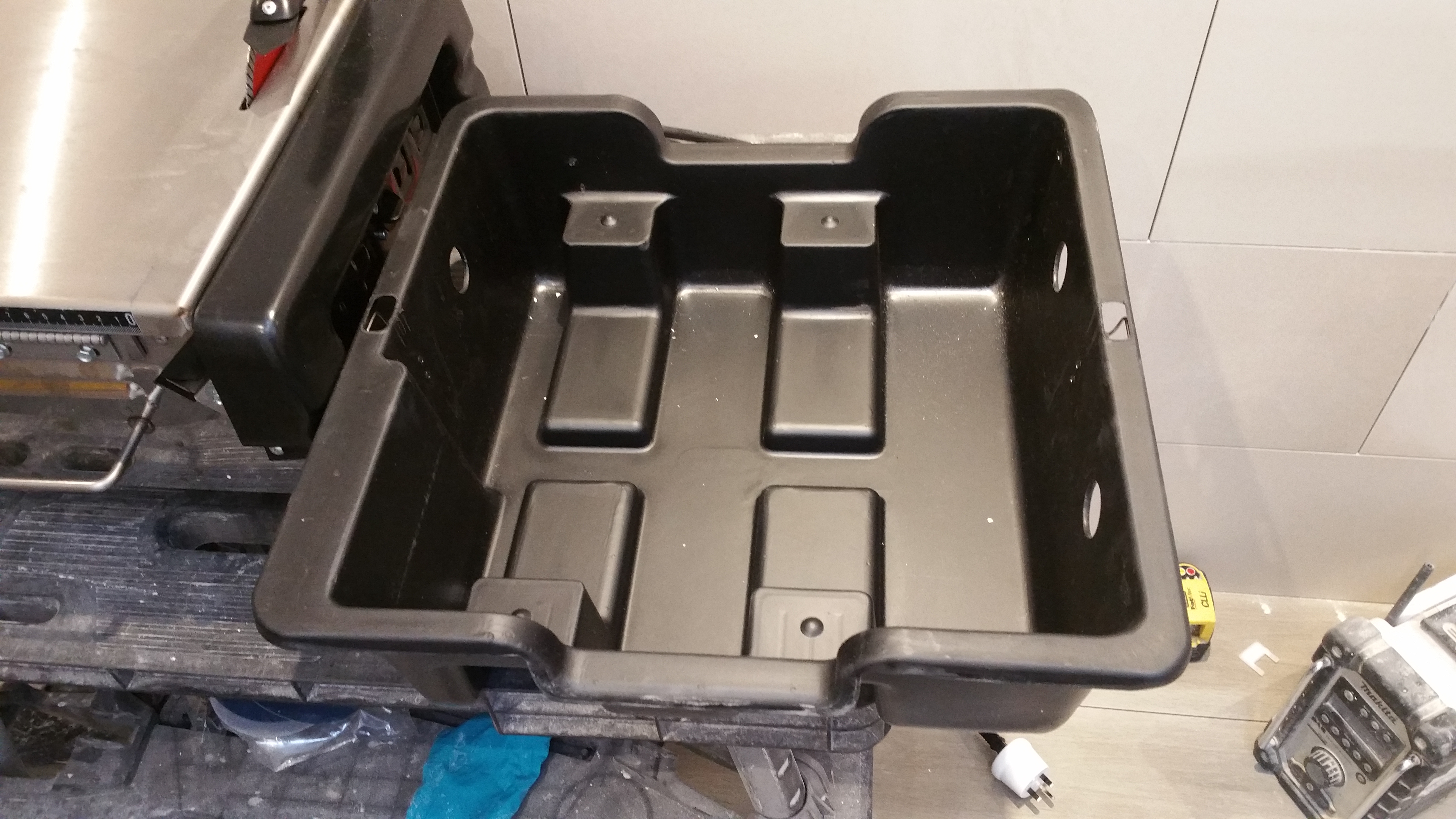

Unlike most (all?) other small saws, this one has a pump for the water:
and a wheel to adjust the flow rate from raging flood to zero.
(a very nice feature if you want to dry-cut)
The only spray is from the front and less than from the Norton.
There is a little spray at the back, but it's easily blocked by a piece of wedi board.

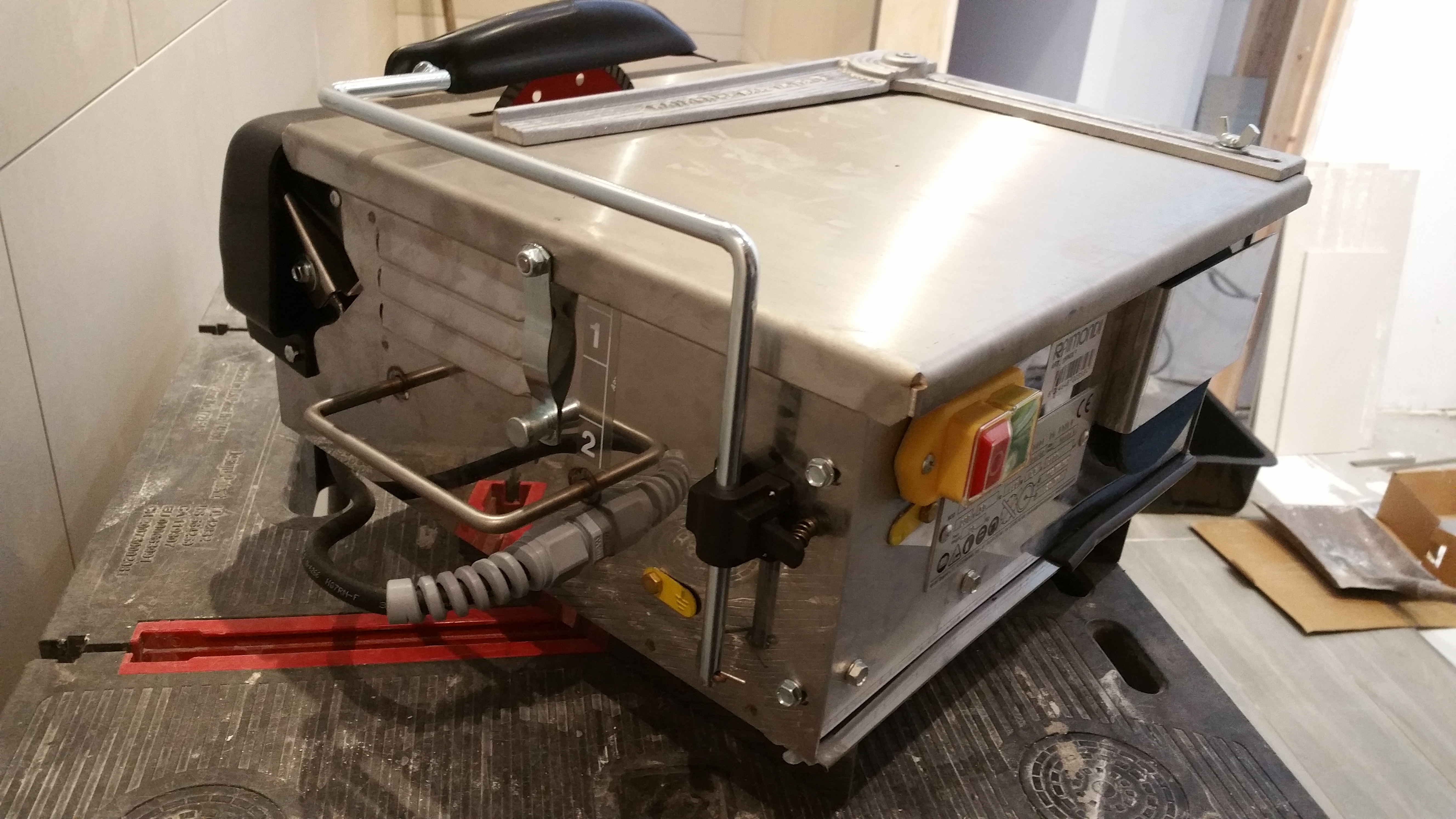

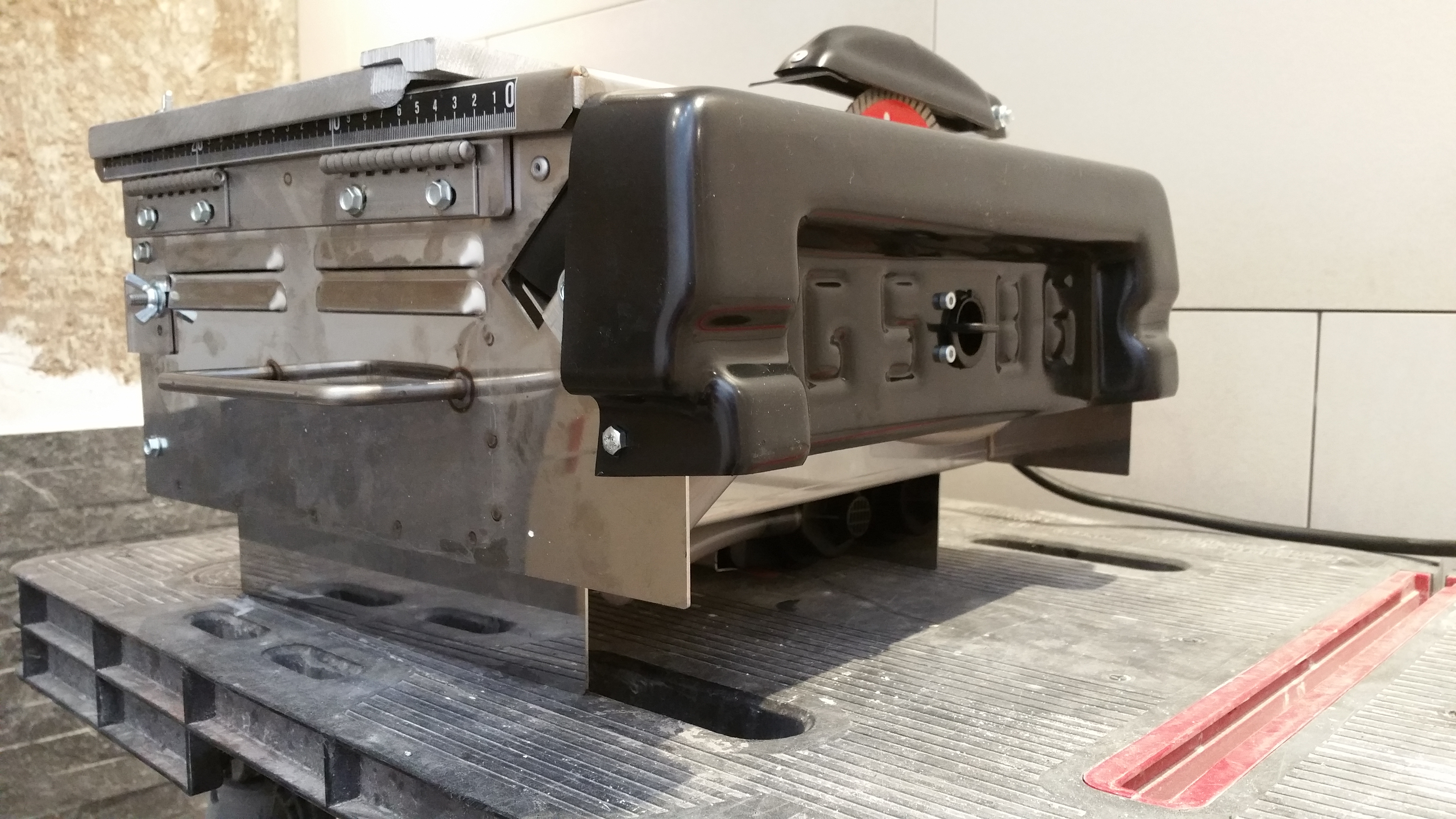

Next picture shows the rear:

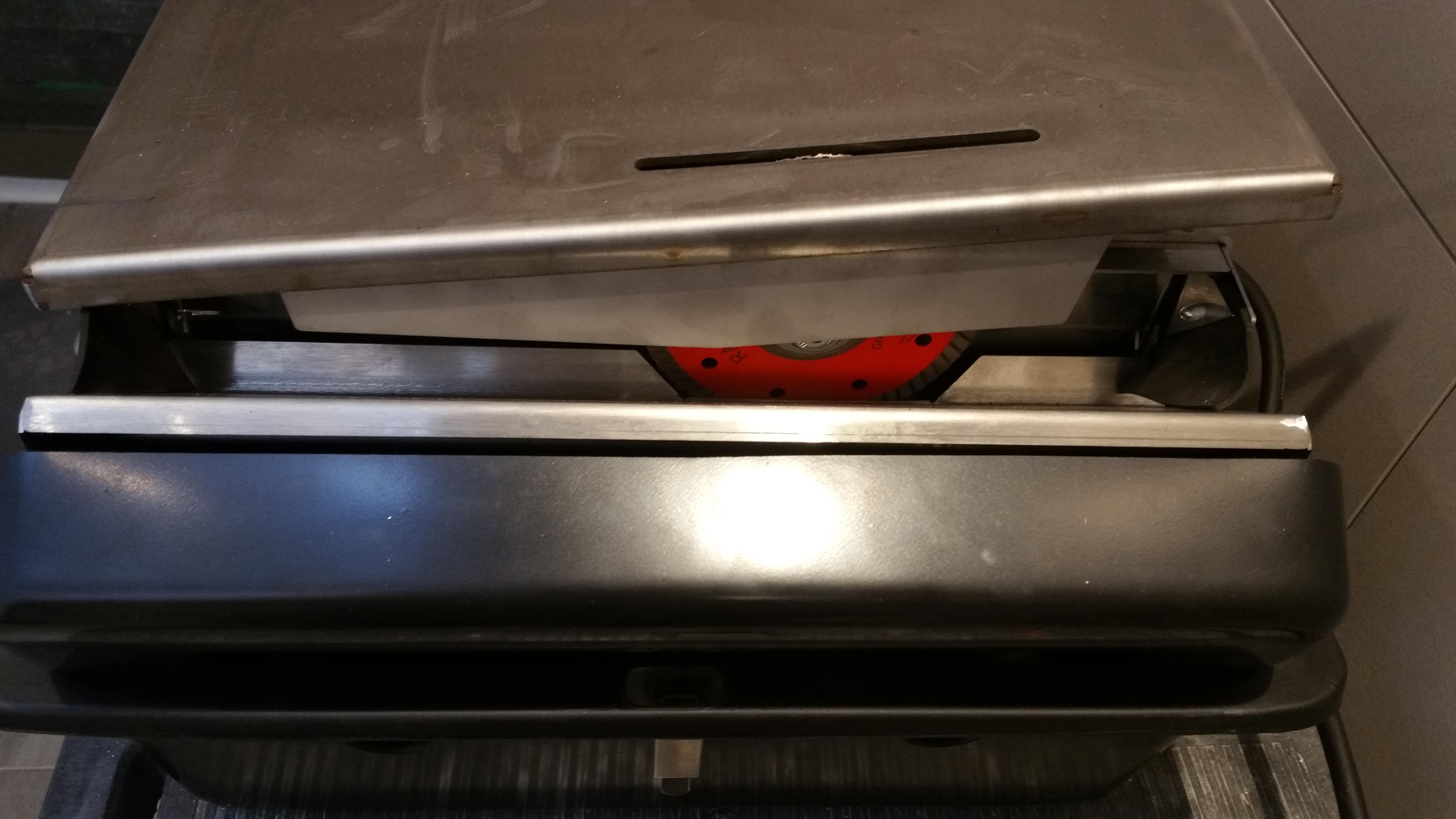

The arm holds the blade cover and is really easy to swing out of the way, adjust height, even remove if you want to use this completely dry (which is one of it's appeals for me).
With position 2 - the bed is flat, as normal but with position 1 - the bed springs up, just above the blade and then can be pushed down, allowing you to do cut outs with great precision. Forgot your hole saws? This will get you by!

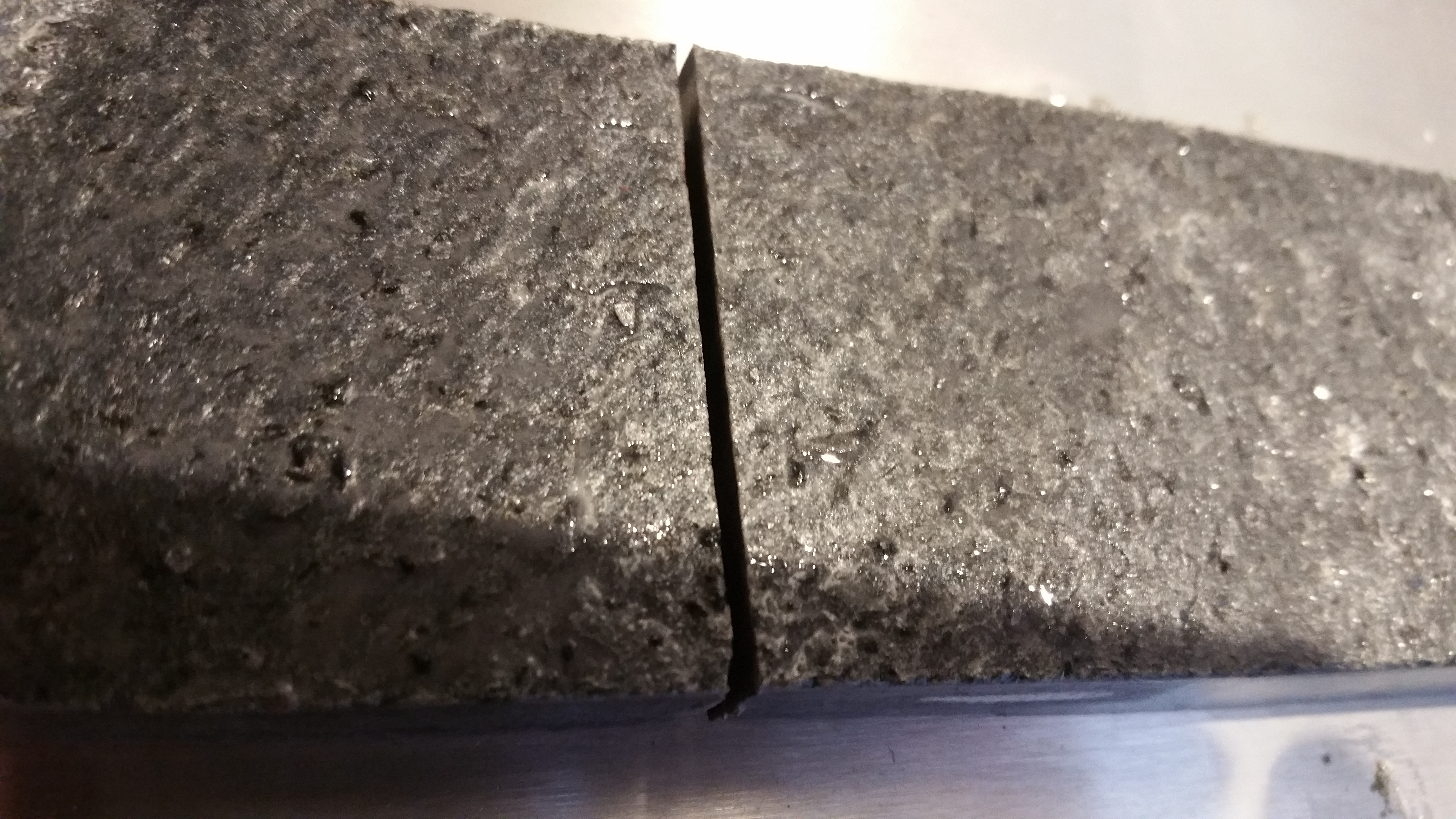

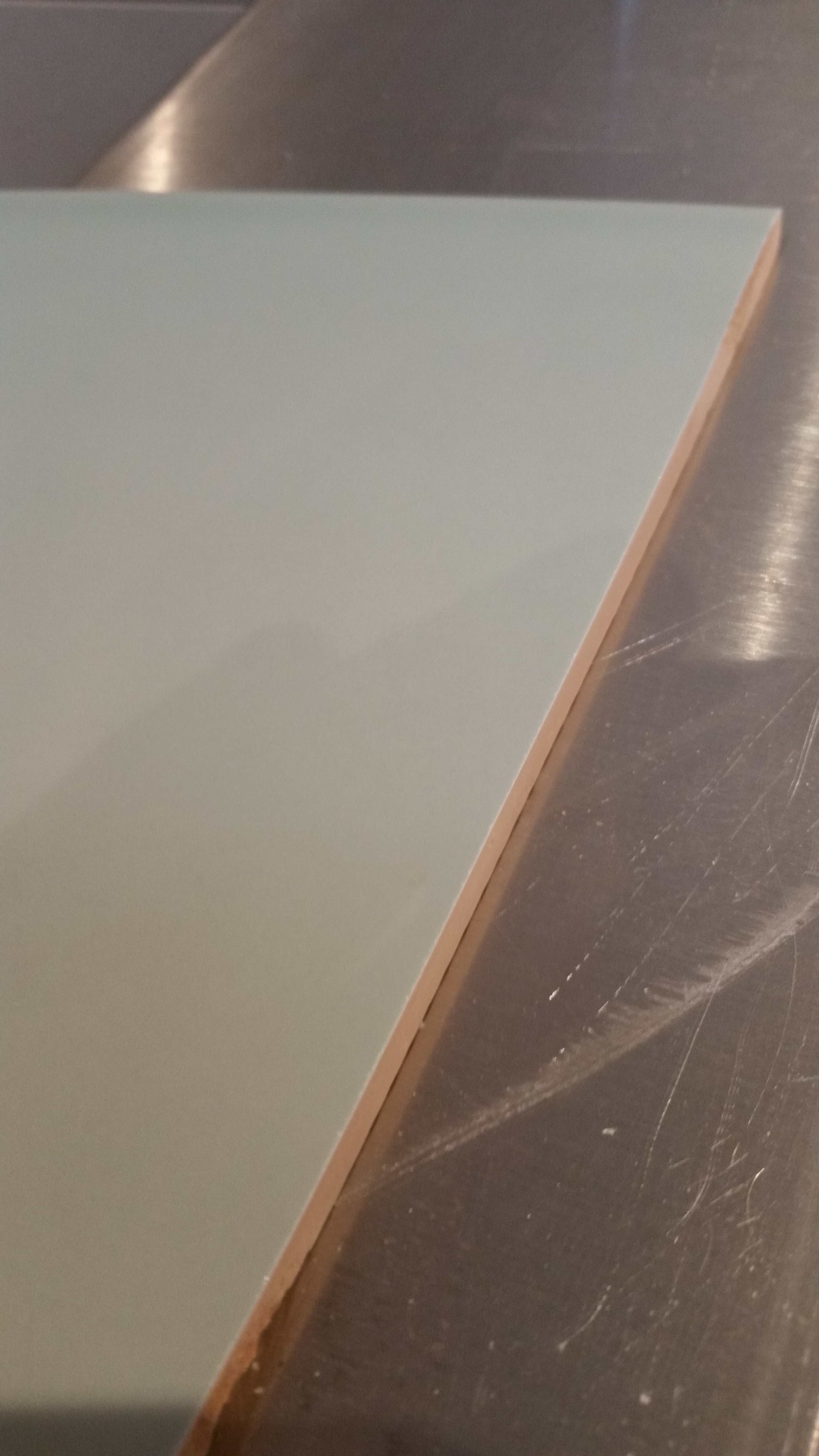

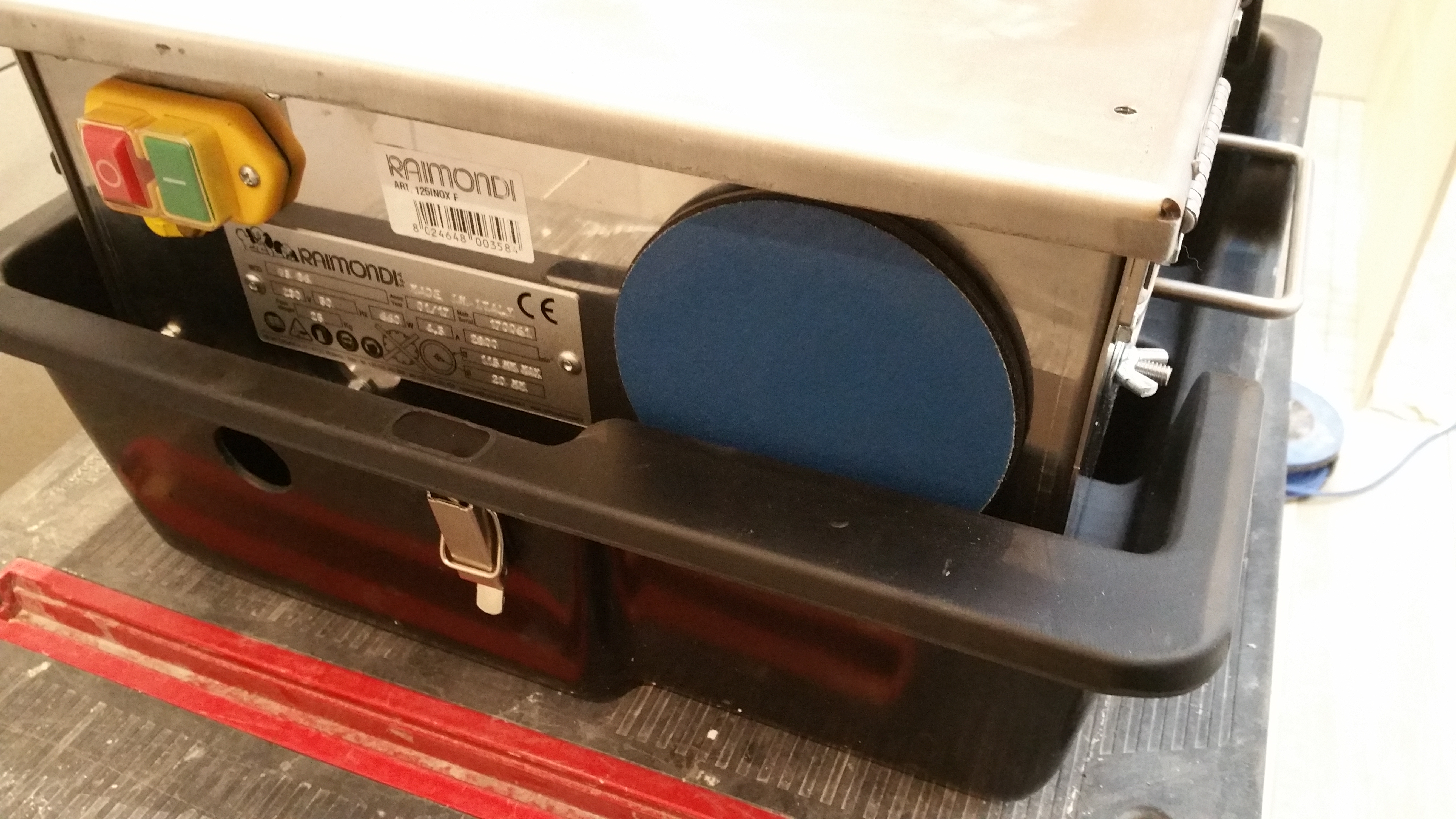

On the right you can see the sanding wheel which is covered by a quick release plate. Takes velcro/fleece discs and is an easy way to get an edge like this in seconds:
The GS86 comes with a Raimondi turbo blade which is good and fast, but I will be fitting a continuous rim blade for porcelain. I think the turbo blade is a little "chippy" - although it still leaves a brilliant edge compared to what I am used to.
