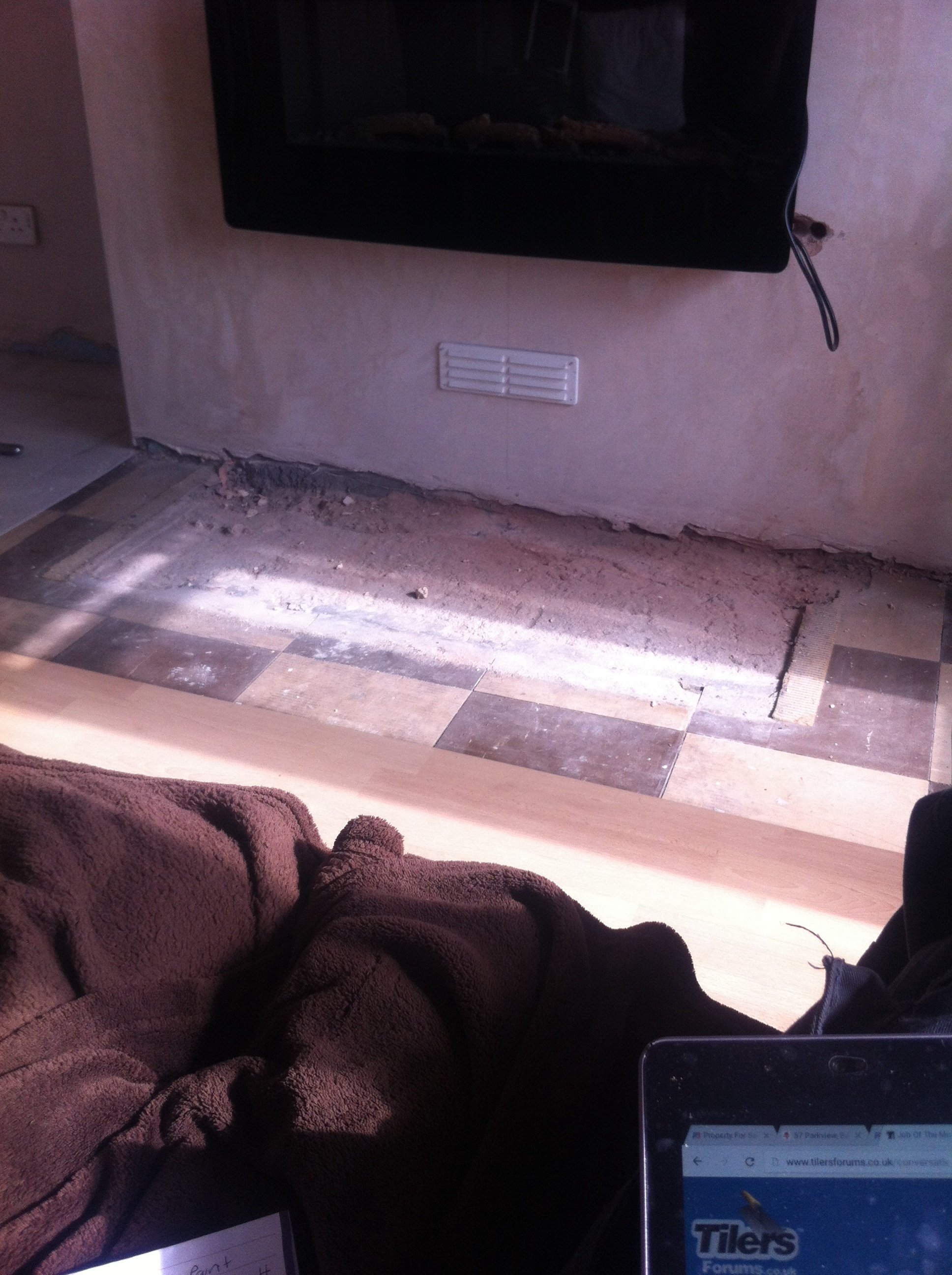

Hi guys, I'm in the process of a living room over haul, I have removed the fireplace and hearth. The floor is laminate over vinyl tiles and I intend to fit a new laminate floor. Over the vinyl. Where the hearth was is rough and low so I was going to use self leveling compound to smooth it up with the surrounding floor.

I'm self leveling over screed, the vinyl tiles were fitted around the old hearth.
I'll try and upload a pic

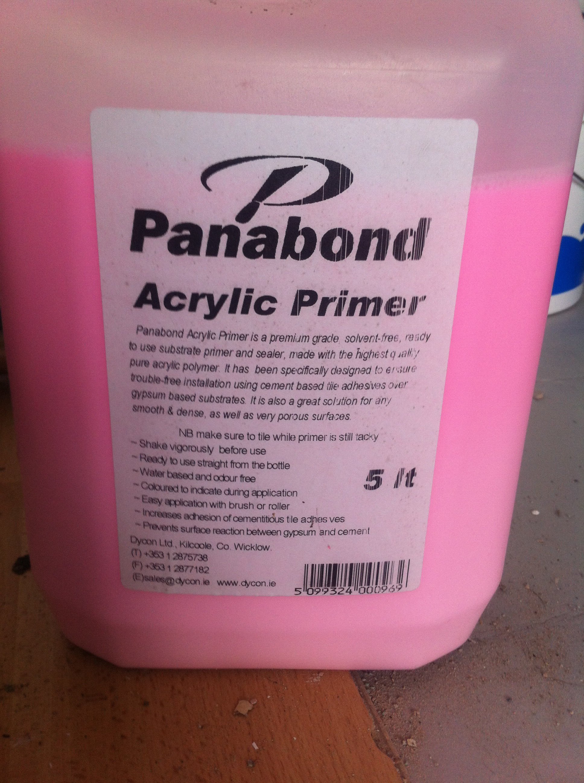

Primed the floor with acrylic primer I had from last year. Hoping it was ok as it smelt the same as when I got it.
Prob being a bit reckless as it's not being tiled so if worst happened I can lift the laminate. How do you know if the primer is ok? There's no use by etc on the bottle .

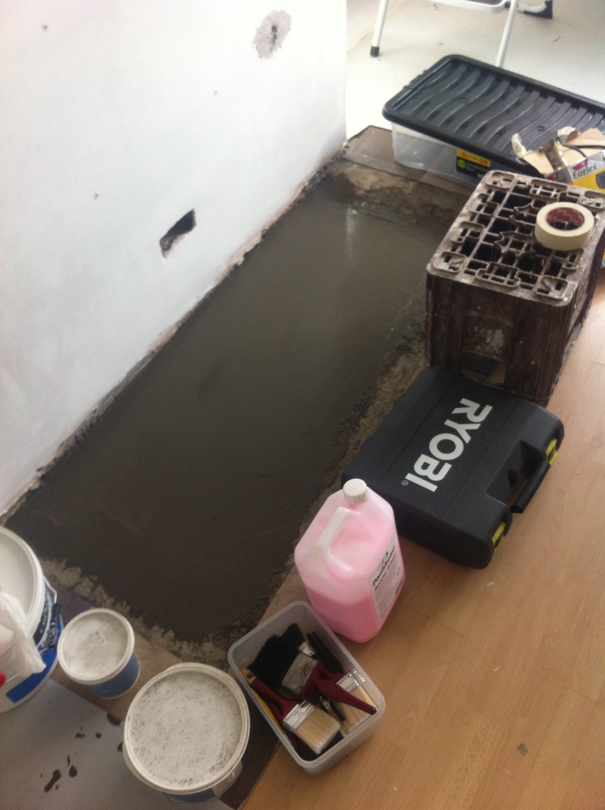

I got self levelling compound from my local tile shop arc high build and used it. Here's the results, hoping it dries ok!
The floor I think was sloping up slightly towards the heart so I have the edges of
original floor coming through at each side but hoping the underlay plus the few mm height of the surrounding vinyl will make it ok!!
