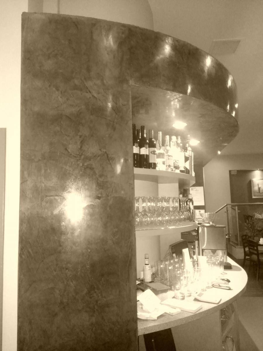

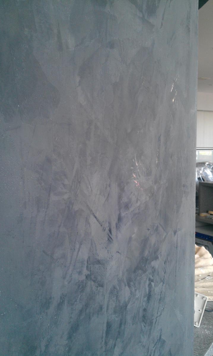

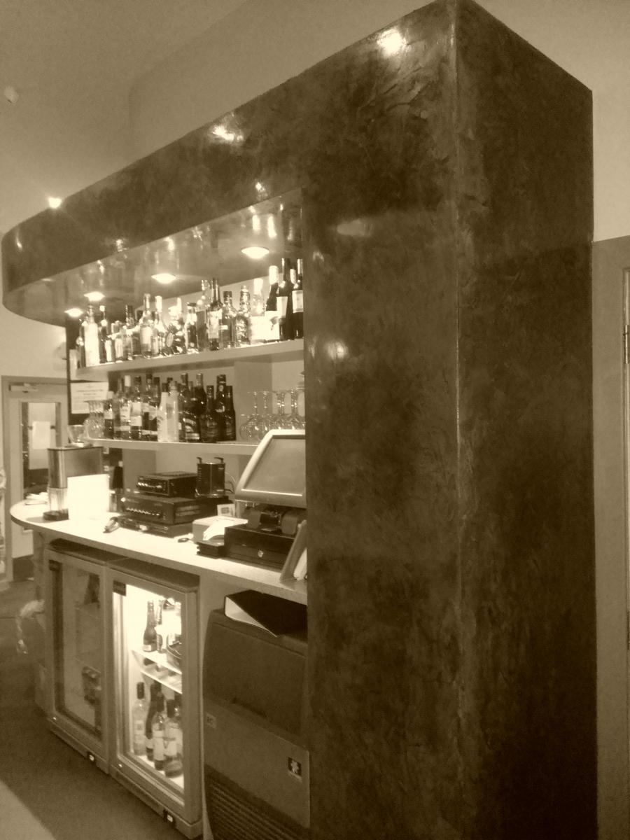

Yes, there are so many finishes to learn, impractising is the shiny one you see above(classico) i find this the most appealing. So what you see above is 2 x coats of carrera marble (slightly grainy) than another 5 or 6 classico (consistency of paint) then 2 coats of bees wax then 1 or 2 coats of parraffine wax.
