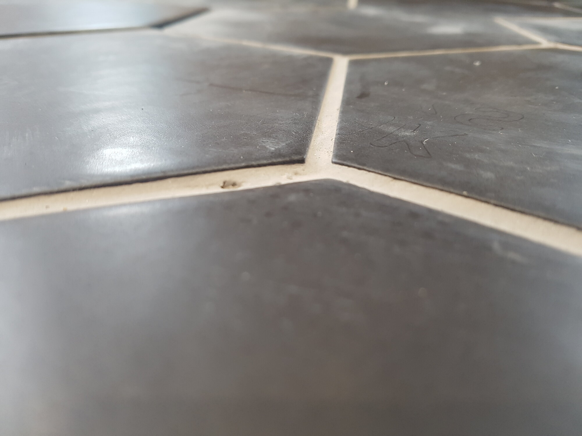

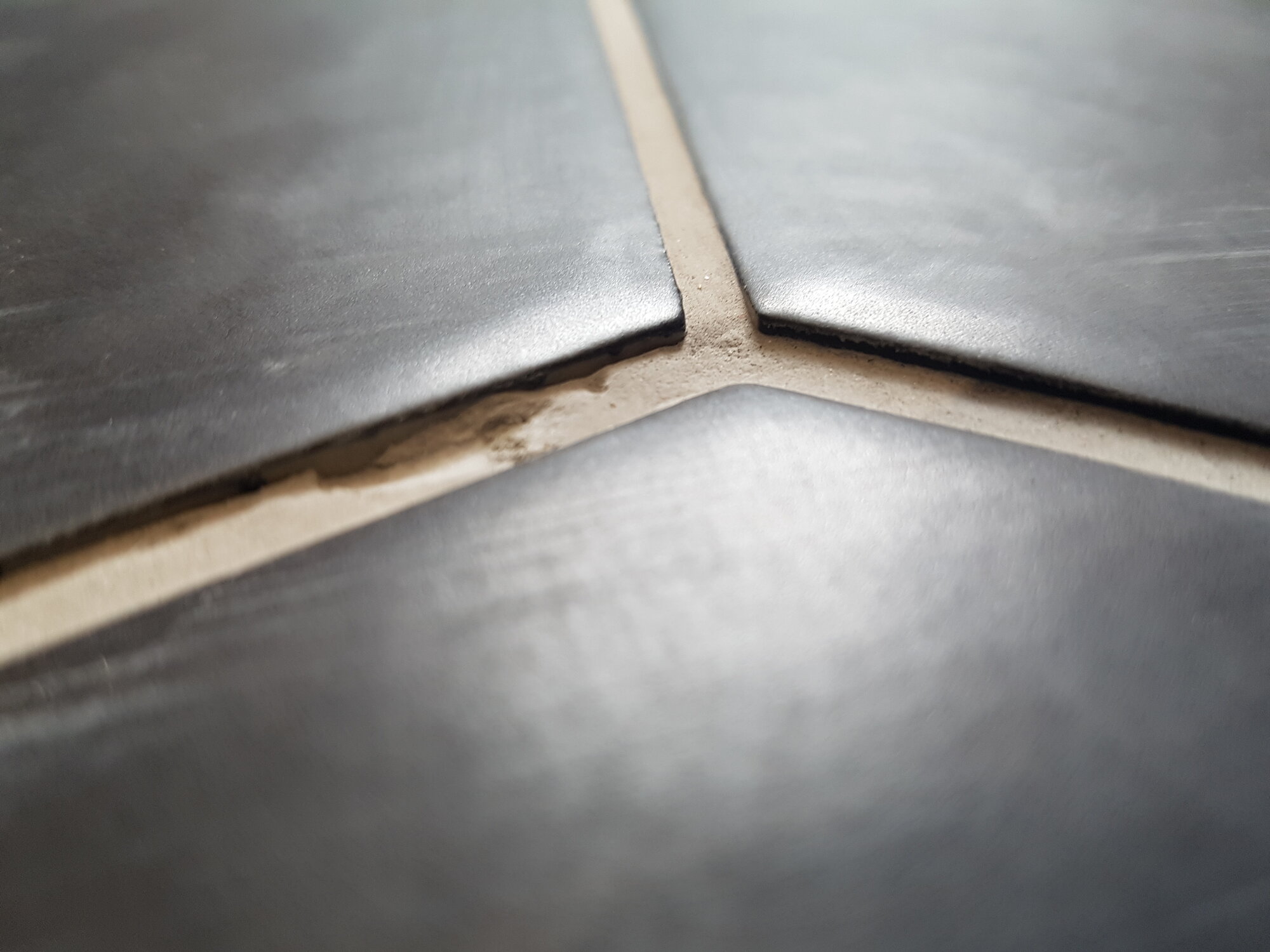

I'm having my kitchen renovated and the tiler came last week and did the floor tiles. They're 175x200mm Porcelain hex tiles. He laid the tiles onto no more ply cement board that was put down by our builders. The day after the tiling I realised the floor isn't flat - almost every tile is not level relative to the tile next to it in random directions and quite a lot of them are wonky. There's some small steps between some tiles (1-3mm) and the grout lines vary between 3-7mm. There's also missing grout in loads of places but I assume that's easily fixed, i'm more worried about the uneveness/unflatness of the floor. From a distance it looks ok, but I can feel it's not flat when i walk on it and some of the worst steps are in high traffic areas (e.g. in front of the hob/top of the stairs).
I flagged the issues with him and he says he can fix it by taking out the worst tiles and relaying them (and already had his chisel out before we finished the conversation), but as almost every tile is uneven to some degree I'm not convinced this would fix the floor. He also said he cant make it flat because the floor he laid onto wasn't flat, but he didn't mention this before tiling otherwise I could have asked our builders to fix it if there was an issue. The floor tiles that were taken out as part of the renovation were not to our taste (inherited them from the old owner) but they were very flat so i can't imagine it would be impossible to lay a flat floor.

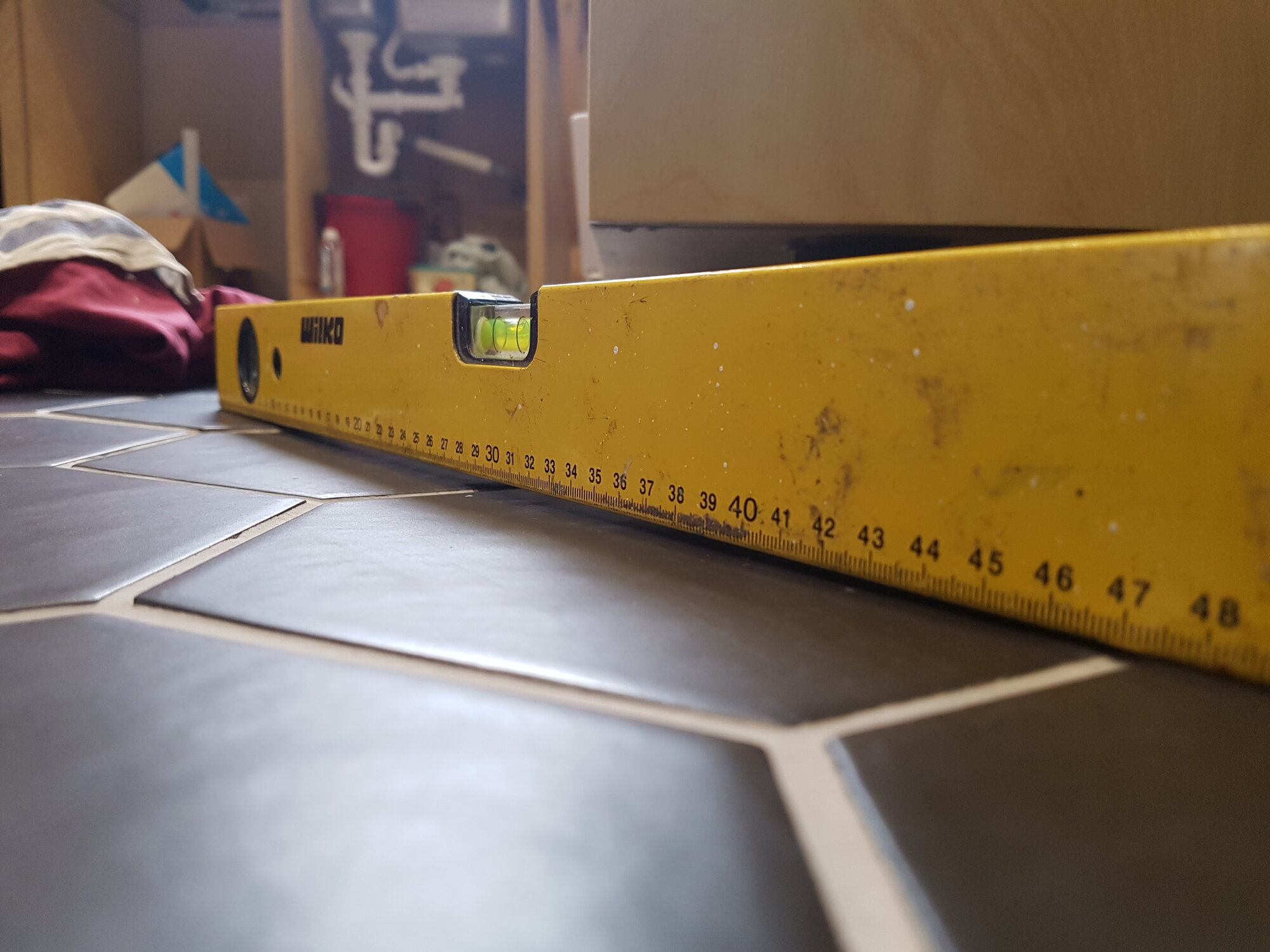

Can you post some pics please?
It would help if you have a long straight edge too (something like a 6ft level) to illustrate the unevenness.
On seeing the pics, we can provide a “fair” assessment rather than jump to tell you it’s a poor job.

I'm not really sure how to take a picture of it to be honest. Do any of these help? I don't have a 6ft straight edge, so just used a 60cm level.

Not much the tiler can do if the floor isn't level to start with unless he uses a much bigger tile. The tiles don't appear to have lippage so I would say the prep work was poor.
As for the grout that's souly the tiler to blame

No that is not good enough in my opinion that lippage is excessive, the grouting is poor and the floor should have been levelled before tiling. Maybe a conversation with the builder and tiler will help matters and they can discuss this with you

It's no good to say the subfloor wasn't level, that's the tilers job!
I've used hex tiles before and they are not "square", the grout lines need adjusting on every tile, at least the ones I used, so varying grout lines I can excuse.
