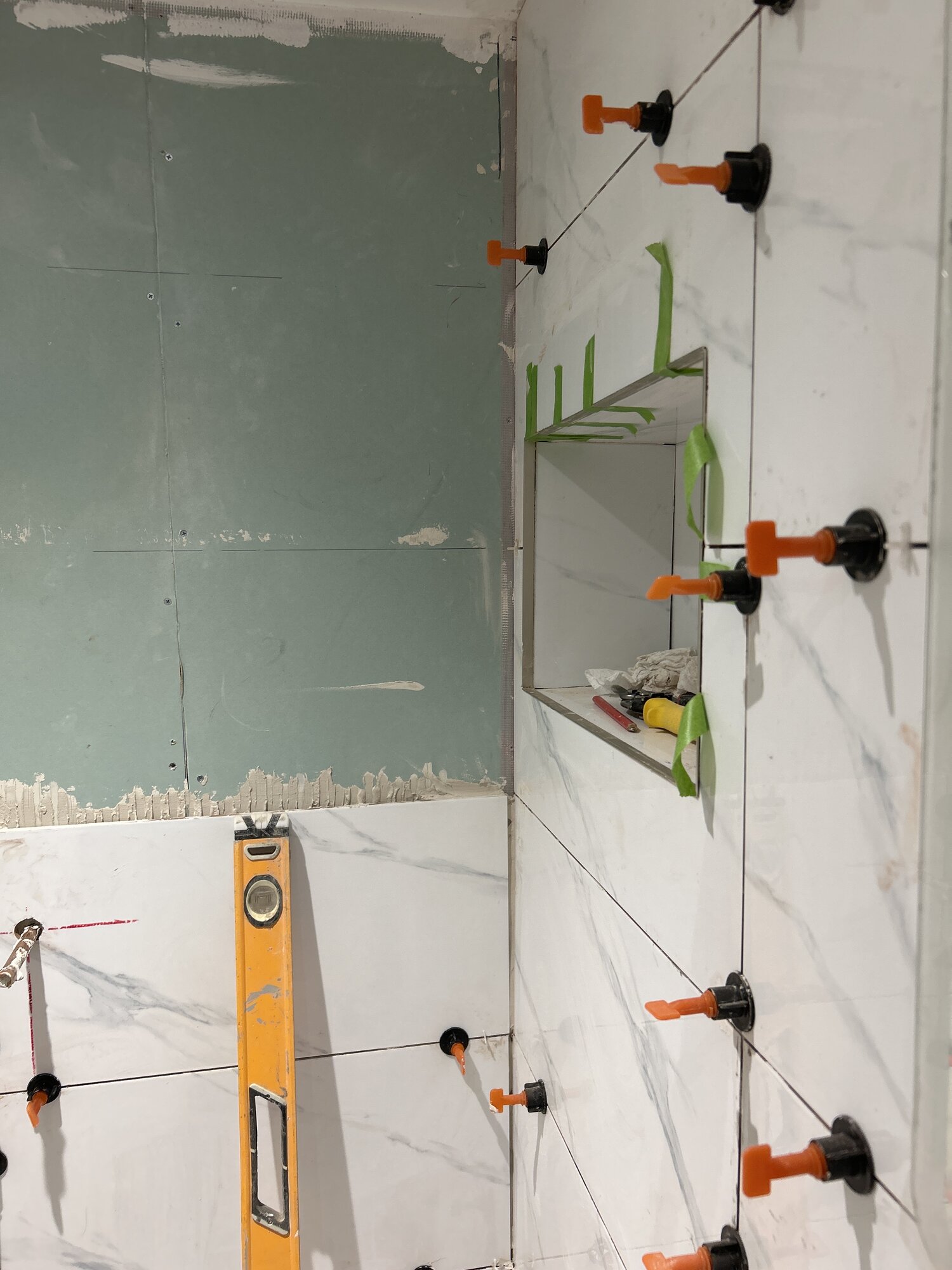

Looking for some advice of tiled my en suite and coming towards the end and gap down the edge is getting bigger as I go higher and looks as though will be about a 20mm gap
What do I do?
Green board inside a shower is not ok. That shower will be leaking like no other, it is just a matter of time. Did you waterproof the niche? The gap speaking, the tiles need to be removed and reinstalled eliminating the gap.
