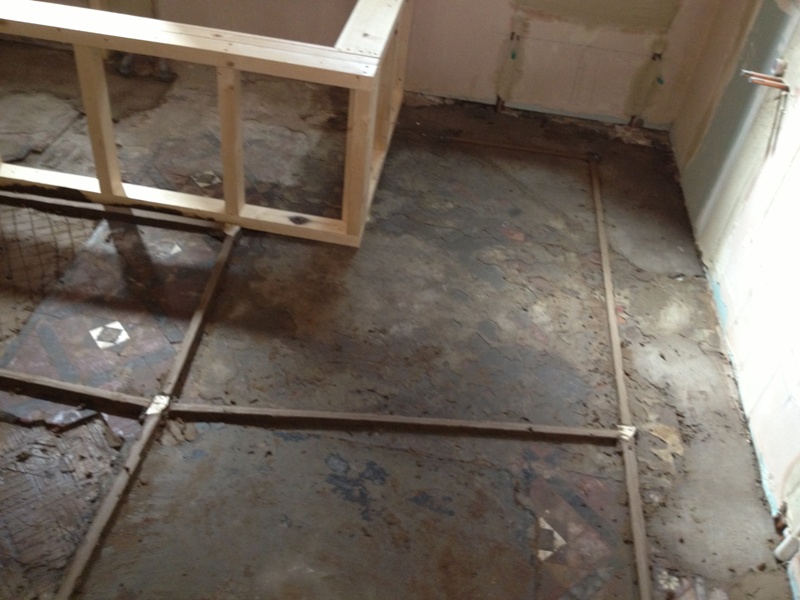

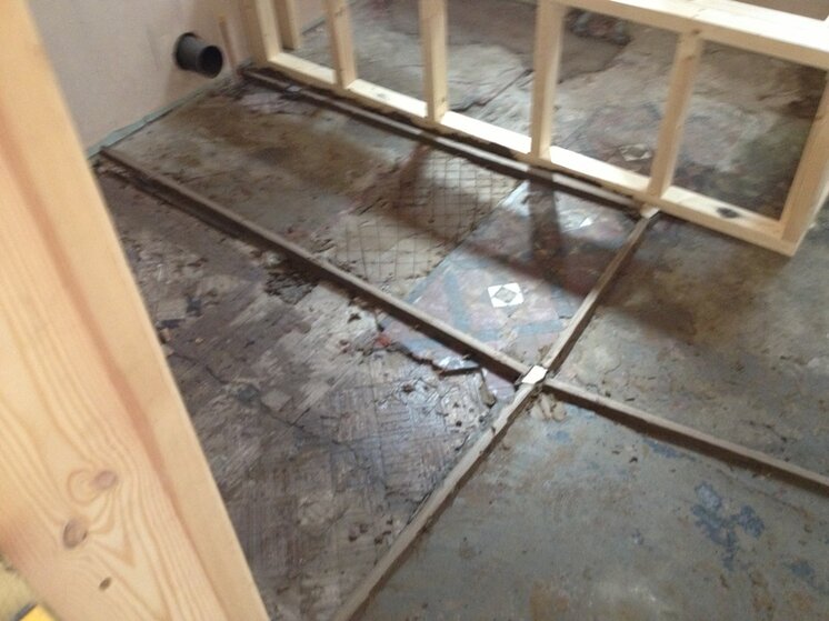

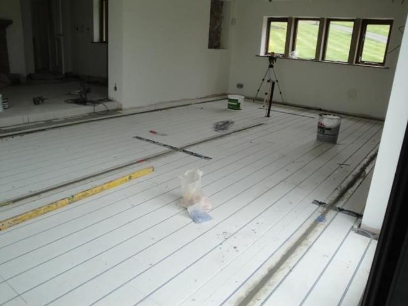

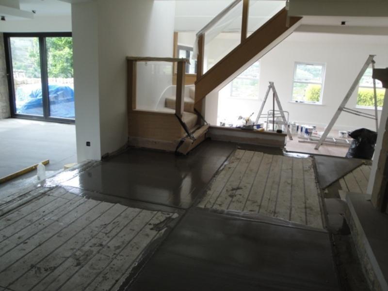

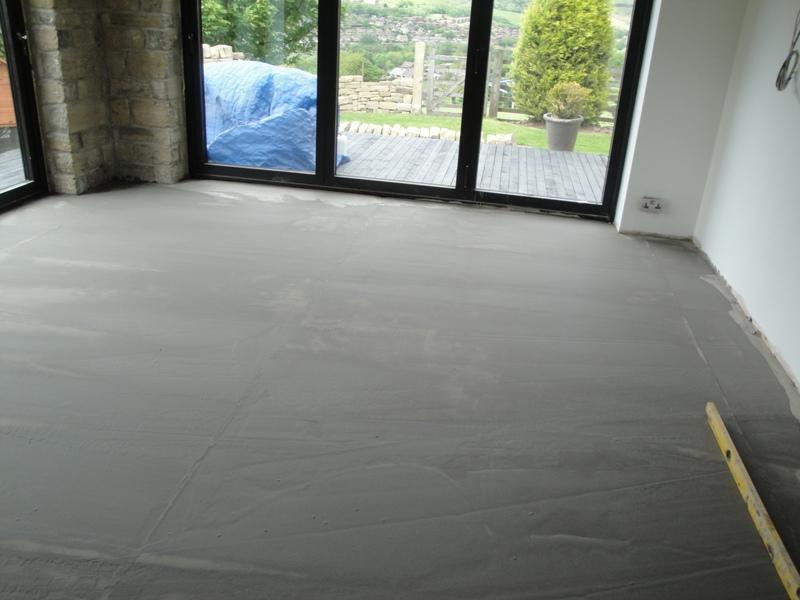

I have posted this type of slc method before, just thought I would repeat it if I have got the pics right, dots set by laser runners made from 3-1 compo plus polymer and rapid set adhesive.
The Legend; Phil Hobson RIP
Cheers Doug, my way of forming the bays is to set dots with laser to FFL less tile and adhesive, so dots are the bed, I then fill in between the dots using 3-1 compo with the rapid set and polymers, these runners once gone off can be flooded with slc forming perfectly flat bays/floors,
One tip for anyone trying this for the 1st time, when your dots have set lay the compo in between the dots, then use a Stabila level to form a nice runner, (always wet the level) cut off the excess compo from the sides and slide the level off leaving a nice neat runner.
Once the runner or screed has set you can flood the bay with slc and fill with the help of a feather edge. hope this makes sense, and maybe helps someone.:thumbsup:
