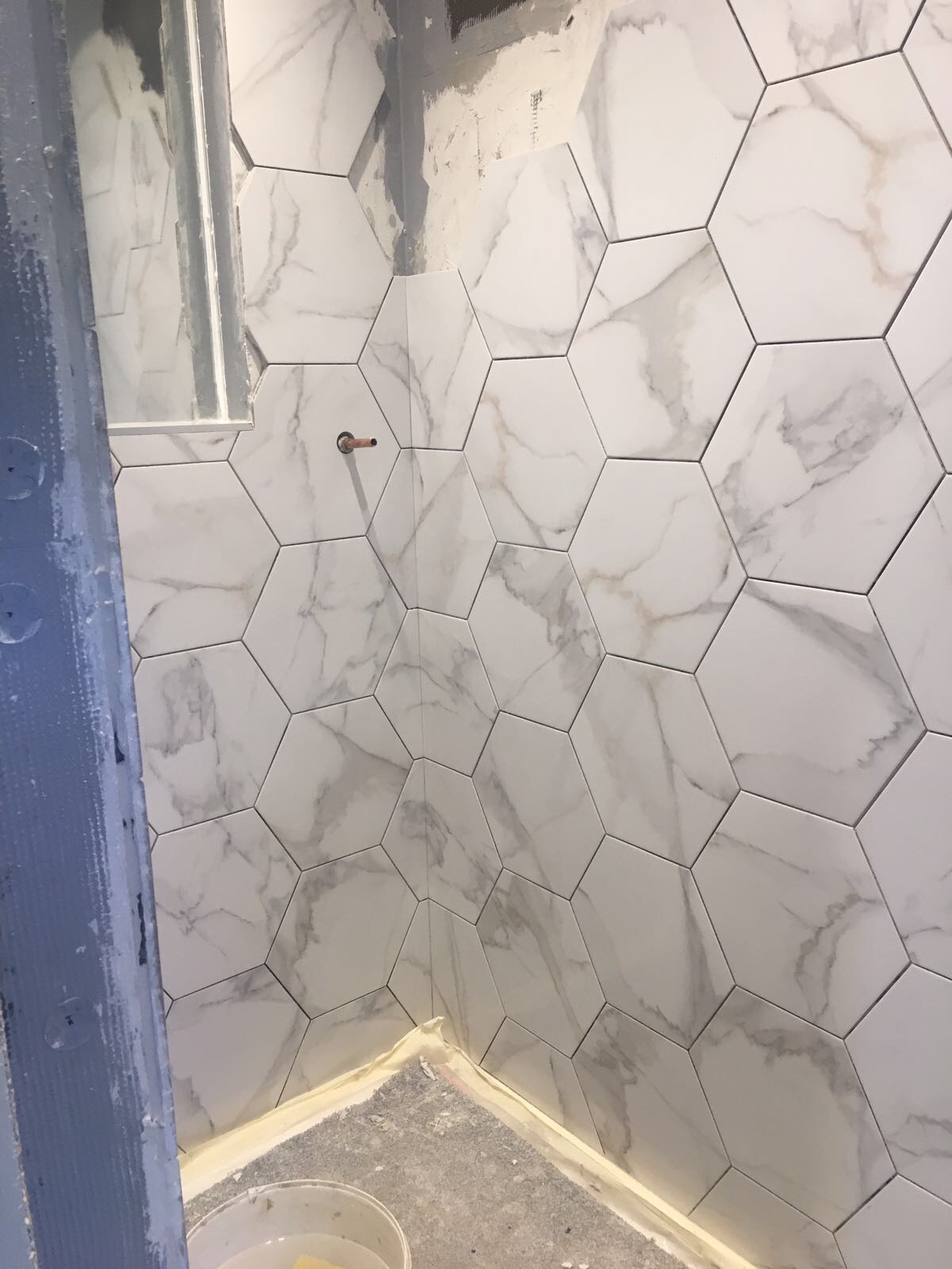

Not really the right forum but has anybody fitted vario pro to walls .
I fixed up membrane today and going to cable tomorrow .

Had a quick look today but couldn't find in booklet where they said it was suitable
But customer told me she was sold it for this purpose so called vario pro (vp) who emailed me some fitting instructions for the wall .
You have to use separate cable for the wall as you are meant to keep vp cable 60 mm from the edge of surface be it a wall or floor and also they don't like the tight radius turn it would have to do between wall and floor .
