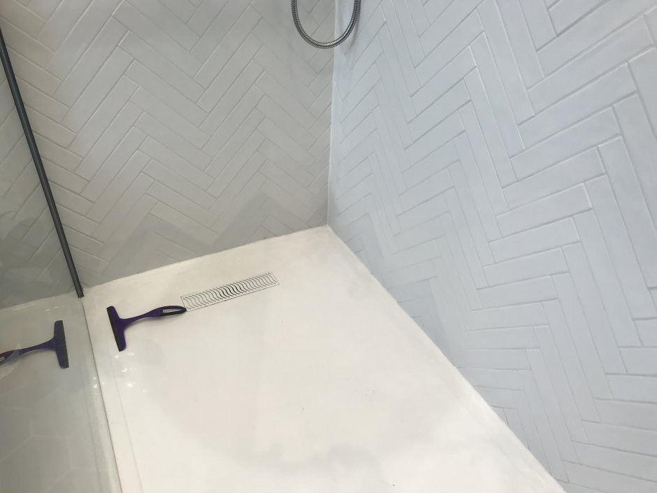

Hi all. Back end of last year we had a new bathroom installed with a walk in shower. About 6 weeks ago we noticed the bottom tiles around the shower tray were looking a bit off colour. It seems they have absorbed some water somehow. I have attached a pic so you can see. We decided to leave the shower alone and use the bath instead in the hope the tiles would dry out and turn white again after not too long. 6 weeks on and they are definitely better, but still not totally back to how they were originally. I’m going to get back to the bathroom company that fitted everything and ask them to rectify the situation but obviously as we have been in lockdown this hasn’t been possible yet. Anyway, they weren’t the most helpful / competent in the first place so would like some more opinions as to what the problem may be before contacting them. I have attached a photo from when we first noticed the problem. Any ideas as to what may be going on would be greatly appreciated!

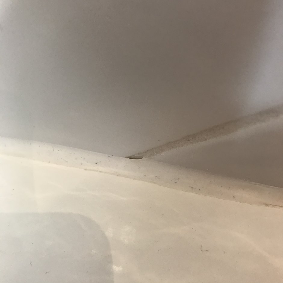

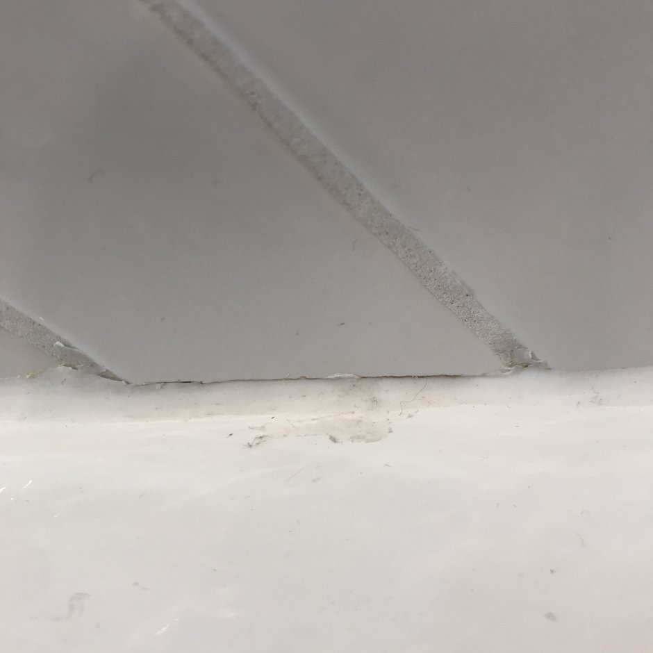

Hi Tony, thanks for getting back to me. I can’t see any major voids no, but there are a few little pockets I would say. I have attached some more pictures. The first is a small hole in the grout. Second picture is where the sealant has come away from the grout (this has happened in a fair few places). Third picture is where it looks like one tile has been cut a little small and the edge of the cut is right along the line of the sealant - doesn’t look like the sealant actually overlaps the tile properly here. I wonder if any/all of these could be the issue?
Also as it has been 6 weeks now and the tiles are still a little off colour, it makes me concerned that the wall behind is wet. I did request for the walls to be properly tanked but I have suspicions that it wasn’t as they seemed reluctant and I didn’t see them tank it.

It would be my first suspicion, especially the last image of where it doesn't meet the tile. Deeping on the location of that it will definitely be letting some water in. You could try stripping back the silicone to help air it out as it needs re done anyway
