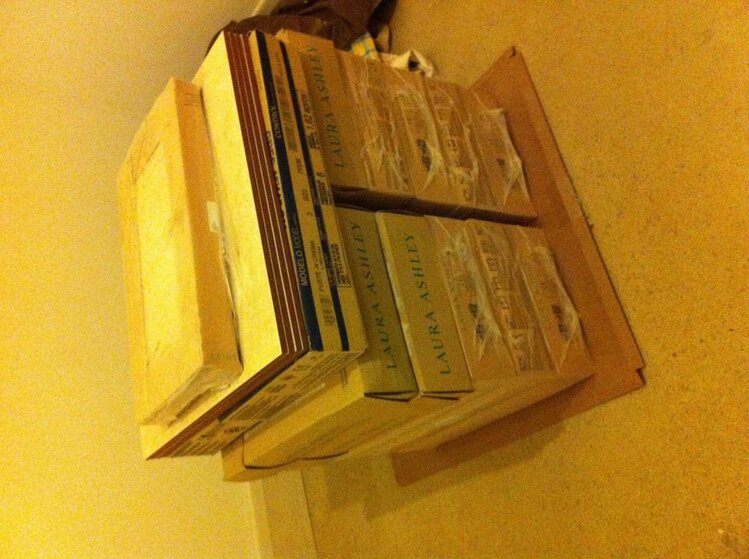

These show the stack of tiles awaiting fixing (more in a mo)

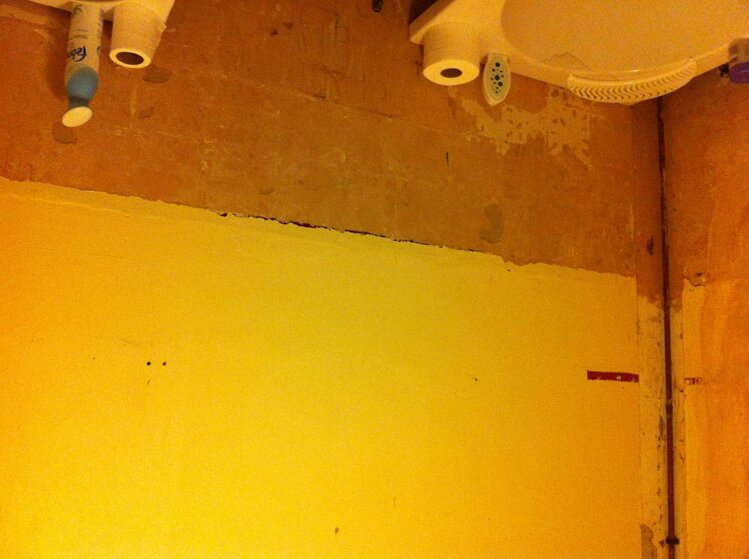

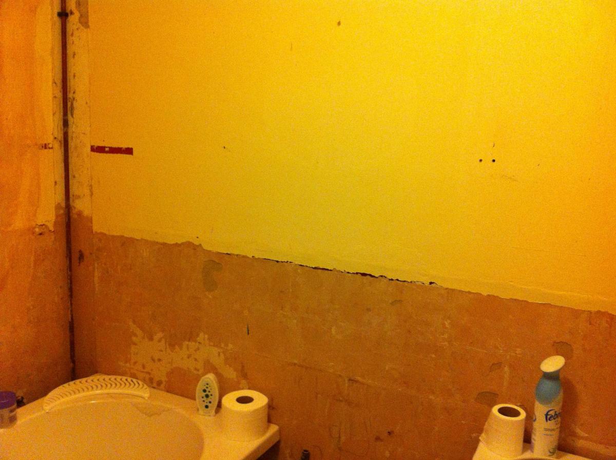

The left and centre walls of the room, and then the right hand wall.

The tiles are the Laura Ashley Canbridge range, mosiac (pressed) for the centre wall and plain for the sides. These are ceramic ~400 x ~250mm
There are also some 450x450mm floor tiles on the pile.
You'll see from the picture that there is a copper pipe in the corner, my aim is to use some of the mosiac on a 45deg angle across this to avoid having a step/box arrangement. I'll do this by fixing a wooden panel up the length of the wall. To keep the symmetry of the room/bath I'll do the same on the other end of the central wall which goes along the length of the bath.

- the wall above the bath has a square of fresh plaster where there used to be a window - should i prime or otherwise prepare this?
