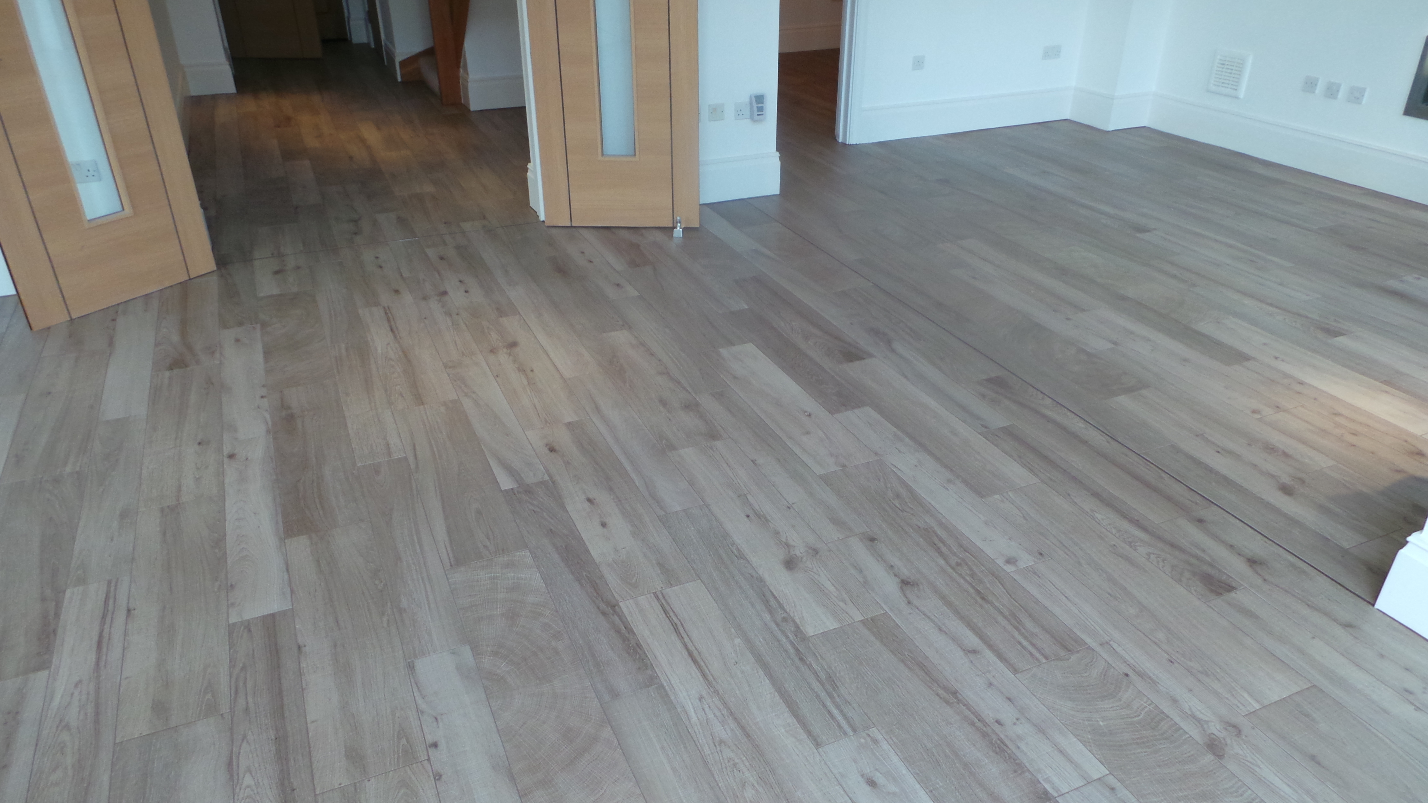

270m2 ground floor house. anhydrite screed. few cracks appearing now in screed as UFH has been turned on (even thou the laitance hasn't been took off yet, thats another story)
tiles being used are 22.5x85 wood planks.
having just costed the expansion strips and matting, customer isnt happy with extra costs......
so what to do? No decoupler and use expansion strips? Or decouple and no expansion strips?
