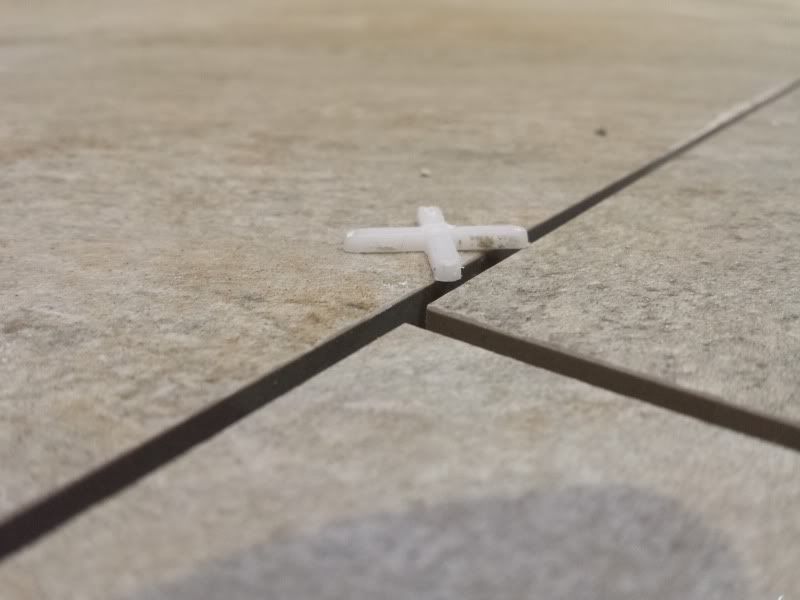

One thing I have struggled with is the fact that the tiles weren't perfectly flat. They were close, but sometimes out as much as 1mm from end to end. This meant (and stupidly I didn't check till I'd started) I have inevitable lips of 0.5mm in places. (I'm not sure what acceptable and what isn't, But perfectly flat is surely desirable) I only used 3mm spacers as well because I didn't want huge grout lines. Nobody seems to notice but me, and you can't feel it too much under foot. I rotated and hand picked the best tiles for heavy traffic area's.

Yes mate make a tiled skirting ,you could even ,bullnose it. 0.05 lippage !! that sounds good for a newbie !! lol
I'm just guessing. Its probably a mm in places. Certainly no more though. I'll take some pictures shortly, It isn't grouted yet.

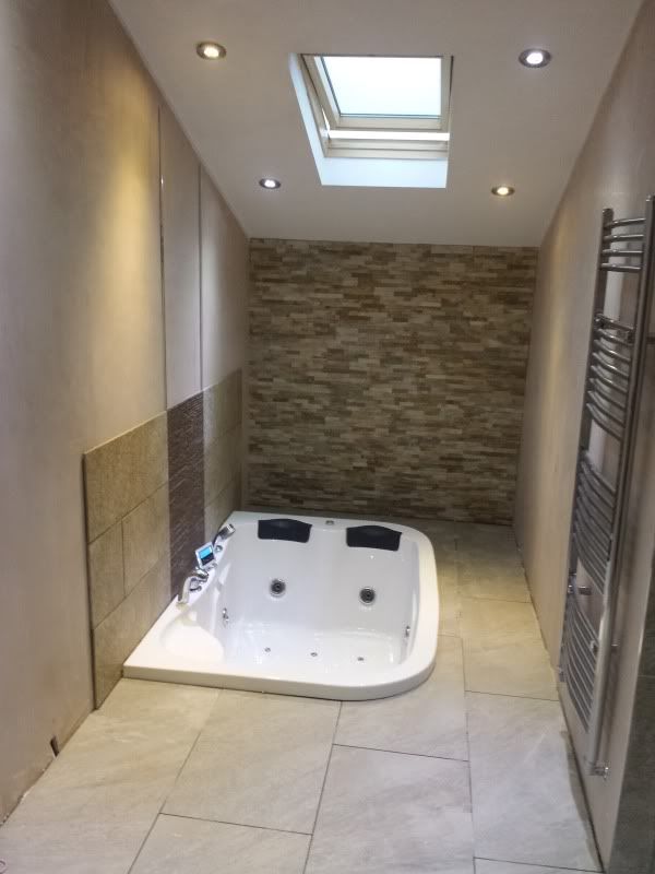

Here are the pictures. Let me know good or bad anything. Obviously the wall tiles are yet to have the trims installed and the trims need cutting down. It's staying just 3 tiles high behind the bath.
This is one of the worst steps. However the Camera plays a trick. Believe it or not the 3mm spacers is on the lowest tile. It looks to be higher on the picture.

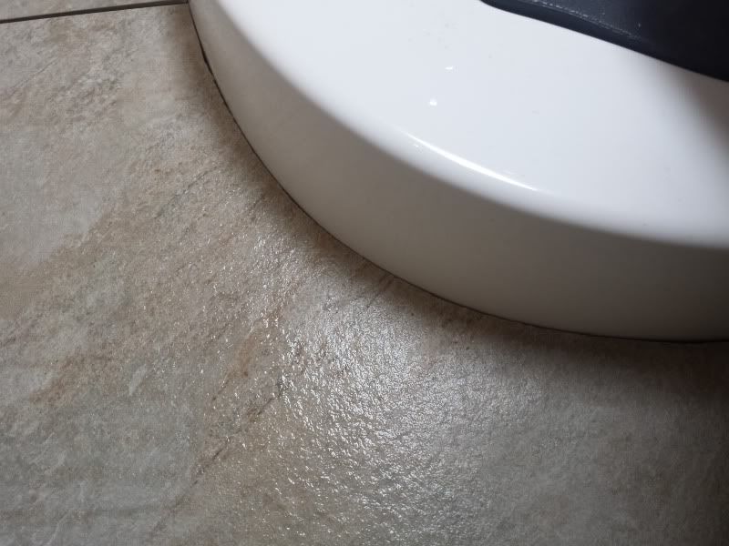

I did this with a dry cutting disc in the 115mm grinder.
Heres a couple more.

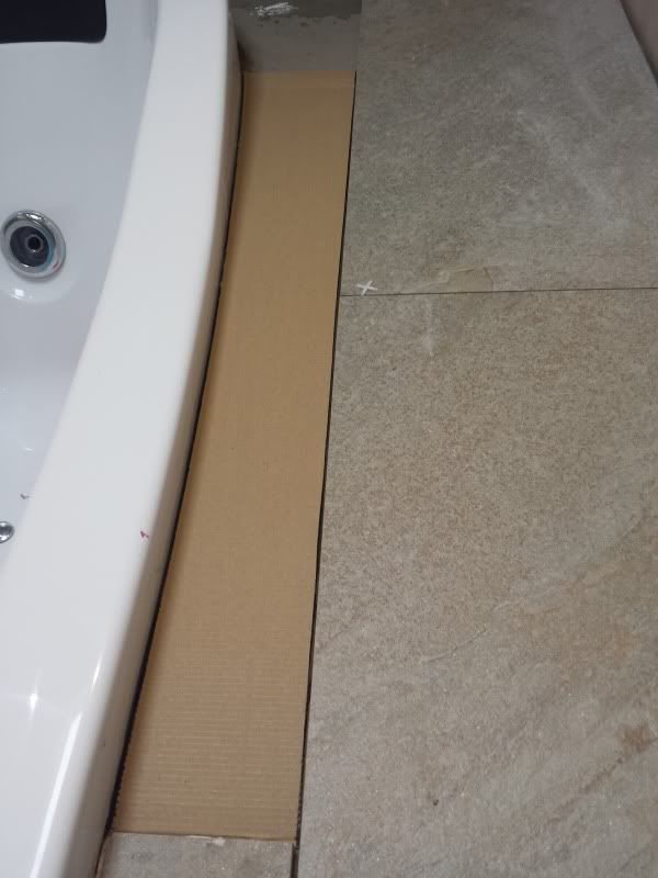

I made cardboard templates for the awkward cuts

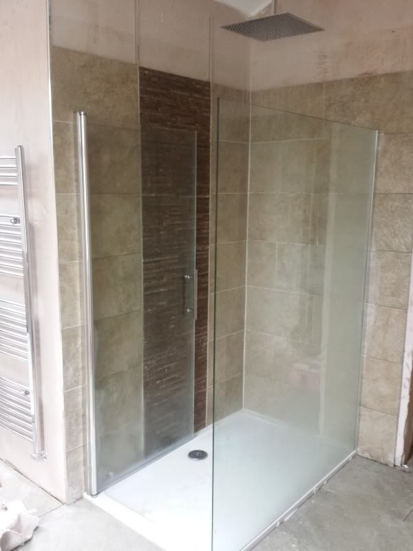

The shower area, there are another 2 shower heads to fit, one the same as the one pictured plus another "normal" one. Both are remote control which need mounting.
