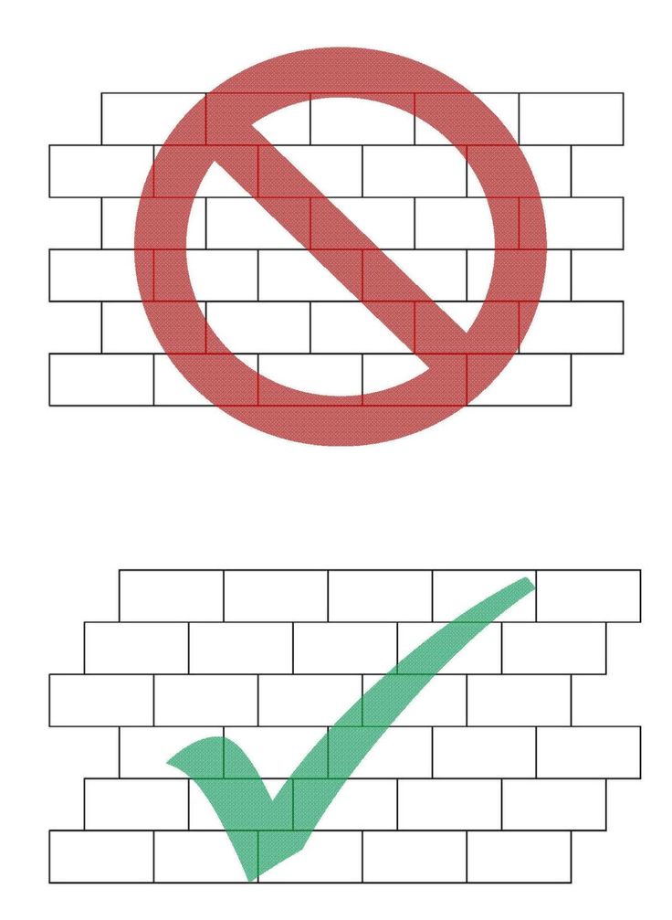

In my humble opinion even if you find the same tile and the tile is curved you will have the same problem .
Even if you get a good tiler e only can minimize the lippage, i think the best pattern for curved tiles is this one.
So... my opinion is to replace all the floor or your choice number 3 only if the tiles are curved, otherwise if the tiles are okay replace only that area.

Thank you for your reply and don't worry your English is fine!
What you cant see from the photo is the tiles then flow through into the kitchen, utility and downstairs shower room (hence the tiles being oriantated in that direction) so re laying in that pattern (which I now realise is correct) wouldnt really work.
