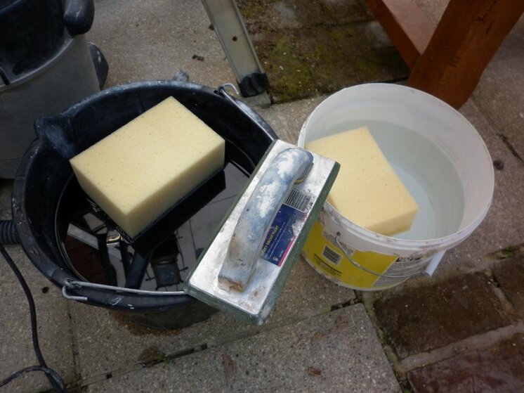

FBridge,draycotts 024.jpg The epoxy and emulsifying pads
FBridge,draycotts 026.jpg Plenty of clean water

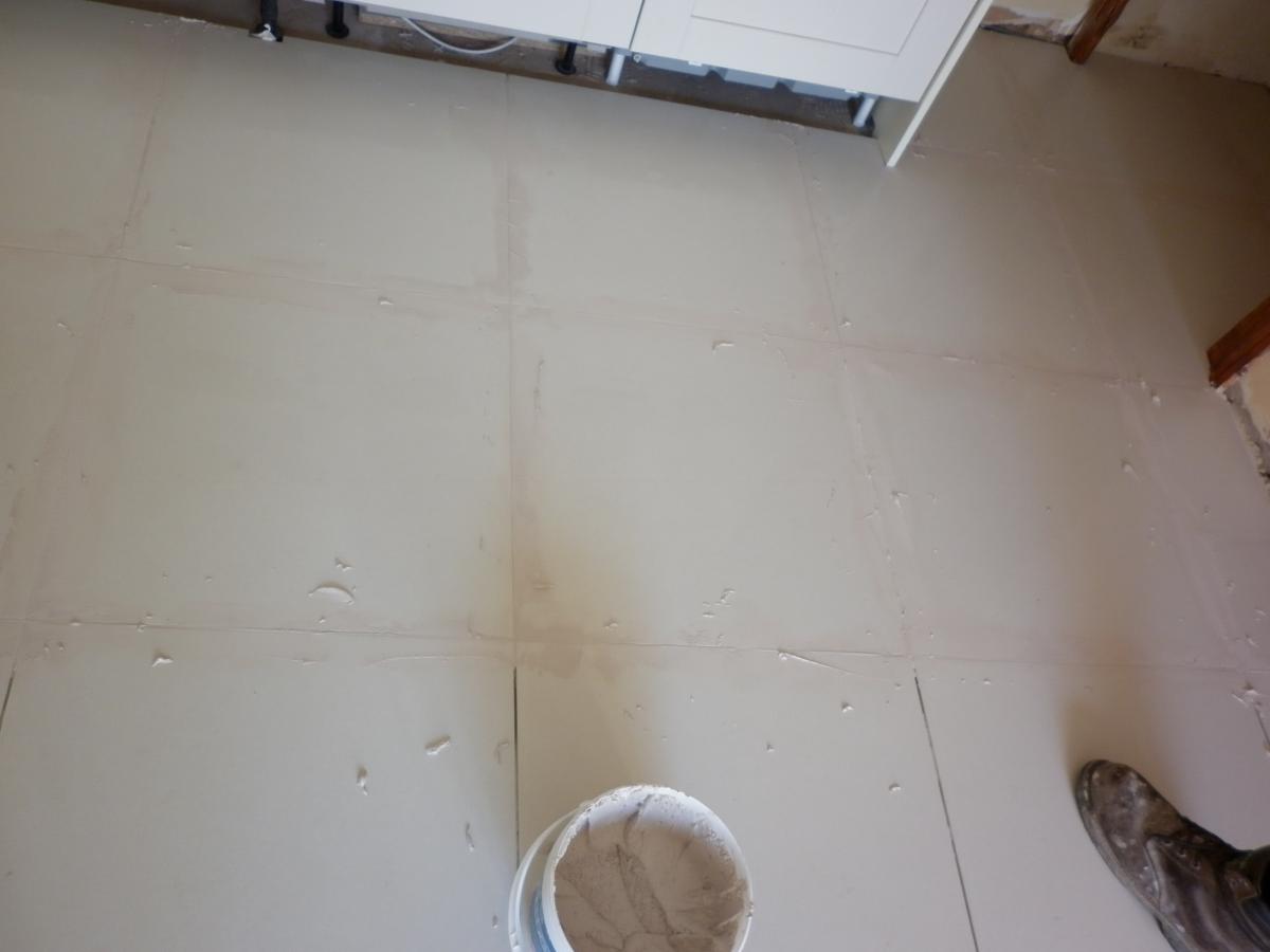

FBridge,draycotts 017.jpg The clean floor before grouting

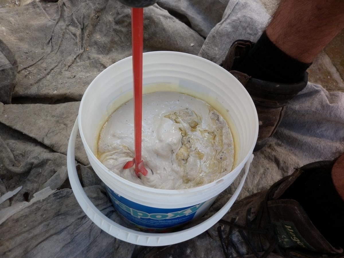

FBridge,draycotts 028.jpg You must mix ALL of part A and ALL of part B together
FBridge,draycotts 030.jpg It is best to mix the two components with a electric paddle mixer set at a low speed. Make sure that it is really well mixed.

FBridge,draycotts 034.jpg Use the emulsifying pads with plenty of clean water in small circles to looses the grout on the face of the tile. At this stage I dont worry to much about the joints themselves, I just make sure that I emulsify and break down the grout on the surface of the tile. You can see that after this stage, it leaves a "milky" residue on the tile.
FBridge,draycotts 037.jpg Now you can start removing the "milky" residue with clean sponges and clean water. You can also start to dress the joints but be careful that you do not mark them as the grout should still be soft

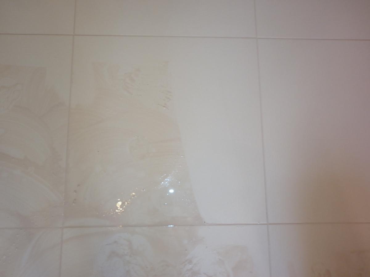

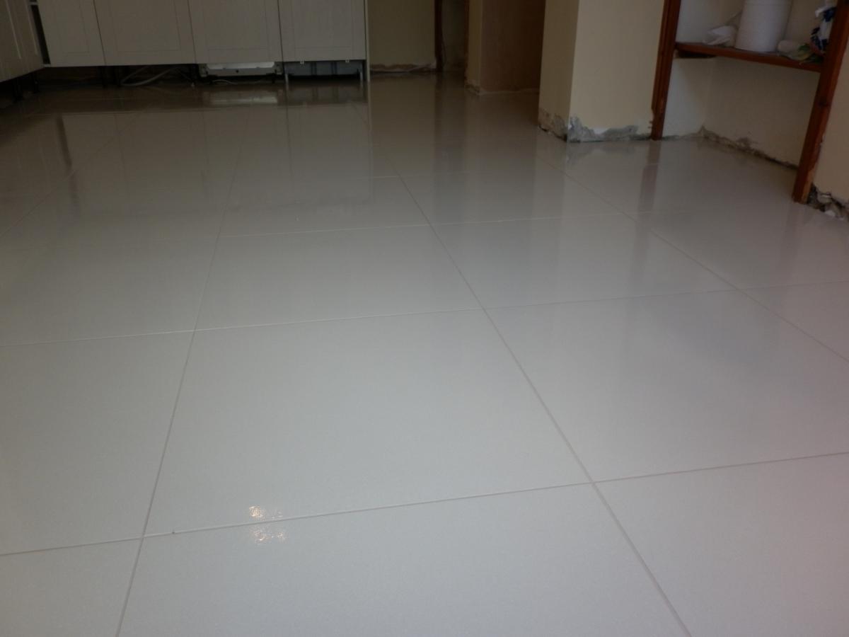

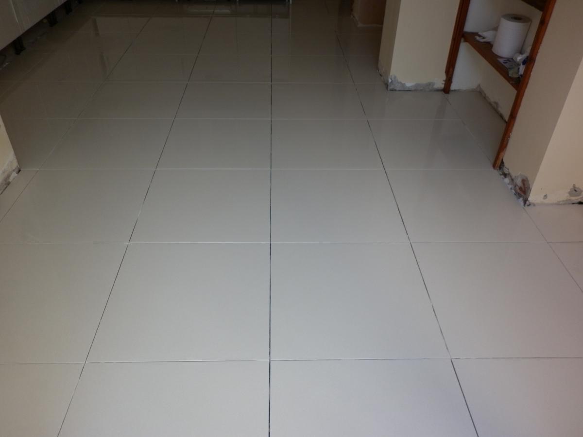

FBridge,draycotts 039.jpg After the first wash off with the sponge you can relax. I like to leave the grout for about 10-15 min before the second wash. This is where a lot of people go wrong, the floor will now look finished but it is so important that you remove ALL of the residue, I tend to go over the floor about 5 times with clean water and sponge each time. If you walked away from this floor now it would be ruined.
FBridge,draycotts 040.jpg From this point on the floor will look pretty much the same after each wash. Each wash I pay more attention to the joints to get them nice and smooth. The last 2 washes I wipe the tile with one side of the sponge before washing it out, it takes a long time but this is the best way I have found to get the tiles totally clean. A wash boy is a handy tool to use here.

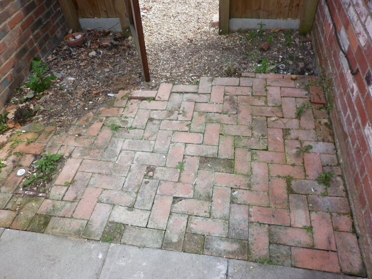

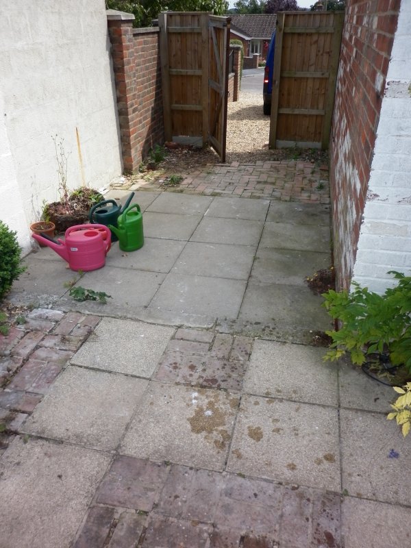

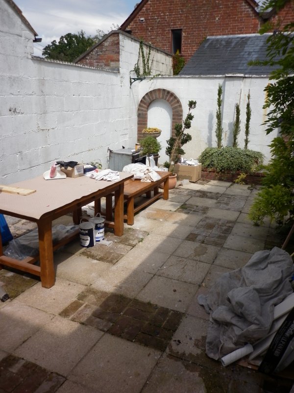

I took some pics of the outside area as well, this is going to be tiled and grouted with epoxy as well as the kitchen. I will try to remember to put up some pics of the tiling and some shots of it all finished up.

Boy, that looks seriously hard work, respect! How do you prepare all that lot then? Take it all up, what? And what about drainage and stuff? Wow...
The new slab is going to be put down in sections with expansion joints where I am going to want them in the tiles and with runs, there is going to be gravel border around the perimeter for drainage. Going to be a long while before the tiling starts but the prep is obviously going to be very important on this one. The problem is that from here on in it is all weather dependent, dont fancy tiling or using epoxy in the rain.
