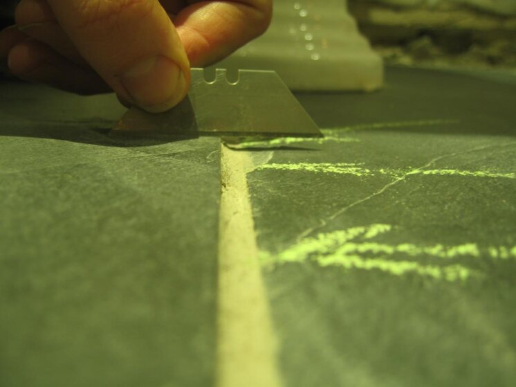

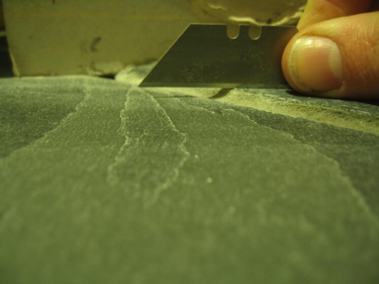

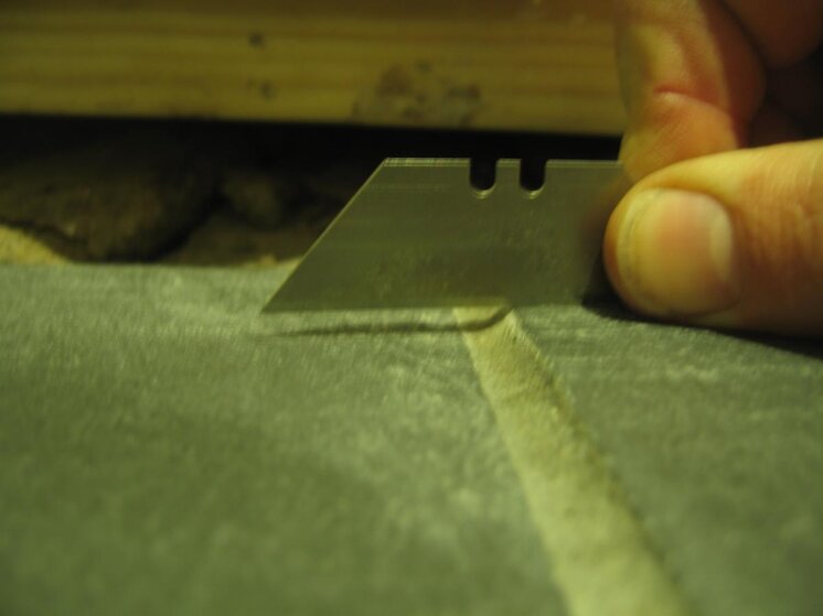

jay
Slate is a natural product and if you were expecting a mirror Finnish its not going to happen ,but the lippage you have may of been avoidable ,
question 1 Did the tiler view the slate before fixing and tell you what the quality of it is. this should of been discussed as the tiler was sorting the slate (thicknes graded bowed or twisted ones placed to one pile to be used as cuts or out of main walk areas )
the look of the job is disappointing but what was the quality of the slate
this pic shows poor quality slate bowed
The sad part is the tile shops (normally) place the better quality ones on the display (because crap is harder to sell)
Question 2
did you agree with the pattern the slate is fixed ////
