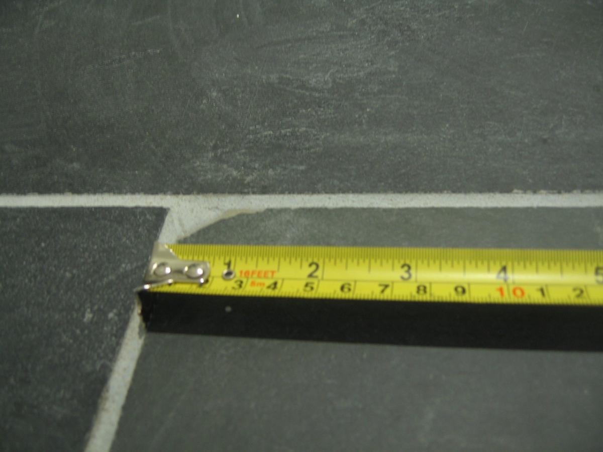

Thanks again for all your comments. They have been really helpful. Below is an update of our situation.
To recap the tiler came round and replaced some of the tiles with extreme lippage, at this time he said that with these tiles the finish we have would be as good as it can get, even if he started again therefore relaying the floor would not lead to a better finish. (And in response to Jay there was no self levelling compound laid.) Thus we went back to the shop, they said they are only responsible for supplying tiles and whilst they recommended the tiler they do not wish to get involved. However, they repeated these tiles would give us a floor which would be virtually flat (as it is a natural material it will never be totally flat due to the top layer), and they reiterated they were top quality calibrated tiles diamond cut on one side. This means there would be no trip hazards or protruding corners - which could be an issue as the bathroom will be used by young children with bare feet. As these opinions contradict (the fact that it would be virtually flat and we would always have a noticeable lippage) we insisted the shop and the tiler come round to our property to agree who is correct and the way forward. We have been promised they will be in touch on Monday and we will keep you posted.
(In response to NZ_Tiler he applied a sealant after the first visit. But when leaving after his second visit in which he did the repairs he felt necessary, said he would come again once the bath, sink etc had been plumbed in and reseal the whole floor again. I am assuming that the fact it hasn't been sealed explains the difference in grout colour between the two visits.)
As a final aside, we are attaching a picture of the original tile (the corner in question is the one immediately to the left of the triangular tile and by the corner with the arrows pointing to it) and that which replaced it. There seems to be a corner missing (the pen is to give an idea of scale) and we don't know whether or not to raise this as an issue, it doesn't look good to us, but we aren't tilers.
View attachment 38603View attachment 38604

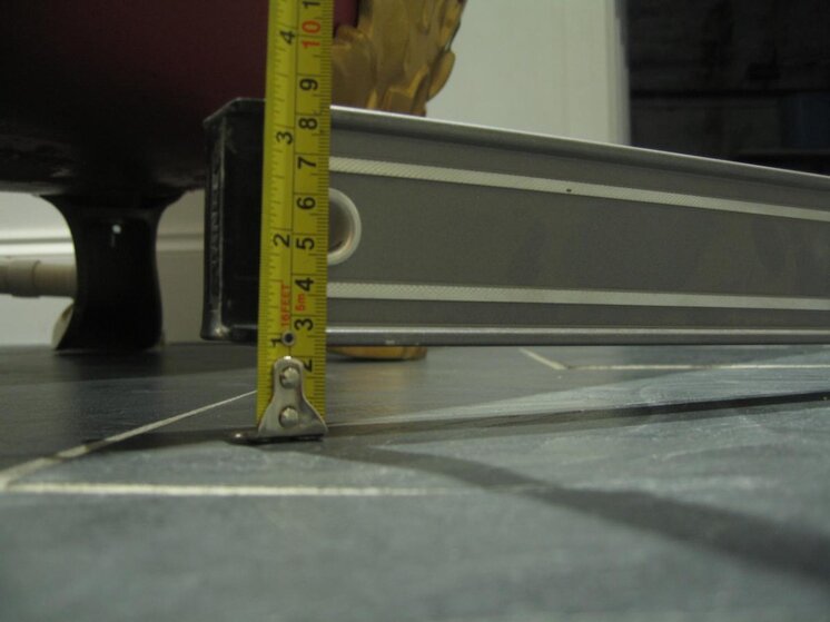

Slope, spirit level on floor other end.jpgFull shot showing spirit level and slope.jpgChipped corner (replacement tile).jpg
Looks like its raised to level as the floor is sloping.
Can you take a pic with the spirit level across the floor to show any lip page.

so you say the floor was spirit level flat and also level perfectly before any tiling took place and now its out by 25mm on the length of a standard level?

As Oli says, I would like to see a pic of the level laid across the floor if possible to see how flat the floor is.

not a chance in hell that that floor was bob on level,no way can you get that floor that far out of level with tiling it,he would of used a ton of addy.

We are not tying for a perfect floor and have never said that, merely a reasonably laid one and judging by the response of many to this thread, then the standard is not what one would reasonably expect. The shop has told us several times that for this quality of tile there should be no lippage yet they were not willing to come around and offer any opinion or advice, despite the fact that they put the tilers name to us. The tiler on the other hand advised that based on the quality of the tiles, this is as good as it gets. So Andy, based on this how would you proceed? They can't both be correct......
Wilder, this is the point, it is out by this amount.
Hi Wilder
This is the point, it is out by this amount, along the line where underfloor heating covers part of the floor and not the other part. Just to clarify, we put the level on the floor and then put a weight on the far side, so this is how it is - If I had not put the weight on it then it would have been out but by the same amount but at the other end near the wall, but it is difficult to photo this way. - However, happy to take other photos and will do so shortly.
So again, is this an acceptable amount for a floor to be out?

No, if that is how far the floor is out then no that is not exportable IMO. The prep work should have been carried out before the tiles went down. It is just hard to work out what is what without actually looking at the job.

i take it your level in the photo isn't level, you've just placed it on the floor pushing down on the level at one end showing a bow in the floor?

hi ,i think a few more pictures may help everyone give you more advice....as already requested some shots of the spirit sitting on the tiles and also what the tiling is like at door thresholds and skirts........currenty you have a level starting at one end of the room sitting flat on tiles and your lifting it till its bubble flat making it over 20mm out and seems to be still rising?
just my opinion but are you sure you didnt have a FLAT floor to begin with but in reality it wasnt level
i cant see how the floor rises by that amount and then falls away by that amount
or the other option would be it rises by that amount and keeps rising giving you what a floor that 3 inches out on the other end?
