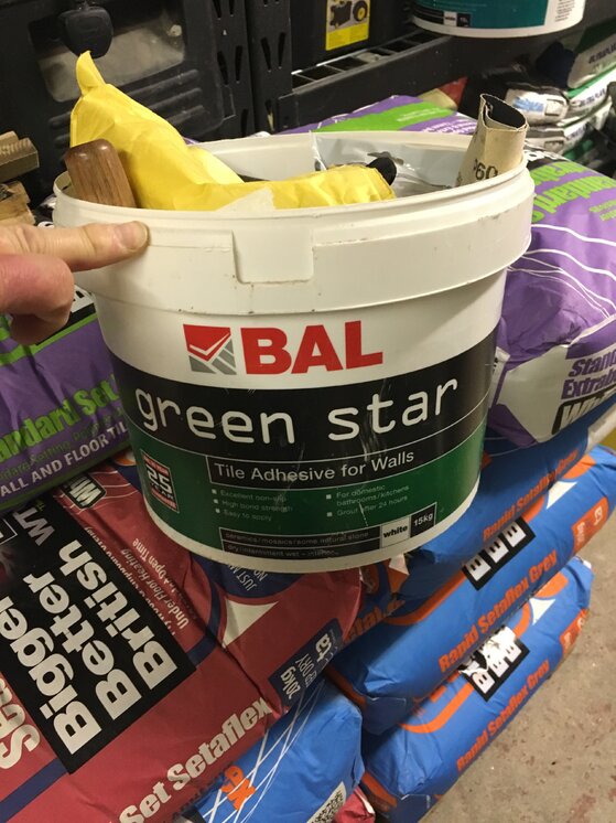

BAL GreenStar tub & what it states on the back, show this to the kitchen fitter, he might learn something.
Nothing wrong with tubbed addy as long as it's used to the guidelines.
Regarding tub addy that is.......still lost with regards to British standards on tiling onto gypsum screeds :nomouth:
