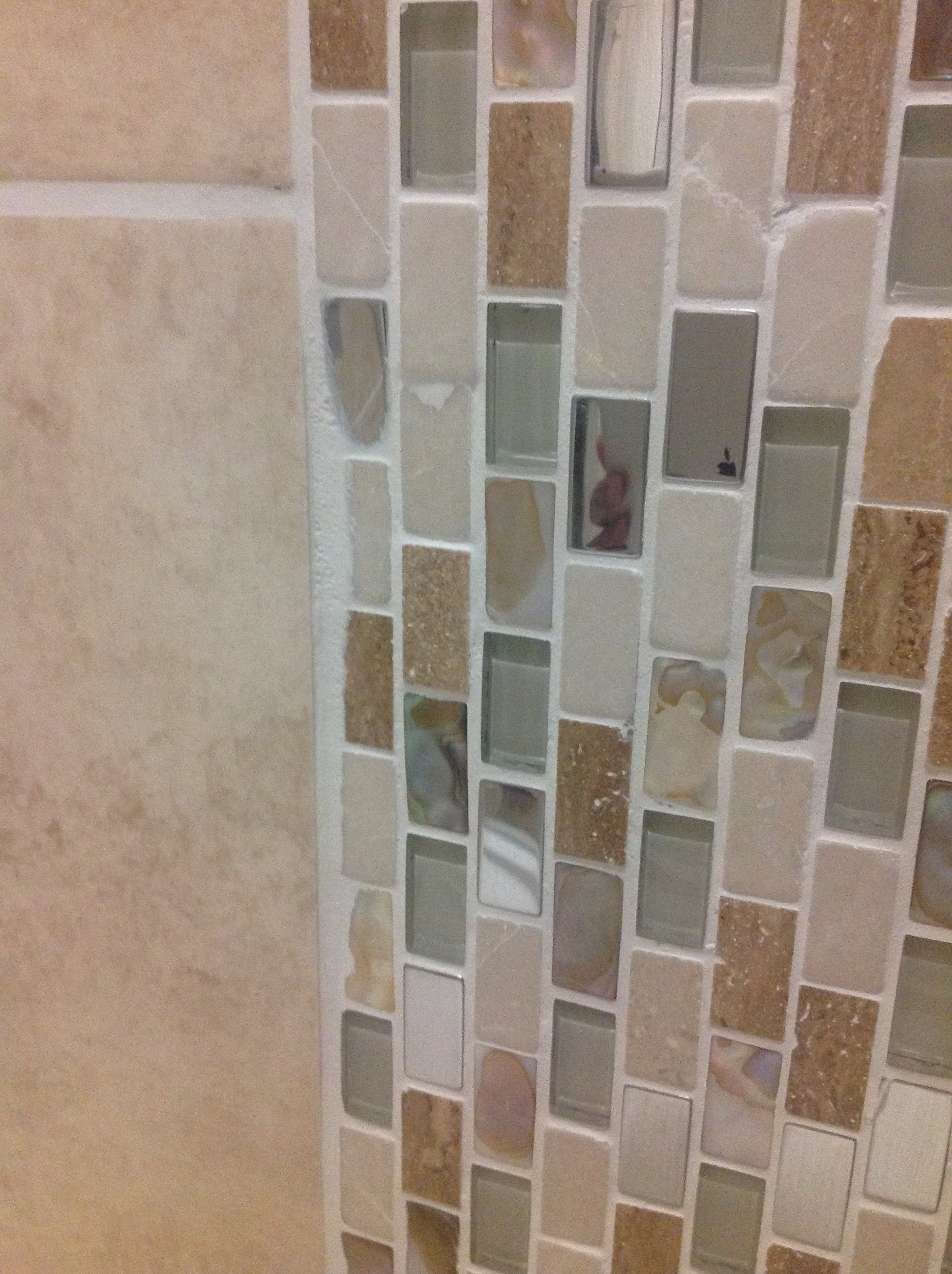

I guess this hits on two counts. Some of the mosaics are right next to each other without any room for grout as he hasn't spaced some properly and also dot and dab expressly mentioned is fantastic !
Yes I guess it will but the amount of stress within a couple of line of mosaic would not have an impact. Its just a lack of attention to detail on the tilers part. The dot and dab is a good change. Before they only recommended methods to use with no mention of what methods not to use.
