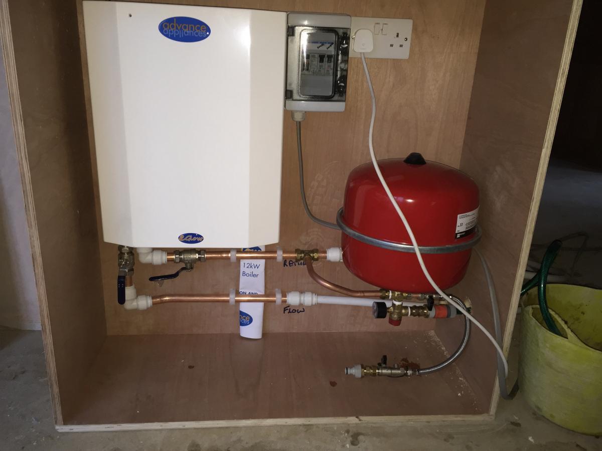

i have made this now to dry our screeds if the boiler can't be commissioned in time for tiling. Can be connected to manifold.
