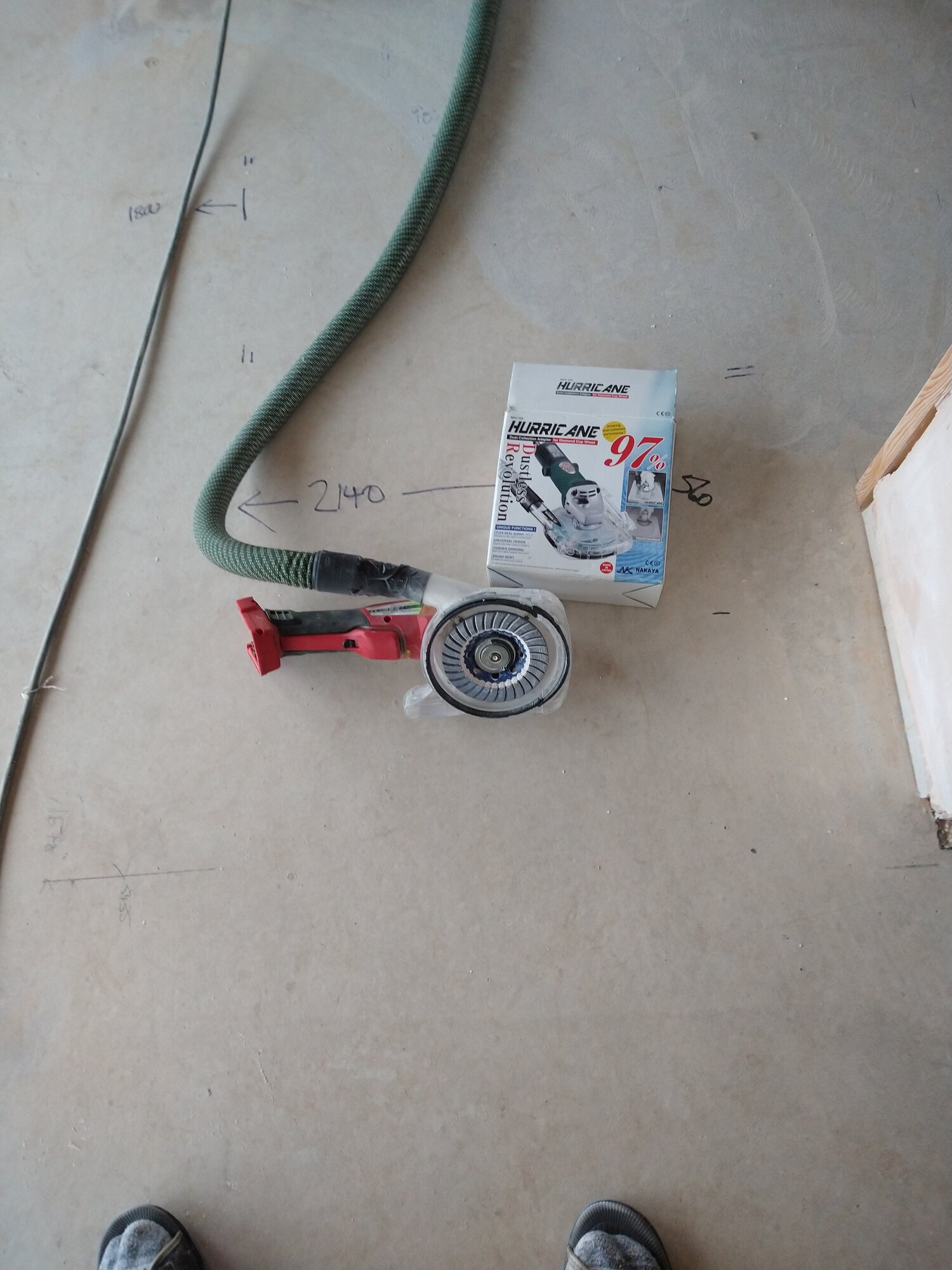

In case it may help someone I ended up using a grinding cup on a 4" grinder attached to hoover via a dust collector. I had forgotten I had these. Took no time at all just a matter of keeping the grinder level & moving at steady speed - backwards & forwards easier to control the grind that arcing from side to side.
