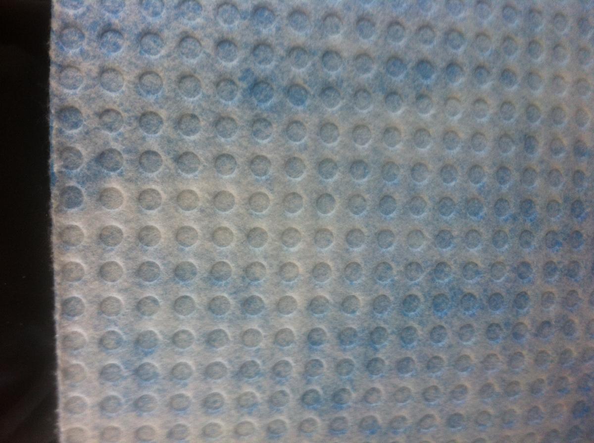

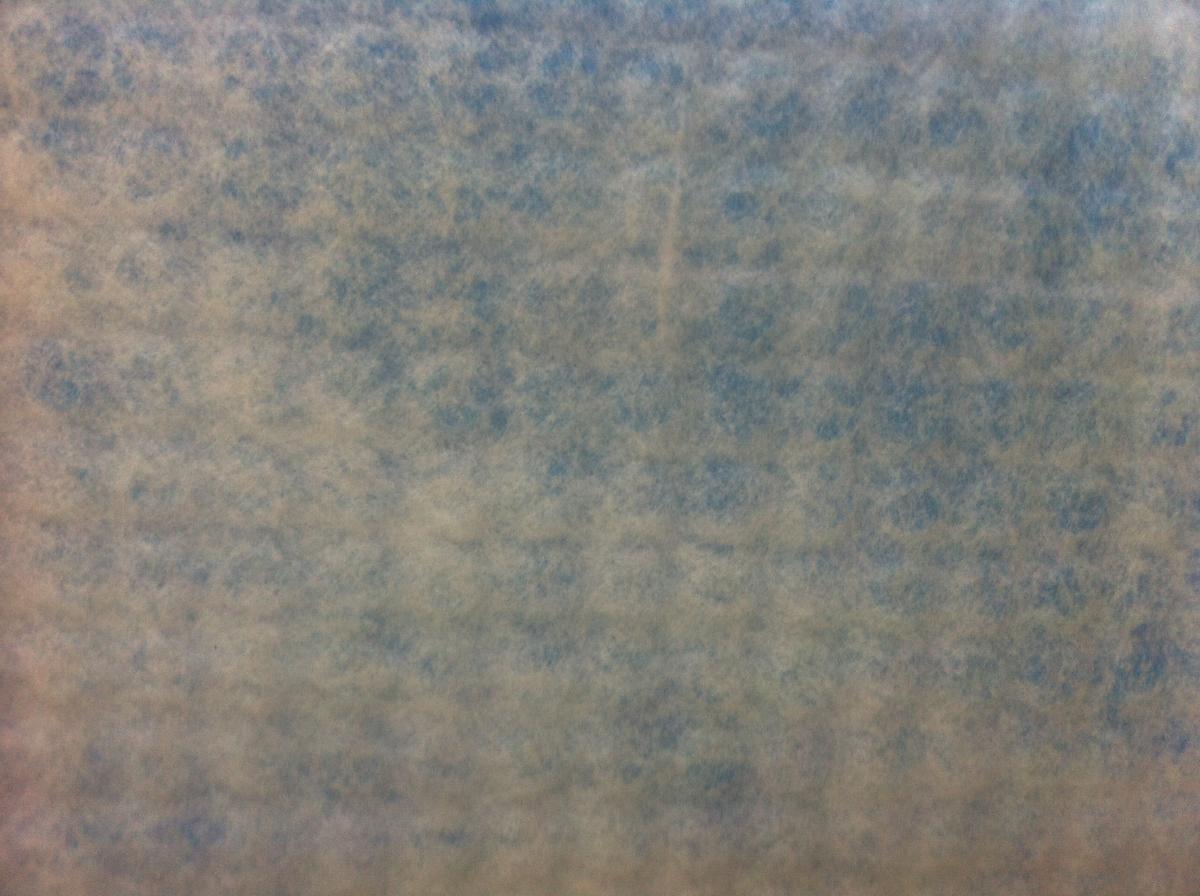

I've never used this type of matting before it
Has to felt sides and one blue plastic inner core
This is a holiday home am tiling and the clients won't be here for weeks so I've no idea who supplied it or what brand it is, any ideas?
wierd , looks like the dural one but with felt on the tiling side given we can see the depressions so assume that is the top?
Stick to felt ? wouldnt that hinder the adhesive mechanically locking into the depressions?
Looks almost like its a duff batch where the underside ( felt ) has stuck to the face when rolled up?
Never seen it before .
Diggy
The Legend; Phil Hobson RIP
Blanke, Genesis,Concept, they are all the same, not tried and tested. Stick to Ditra or the new Dural mat. Imho:thumbsup: Mr tiler please read the many posts on decoupling membranes, I understand you want to learn, but this stuff is really basic. Not wanting to be unkind, but you need to understand the technical side of tiling if you are going to be a tiler.:thumbsup: Good luck.
