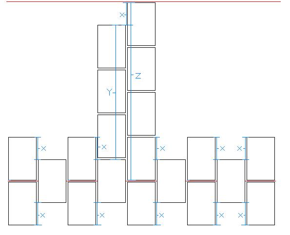

A tip would be to use a measurement tape or a folding ruler.
I made a picture to illustrate. Measure the x, y, z and use those as guide numbers. That way, you only need to measure every few tiles per column. The longer the distance, the smaller the margin of error becomes. Also, make a new datum line with your spirit level about a quarter up and down the wall.
Works perfectly well around windows and doors as well.
