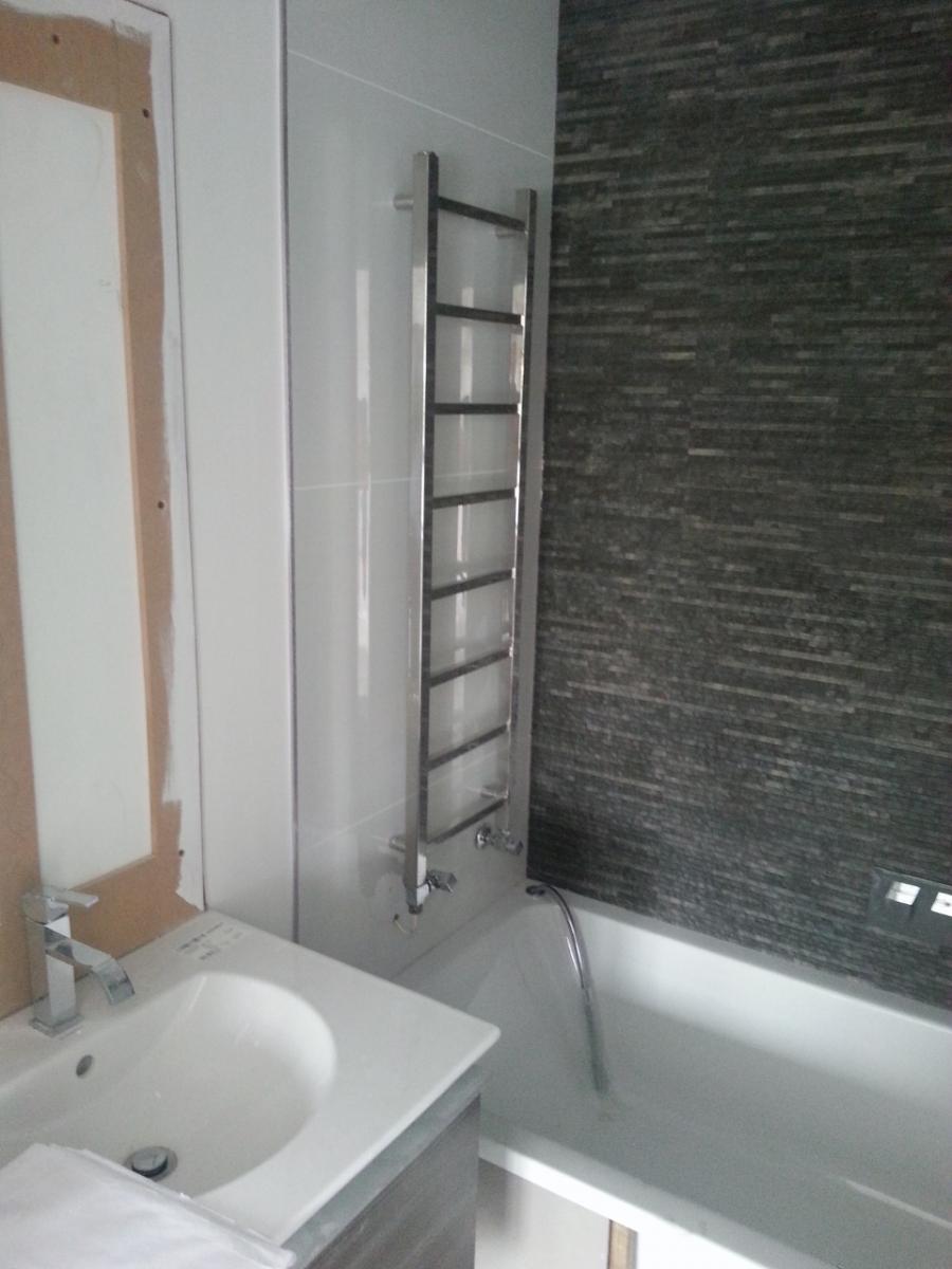

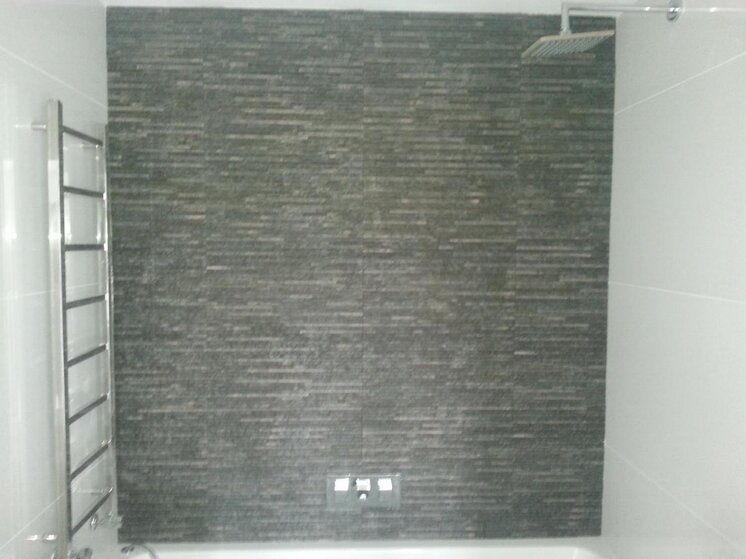

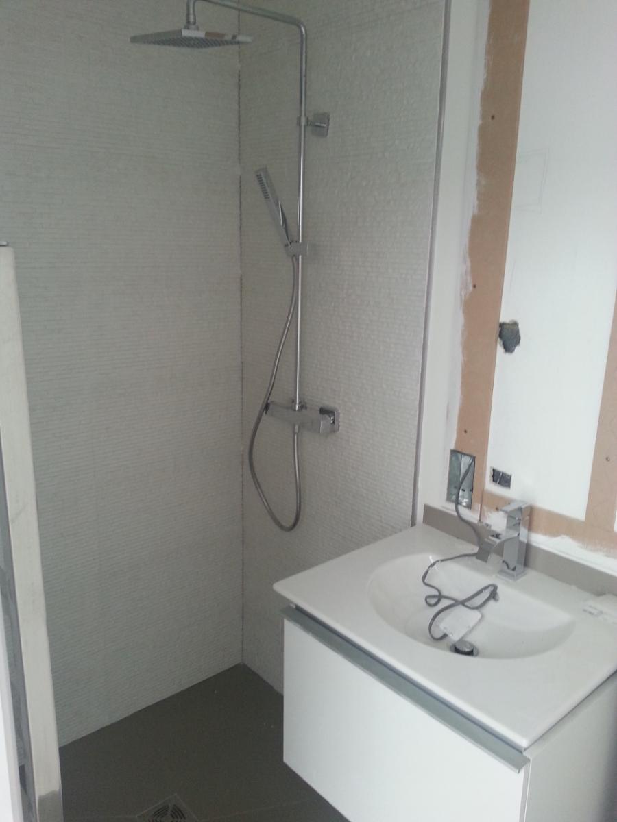

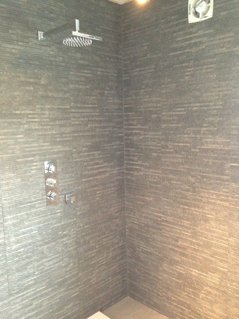

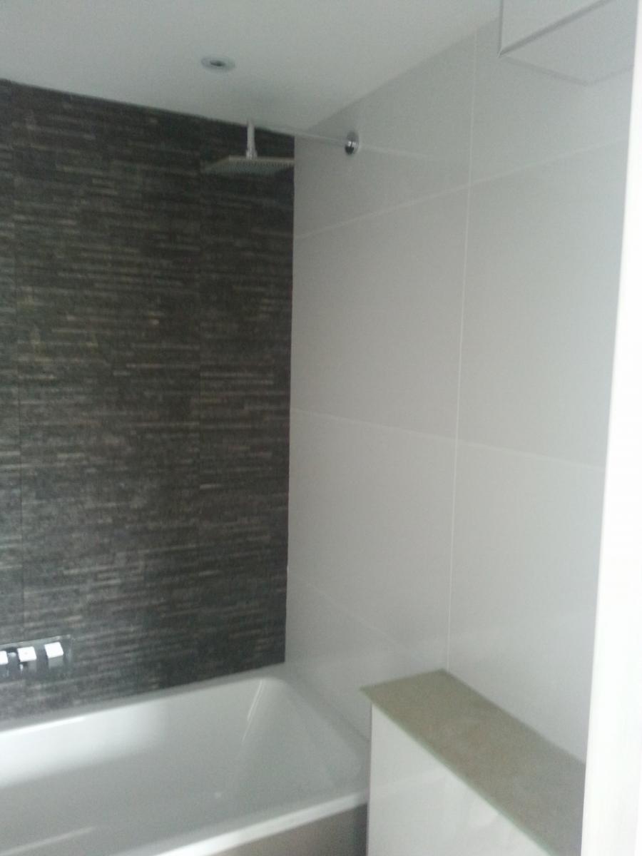

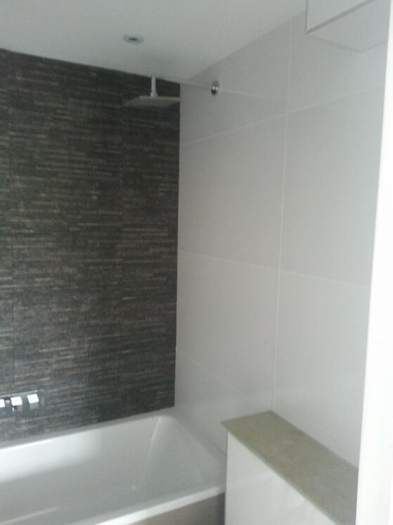

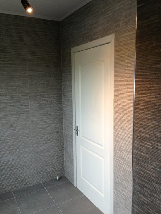

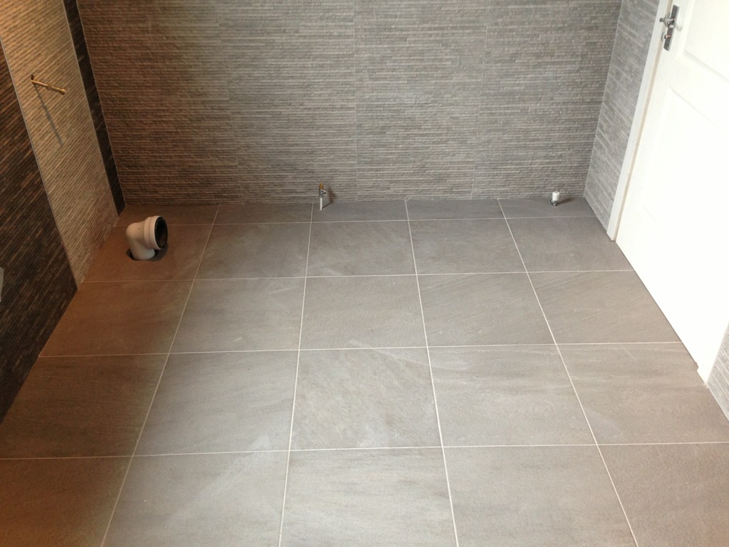

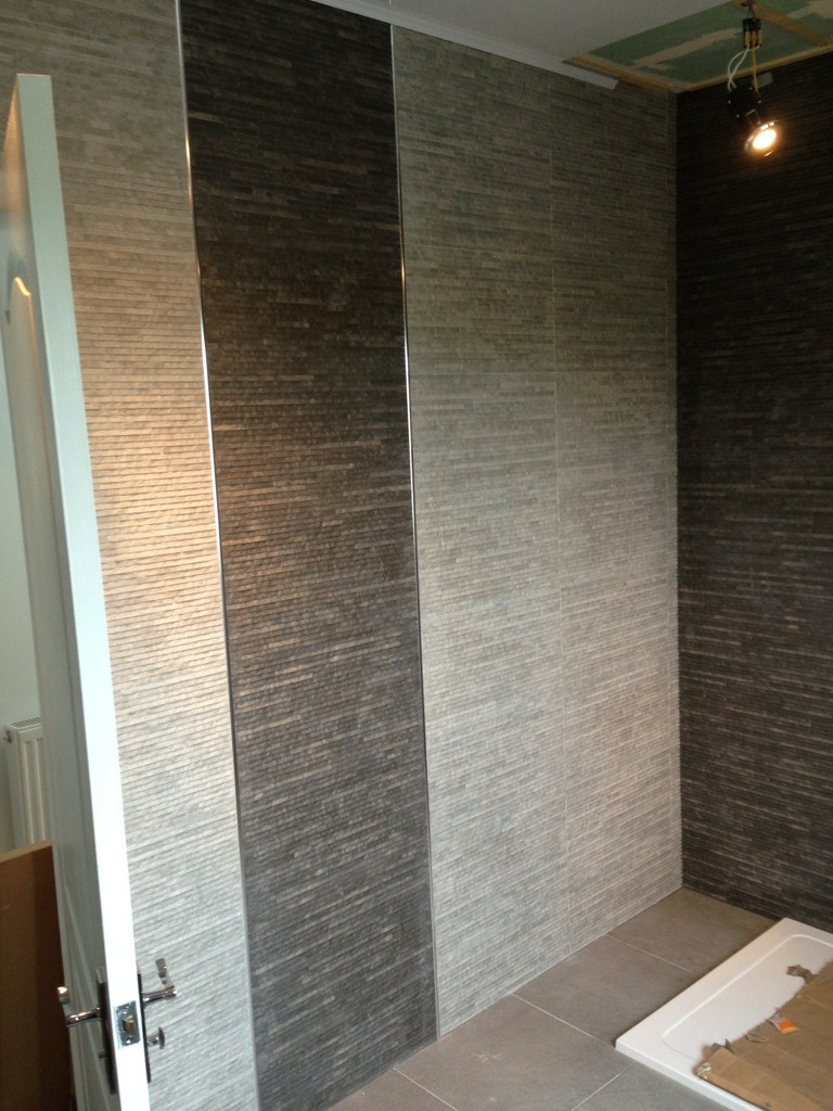

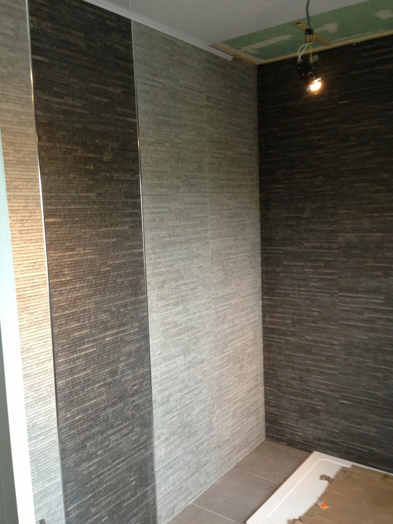

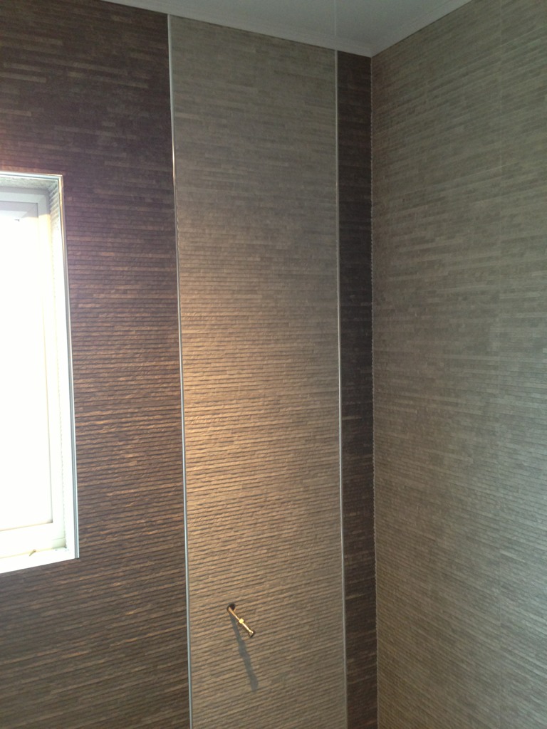

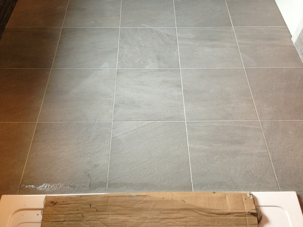

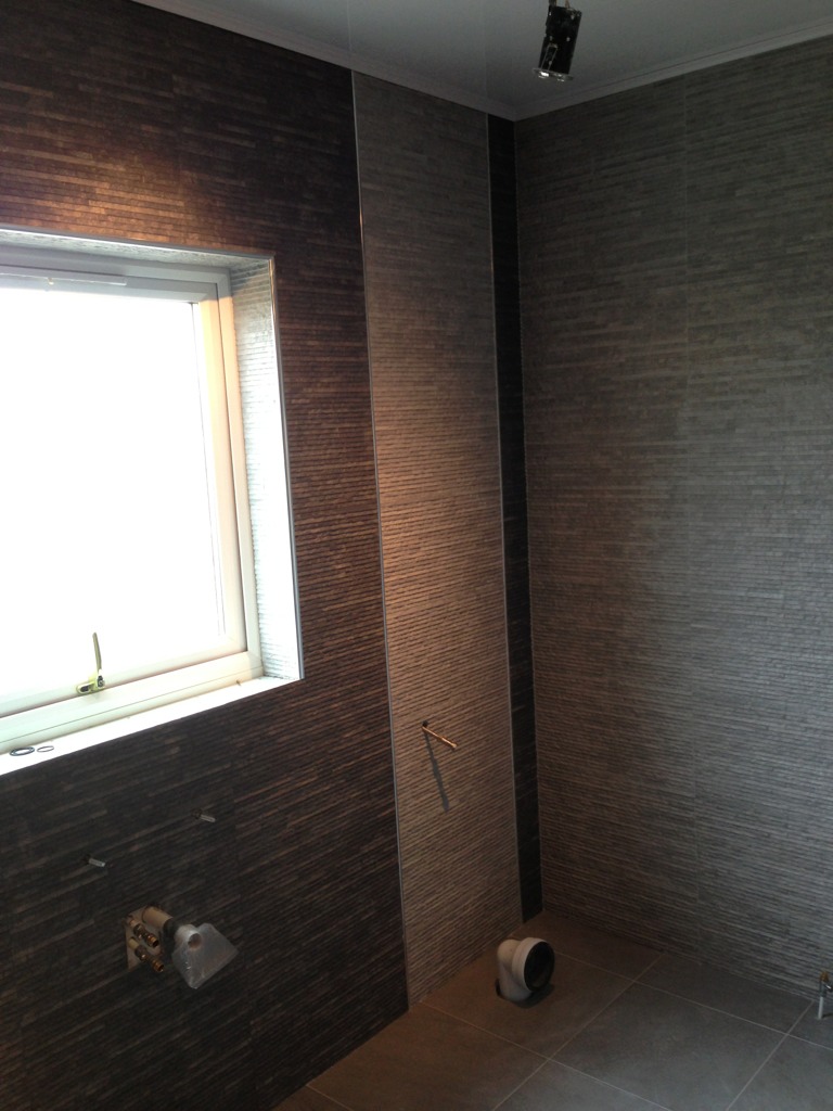

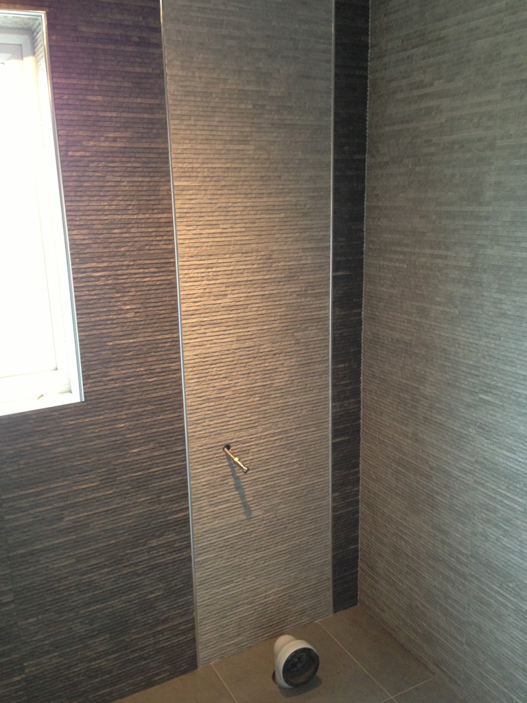

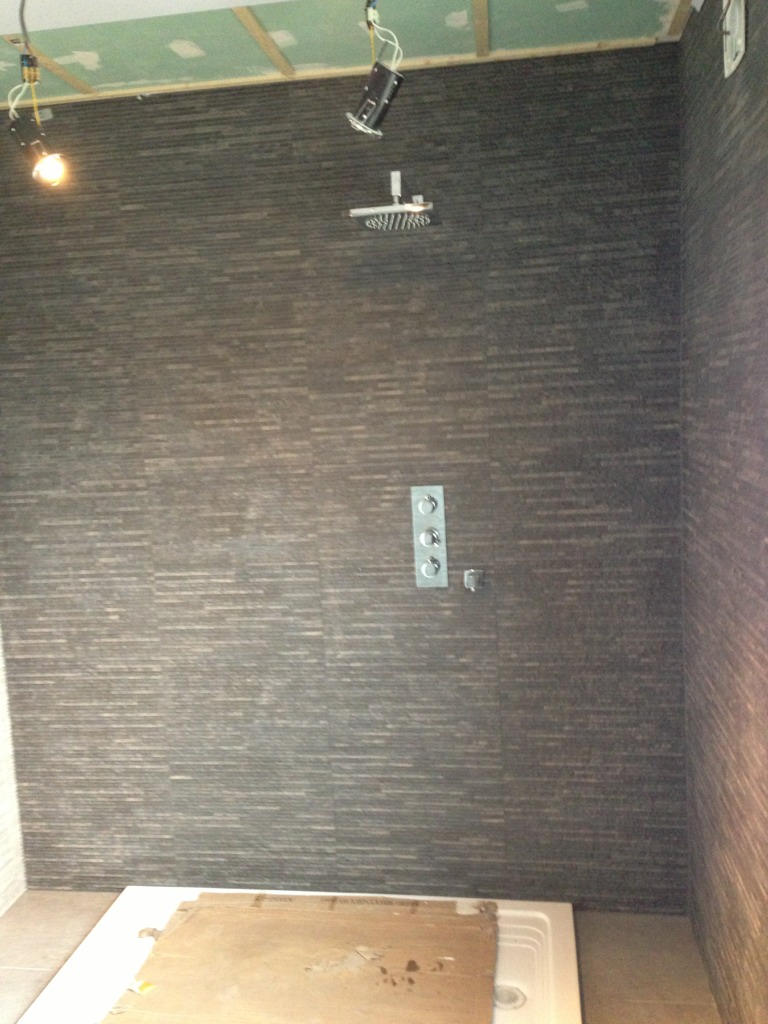

Well that's the job from hell finished!!
ImageUploadedByTapatalk1372190173.760522.jpg ImageUploadedByTapatalk1372190184.067703.jpg ImageUploadedByTapatalk1372190201.667628.jpg ImageUploadedByTapatalk1372190213.583999.jpg ImageUploadedByTapatalk1372190227.684397.jpg ImageUploadedByTapatalk1372190241.067548.jpg ImageUploadedByTapatalk1372190254.867343.jpg ImageUploadedByTapatalk1372190266.600904.jpg ImageUploadedByTapatalk1372190275.617760.jpg ImageUploadedByTapatalk1372190288.200858.jpg
Was worth the effort, clients are over the moon with it..

I fit some of these the other day. Just a few boxes randomly on walls in a pub as features, two rows at a time about two mtrs high. Couldn't get my head around the butting up, so I put a small Silicon bead on the edges during fitting, colour was good and you could hardly see the join. No clean up after either which was nice. Don't think I would fancy doing what you just have with them. Nice looking job though.
gamma38
485
1,058
Bedford
Gamma, that's a great idea about the Silicon, should have thought of that last week & would have saved a lot of hassle.
Silicon it, Wonder Wipe it, Job Done.. 
It was one of my better ideas i think, your right though, it was that simple and as soon as the last tile was laid i was done.
