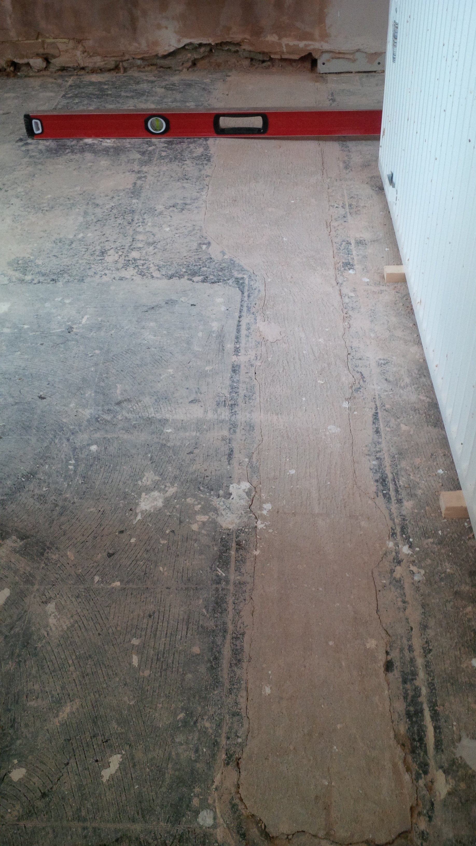

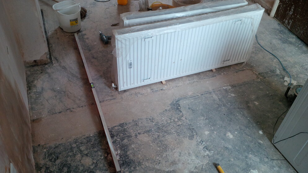

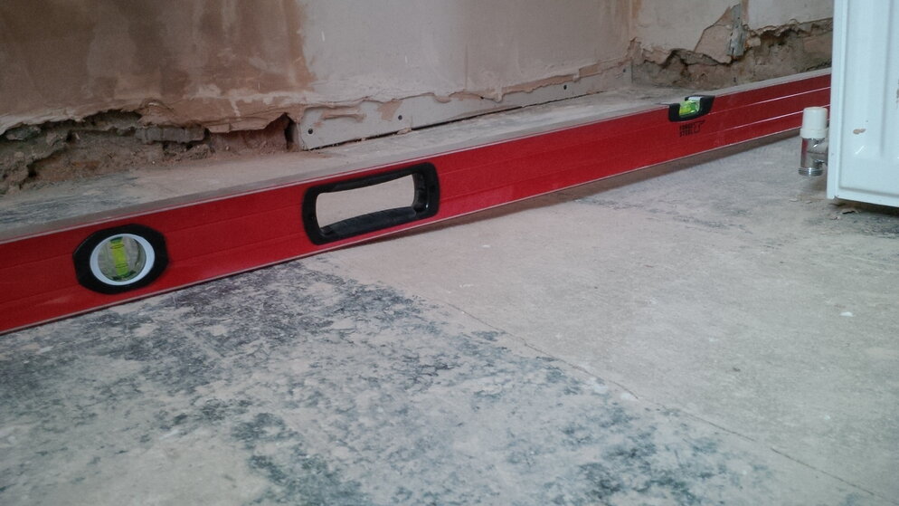

We're refurbing a through kitchen / diner. Sometime in the past, a brick wall separated the two rooms. This has been removed and has left a finger-shaped ridge in the floor (approx. 2m x 60cm). The foundation of the old brick wall has been patched up with concrete and the rest of the floor is the residue of bitumen adhesive from 1950s 9x9 vinyl asbestos tiles. The difference in the height of the floor across the width of the concrete 'finger' is about 2-4cm.
I was planning to use SLC on the entire floor and then tile it. However, we've been advised not to, since it will raise the level of the lower section of the floor and create a high step into the room. It's also unnecessary since the two halves of the floor are each reasonably level - just not level with each other! The plan instead is to smooth out the ridge, creating a gentle gradient which can then be tiled.
I've been advised to use a levelling compound and a straight edge to shape a gentle slope ready for tiling. However, I'm stuck trying to find a suitable compound. Presumably I can't use a *self*levelling compound, since it needs to be trowelled on and hold the shape of the slope until set.
Any recommendations on what would work best for this - both in terms of a suitable compound and any tips on technique?
