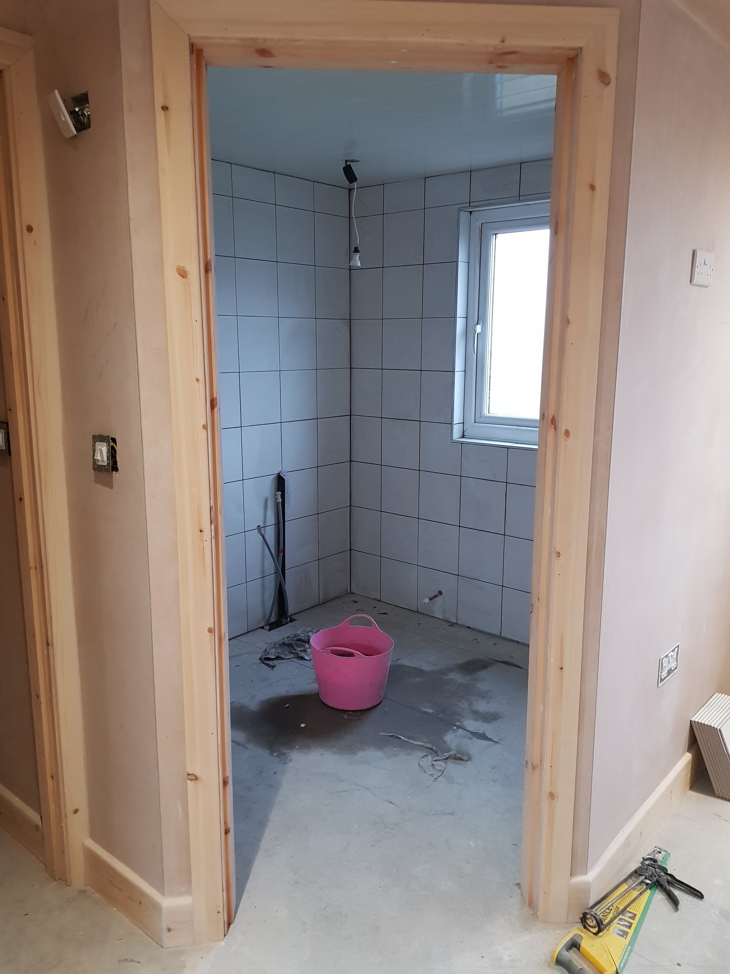

is there a compromise where I could get them to take the slither and one tile out each side and put two half tiles in or will that look as bad?
By the way the shower tray/cubicle and sink is fitted on that wall since the pictures.
I did ask on this thread does there exist a corner trim, maybe brushed stainless steel that could be fitted and look ok?
To be honest I think it will be too noticeable that you have two half tiles in a corner. You could give it a go to see if you can live with it before making your decision about re-tiling, but personally, I think it will be a waste of time. Others may have a different opinion.
It depends on how thick the slither is, but this is 15mm deep and may work to cover it?
https://www.tiling tools/product/15...ished-chrome-self-adhesive-internal-trim-2-5m
EDIT: thinking about it, if it works, it may be worth doing all internal corners to keep it uniform around the room so they don't look out of place.
That's the sort of thing Paul, thing is I don't think 15mm is big enough to cover it, more like 25-30mm. That's quite big. Does anyone bathroom have this sort of corner finish by choice? Maybe high end bathroom - lol.
I'm getting to the point where I'm thinking to rip the ffing lot out. Everything is a compromise and it shouldn't be. Anyone want a job in Lancashire?
In some situations, they can look quite neat, but if its the intended look you are looking for, there are better trims to use and the tiling still needs to be right. This is designed more of a last-ditch cover-up when all other options are exhausted.
Yes, I think I'm going to get it redone, I guess tiles don't come off to easily from plasterboard. Better sometimes to take a step back before continuing. Thanks all for your help and advice.
The layout has gone horribly wrong. Not sure why as the classic mistake is not realising the walls are not plumb as the installer goes up the wall from the first bottom course with a full tile, but it seems this was easily apparent as the cuts are tiny all the way up. I think this is just a poor job and is prone to water ingress. Tiles don't look level either as the joints don't meet in corners. Looks like grout has been used in the soap niches instead of Silicon which won't seal out water. Poor cutting of tiles (rough machine edges). Non-mitre of trims, just butt-joints.
The only solution is to ask him to rip it out and start again.
I'm ordering new tiles today. Bathroom furniture being taken out tomorrow. Next week tiles off full wall and bad ones around window being taken off and surface prepared. After that I'm looking for a tiler ro finish. You don't fancy coming over to Ramsbottom do you?
I'll take all tips on board when liaising with tiler. I'm interested to know how you professional tillers would have laid out this space. Whether there are different ideas on approach. On left side is a shower quadrant. On right side mirror cabinet and sink.
You need to send me a message as yours is blocking contact, so I can give you my details and vice versa.
Wise choice taffy
Clearly not a tiler by trade. Builder brought him in as part of a loft conversion. Part of the bathroom isn't too bad. I think a combination of lack of care and attention to detail, which are paramount if tiling skill is limited. I'll never have a job done in future by someone who isn't qualified. Tiling is a science and an art.
