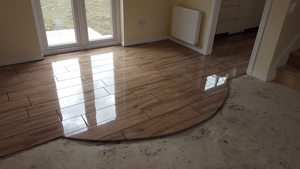

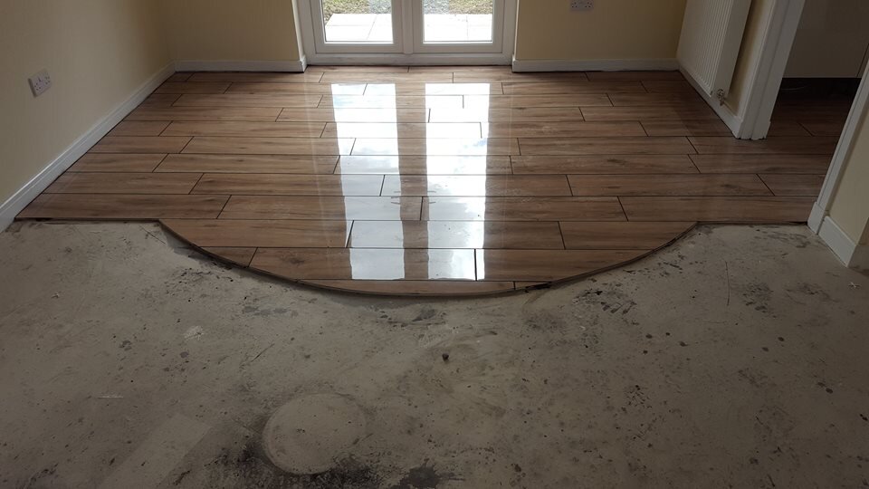

I haven't seen any positive feedback, personally I think it is a great idea. Best of luck guys and if you are looking for anybody to try or test the product? I would be more than happy to try it and give you honest positive or negative feedback.
As mentioned previously, I think the product would fair well in "curved" cuttings. I have attached a couple of examples. All of which were achieved with an angle grinder.
View attachment 84138 View attachment 84139
to do this, I think a grinder, is better :)
