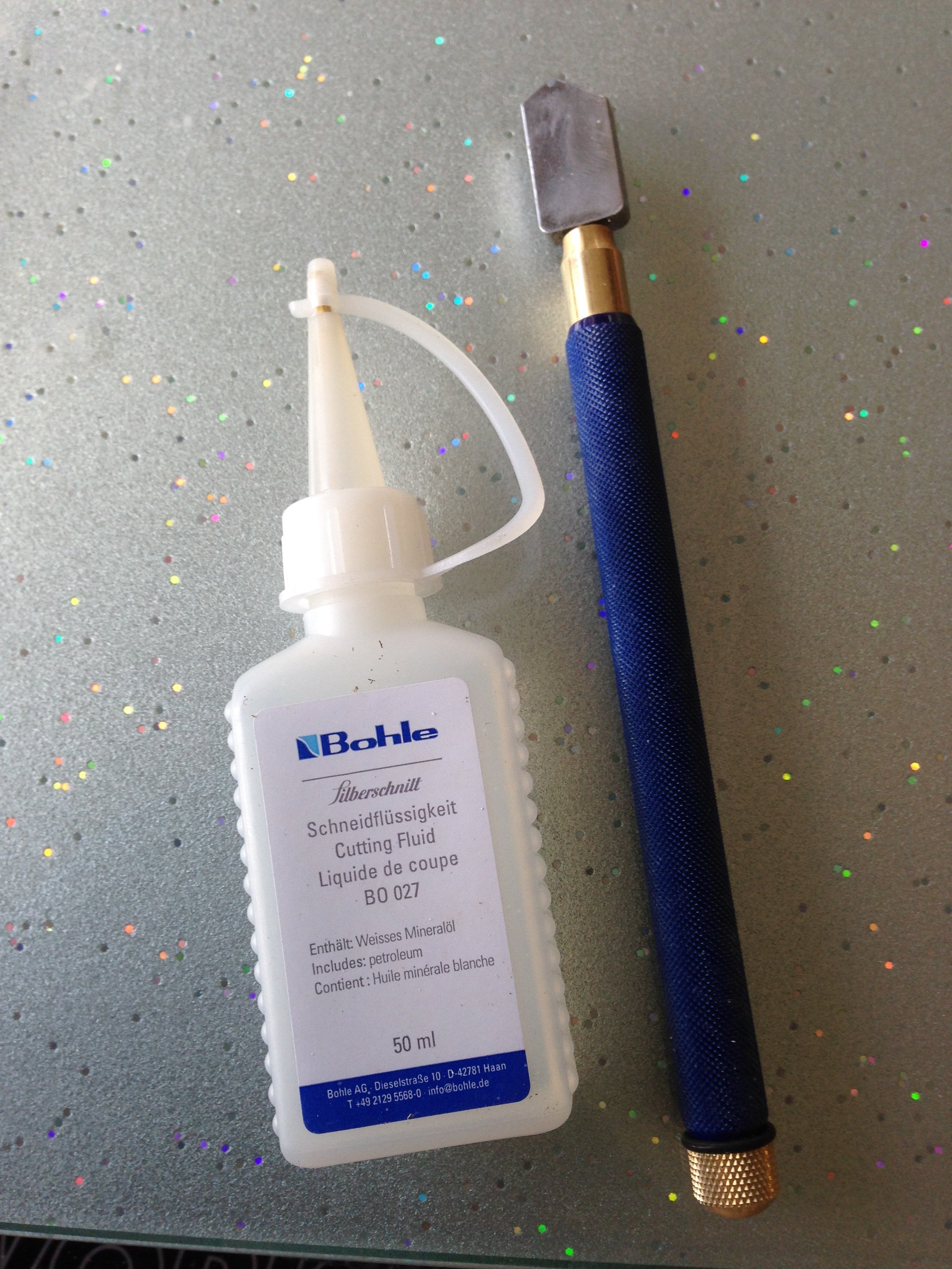

Get a glazers glass cutting wheel. I'd assume it's the right tool for the job and all that?
If you're going to use a manual glass cutter get an oil filled one. U'll
Find u need to Put a straight edge 2.5mm off the shoulder of the cutter, that way the wheel will hit your mark.
Get something like this from
Oil Glass Cutters with Integrated Oil Reservoir
