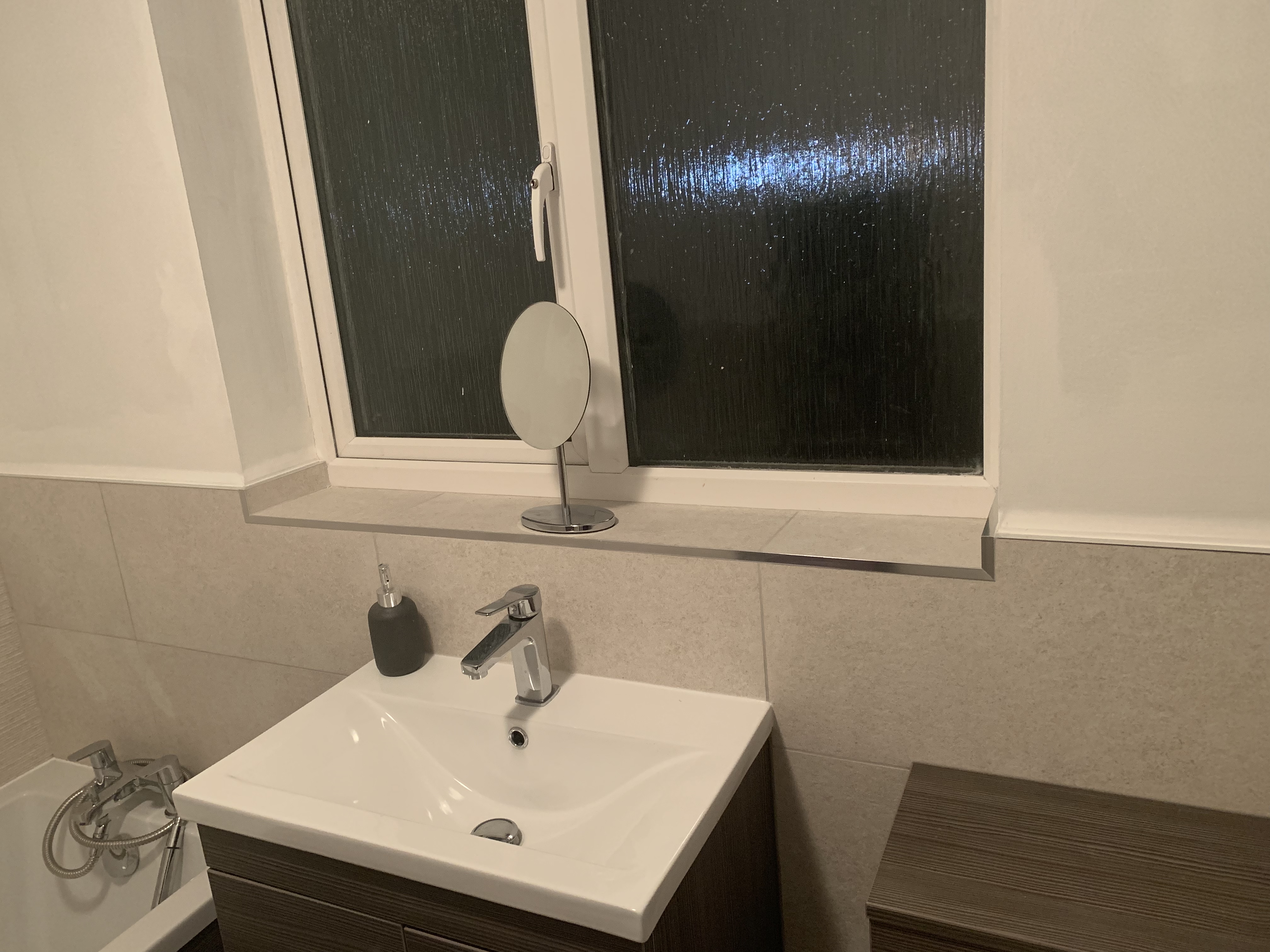

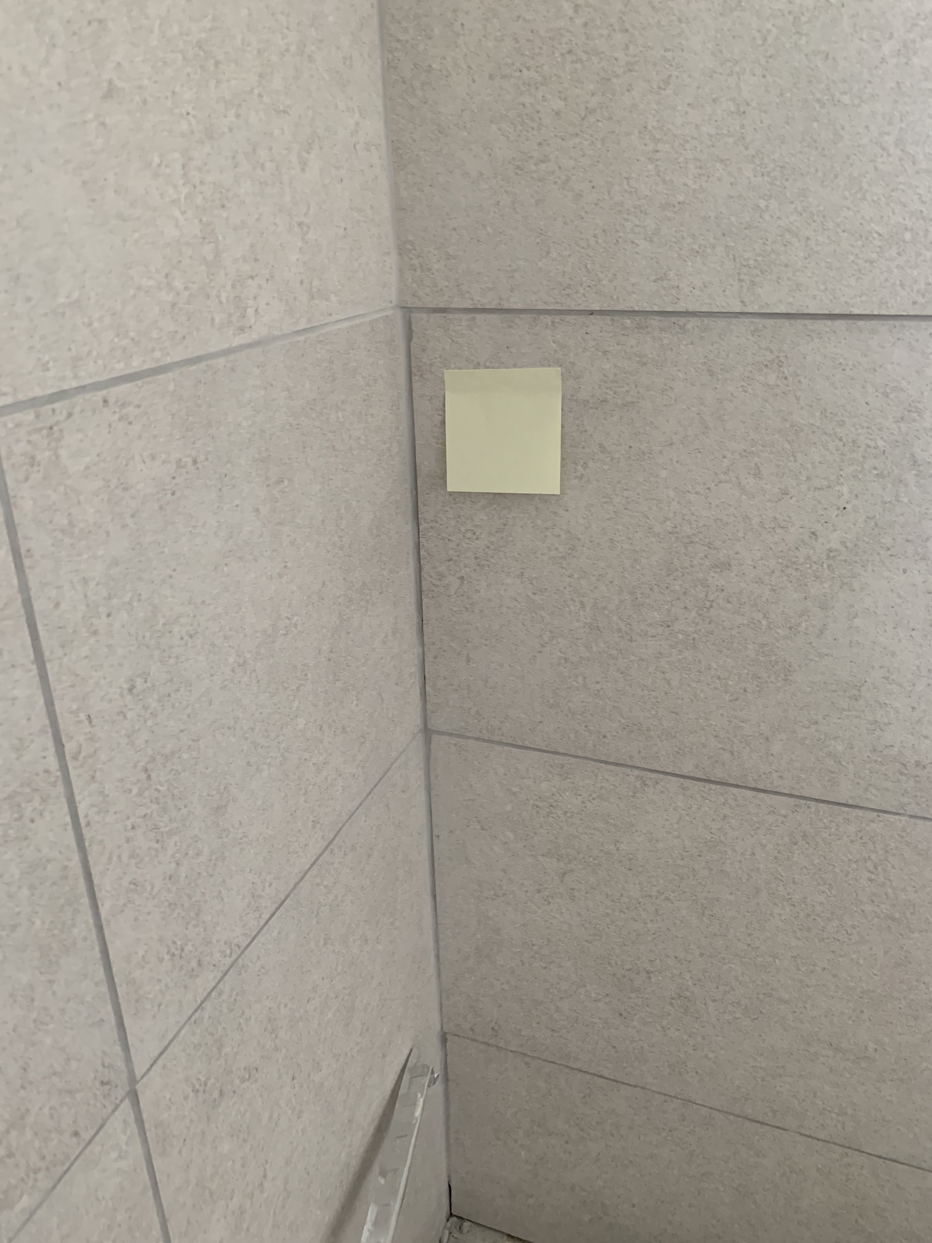

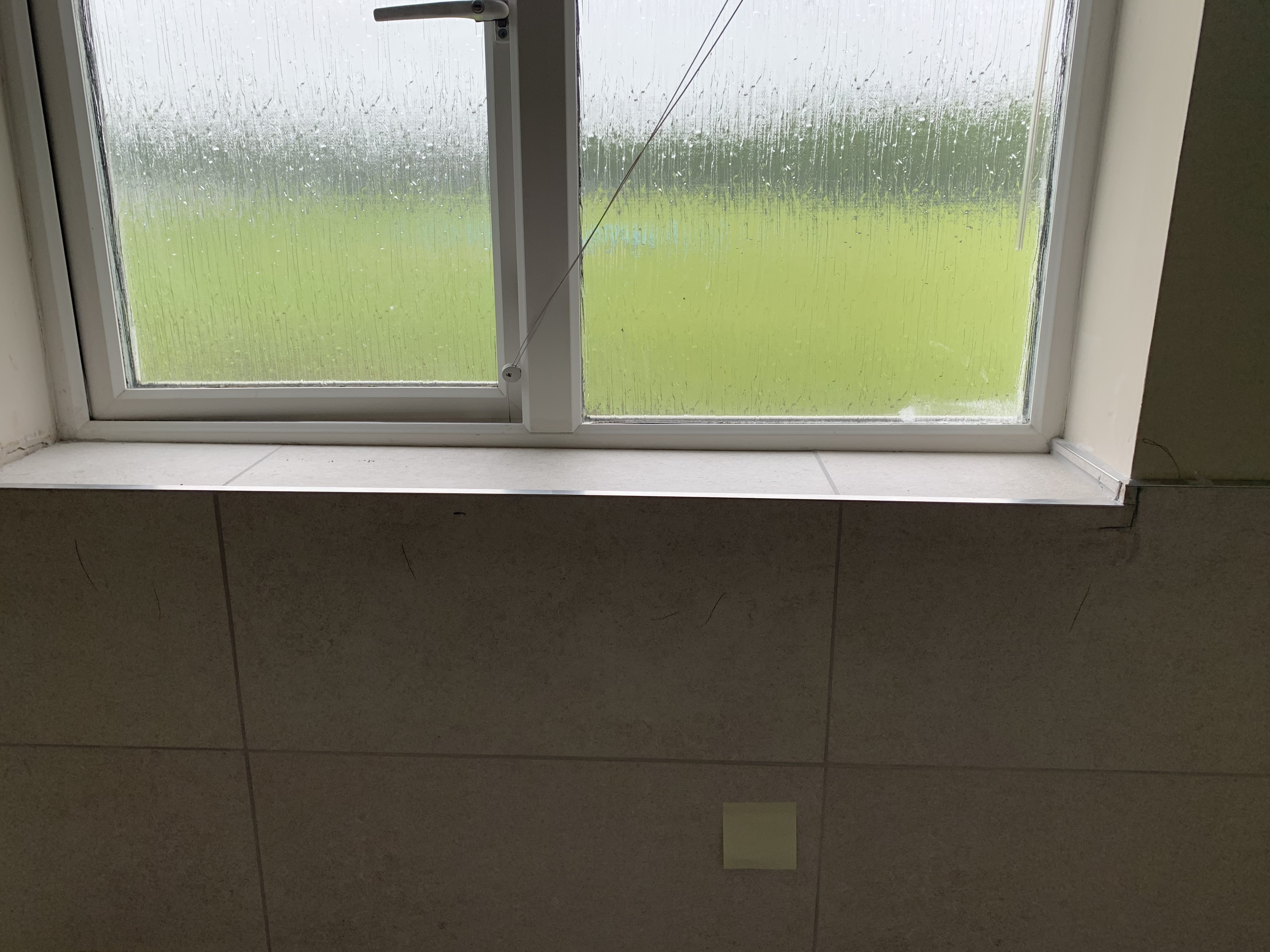

The tiler has done an awful job on our bathroom. There are lips, poor grout lines, poor cuts, poor layout, poorly finished and mismatched trim with the main issue for me being around the window.
Yesterday he came back to finish off but we came to an agreement for him to walk away as I wasn’t happy and had no faith in him to rectify any problems. We settled on an amount of money whereby he paid me the purchase price of my tiles.
However the plumber I have used knows a tiler and he came to look at it yesterday afternoon. He was shocked at the quality and has suggested at least one plasterboard wall is cut out, re-boarded and re-tiled but the window is tricky due to the height of the top row.
The new tiler has pointed out so many issues that I had not noticed I just want the whole lot ripped out, re-boarded and started from fresh. They both said this was a big job but I really don’t know if I can live with the mistakes.

This is the course of action I’ve decided to take. My plumber is fantastic and has had his own business for years, fitting many bathrooms. We chatted yesterday and next week we are cutting out the 2 plasterboard walls and re boarding them. The decor tiles along the length if the bath are actually very good so they will remain. We will smash off the top row of tiles along the window and drop the height of the window sill to make the window reveal deeper and draw your eye away from the fact it isn’t level.

Why not raise the height of the sill so you can finish the whole row on a full tile and then tile in the sill to the same level, will look much better imo as there is such a small amount of tile going in there even if it gets slightly bigger and less trim work required to go wrong. However it does look a bit tight for that as there isn't much more height to play with
Smashing off just the top row will not help if that row is not level in the first place which to me, it doesn't look like it is. (Unless the window is out too)
My plumber brought along his tiler friend who he highly recommended (don’t ask me why I didn’t ask him for recommendations in the first place as I feel stupid for not doing this!!!) and we chatted about doing exactly that however it would take the tile up past the chamfered/sloping edge of the window. This only way to go is down to make it look acceptable really. We will then see if the sill can be re-tiled or we fit a wooden sill and tile to that, framing the window and not wrapping round into the reveal. It doesn’t help as the window is running out.
The tiles are level....the window is out. The original tiler noticed this but just ploughed on instead of asking me my thoughts. Plus this way I will get rid of the worst lip in the whole bathroom which is between the top row and next tile down.
If the window is that far out the plasterer has made a great job of paralleling the reveals...... check your window again.
Dumbo
That’s what the plumber said!!! We will see more when we remove the top row and that sill.
You only need to put a spirit level along the grout line below the window . Tbh those pictures don't look right unless it's how you hold the camera . My guess is because he has come a whole tile of the bath the bath isn't level and there for the tiles are not level.
I am a very sceptical person so here goes , may be your plumber isn't as good as you think he is and now because of poor tiling he's been found out and he now has his mate who is helping to cover his mess as well by saying the window is not square .
The bath is completely level
