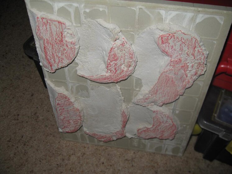

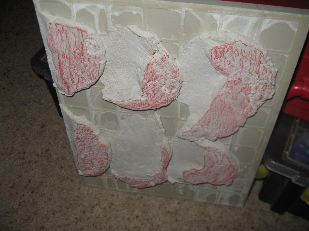

I've just taken a picture of the cut tile that I pulled away..using a crayon ive marked the adhesive to wall contact points in red. Would that have held it in place in a steamy bathroom?

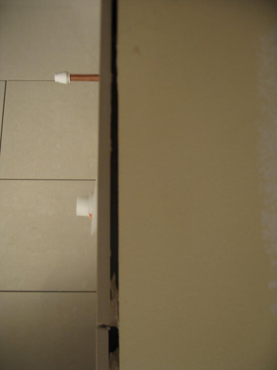

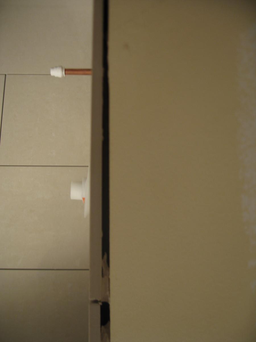

The second picture is of the gap from the wall that all the tiles have...a little excessive to account for the walls being out. You'll note that the adhesive is nowhere to be seen.

dot and dab is a common method used by non tilers as it saves on addy and is easier to adjust when fixing
adhesive manufacturers reccomend min 70% coverage but most tilers work on 90% min
porcelain are dense and therefore heavier than biscuit and need a good purchase to the substrate
another advantage of 90% coverage is when you press the tile in you push the air out creating suction holding the tile where you placed it
youve been given sound advice on here
with care you will be able to remove all the tiles and clean them ready for reuse
score through the painted surfaces and then prime, dont just prime as the primer wont penetrate the paint and the paint may seperate from the wall dropping your tiles

sorry to say you need to rip them off. but if they are coming off that easy you should be able save most of them and keep the costs down. re the painted wall i wold strongly suggest getting all the paint off. i use a 4"razor scraper, as i find this the fastest method.just make sure you prime and use a good quality flexible powdered addy(using a notched trowel of course).

I'm sad to say that I spent 2 days last week retiling a bathroom that echos similar circumstances to your own. They were the same tiles and were fixed with cement based adhesive, dot and dab on to emulsioned walls. The whole wall of tiles had dropped 3mm opening up a grout line basically resting on the bath held together by grout. They also failed in the shower where it wasn't painted. I re-prepped the walls by stripping all the paint left on the walls (the rest was on the tiles i removed), I then keyed the walls a lot to rough them up and then primed with SBR primer. I fixed them to the wall with a 10mm trowel then by spreading the wall and then the tile. I am pretty confident this will be enough. I cannot stress the importance of fixing porcelain solidly to walls, it is ridiculously heavy and possibly dangerous. Good luck
