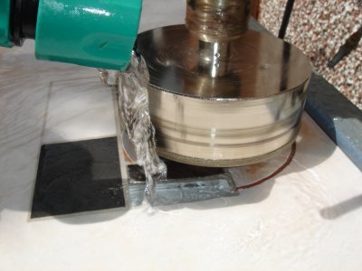

All tile drills need to be water cooled. Any that dont are either so expensive to buy, rip the material rather than drill, or shower the installer with dust and shards.
As mentioned always use water when drilling tiles for both cooling and dust collection.
Soak a sponge in water.
Dont wring it out.
keep it bloated with water.
When drilling on a wall hold UNDER the core to catch the debris and cool the core.
When drilling on the flat (horizontal) you can dribble water on.
[Note: you will not need a CONSTANT stream - as shown above - Mearly a puddle of water]

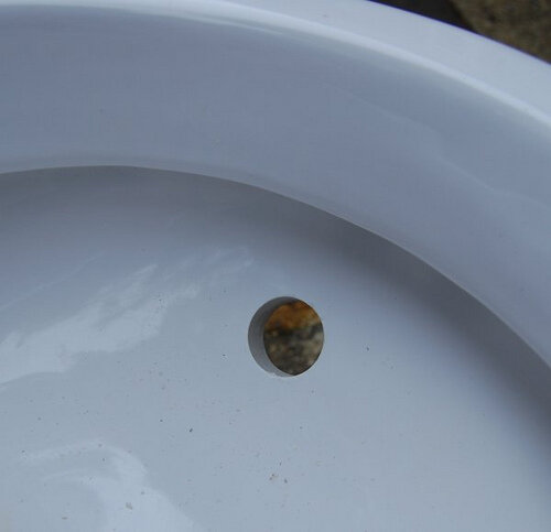

I've just photographed the holes on the toilet that we drilled. Here they are close up:
Wide Shot
Yes I agree the holes are perfect

Lol :lol::lol::lol::lol::lol: Its not April 1st already is it ?
This picture is similar to where i drilled the holes.
I'm thinking maybe i should have used something to seal the holes?
