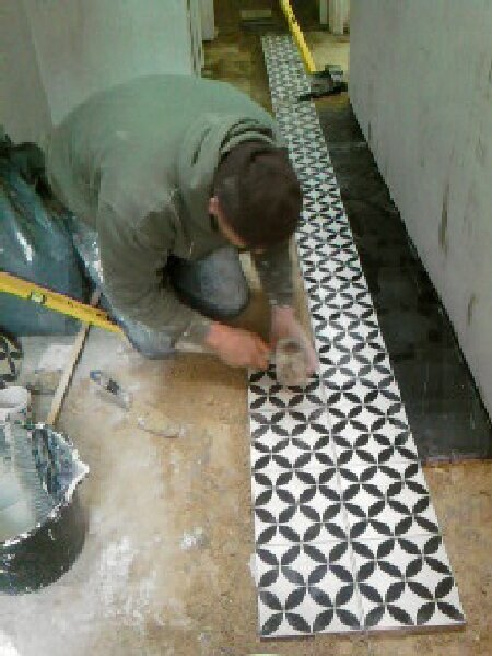

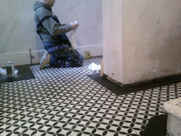

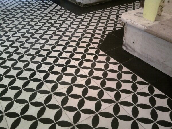

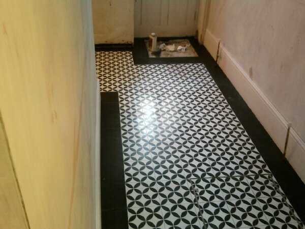

I dont do too many jobs using cement encaustic ,last one i did was 3 years ago and i didnt use any tile adhesive to fit the tiles or seal them prior to fixing them , the tiles were soaked in a water butt for 24 hrs then drained and stacked for 30 minutes prior to being fixed in sand and cement the tiles were simply cleaned with a sponge while fixing them but i did use white cement for the bonding slurry here are a few pictures ,the tiles were supplied with an impregnator and i used a paste wax to finish them and used a 15 inch rotary buffer to finish the floor,the tiles did bloom with eflouresence 6 months after they were fixed after a flood from the central heating which was simply removed with coarse wire wool and vinegar here are few pictures of the finished job
