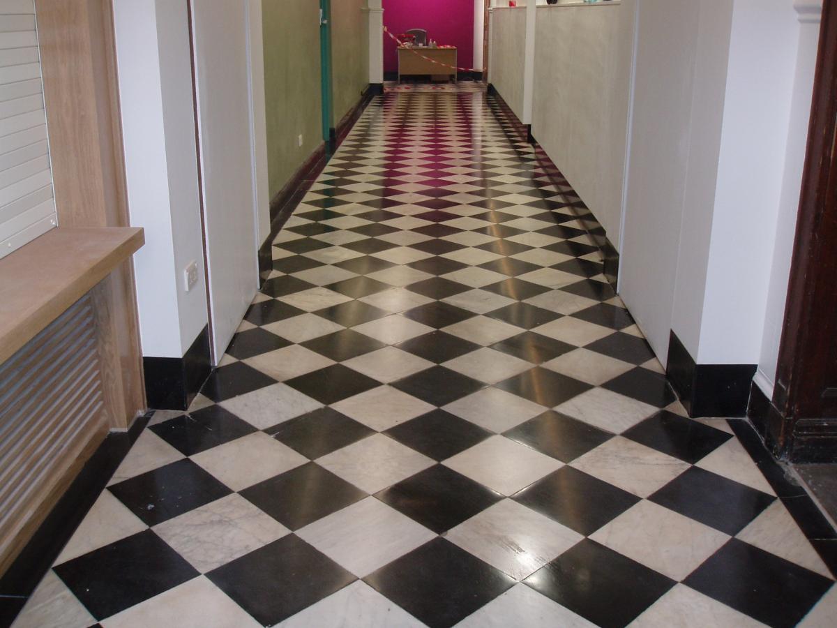

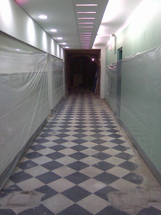

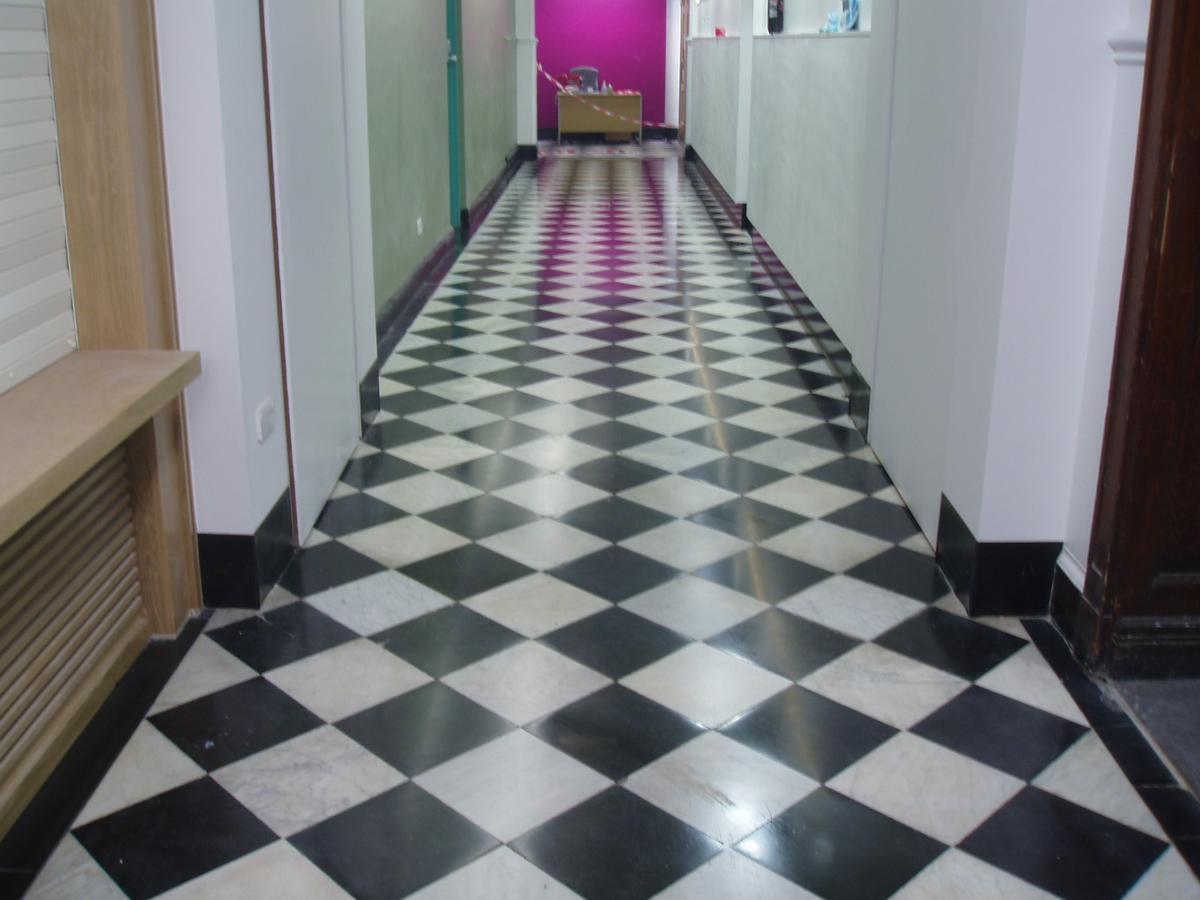

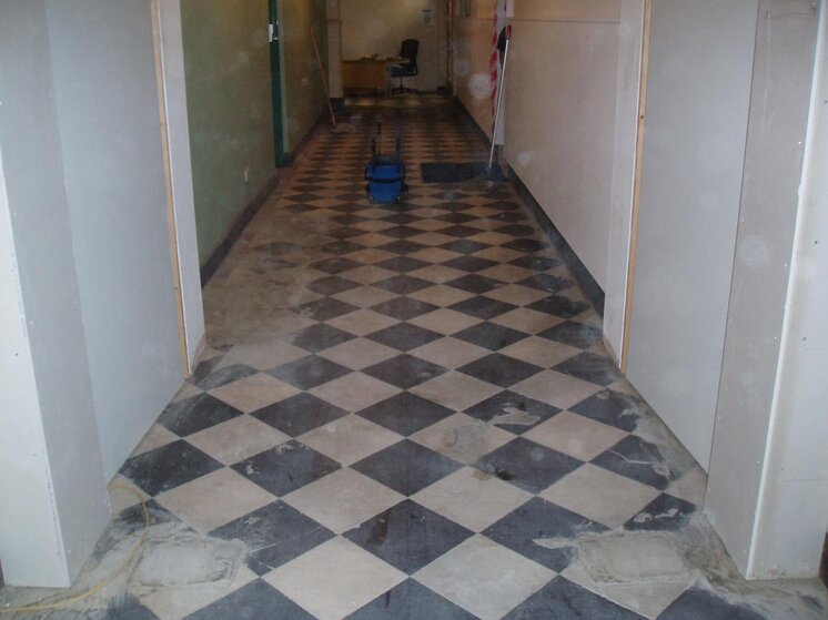

We have just completed this job.
This passageway was down to have altro installed,but once they had identified the original floor covering was Grade 2 listed White carrara + Black honed slate we was asked if we could restore the complete passageway.The floor had been levelled out with latex.We had to remove latex clean then replace screeded areas with matching tiles/borders.Because the new white carrara was fresh + new we had to age tiles to match once the architect agreed of match sample.After that we re-honed to try and restore to match original floor which continued on (behind camera).
Hard slog but worth it in the end.
here are some photos.
