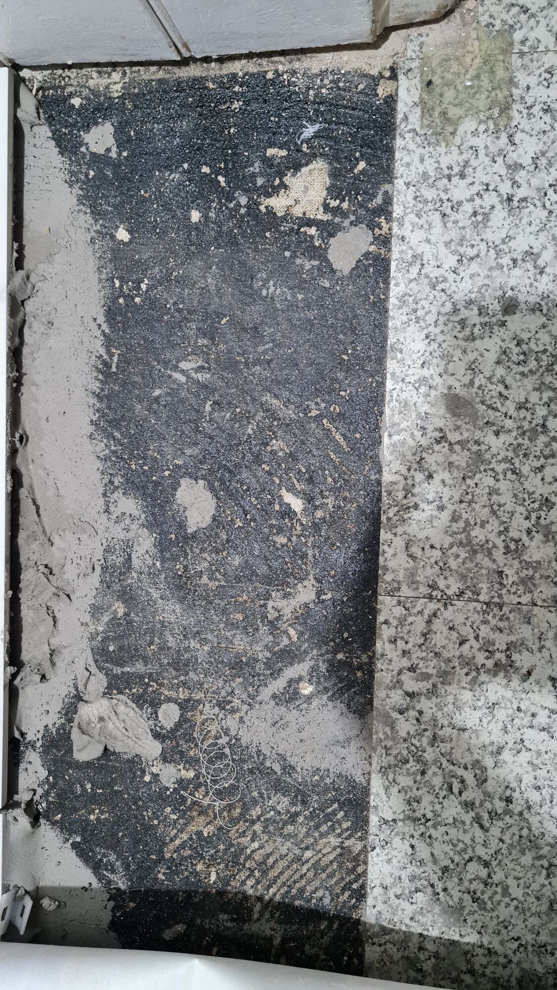

I am new to this forum and I'm looking for your experts' advice in a situation that I'm stuck in. This is a 1980's house and we already have an in-screed electric underfloor heating (nearly 40 years old) on a concrete base. We removed the existing laminate floor to lay tiles in our hallway. Under the laminate floor are the old thin vinyl (I think marley) tiles. My tiler removed it and found the black paint (probably bitumen but we are not sure) stuck with old vinyl tiles. Photos attached for reference.
He then applied Rapid flex adhesive and fixed our 60 x 60 tiles. We were not at home and when we came back he said a lot of heat was generated when he laid the tiles. We can still feel the tiles to be warm even after 5 hours of them being laid! He has half-finished the job and yet to do the remaining half of the hall floor.

Sounds like a chemical reaction that wasn't in your favour there. Apologies for the late reply. How did you get on with this in the end?
🙂 the hydration if cement is strongly exothermic. I would guess the adhesive is made with pretty much brand new cement and hasnt been sat in the bag for long. This would lead ut yo being hotter than usual as it sets. There is no reaction between bitumen and cement that I know of.
