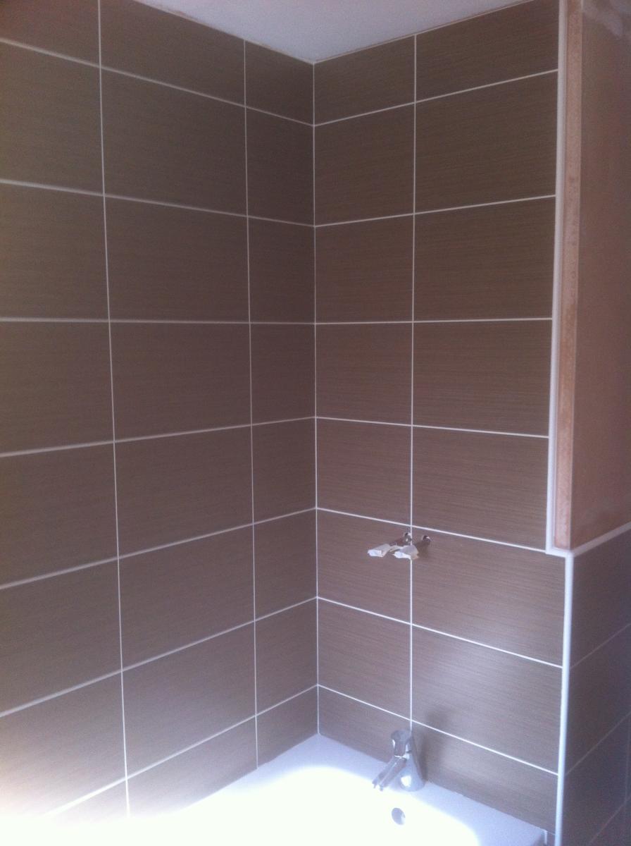

Where the external corner is, finish the tiling 50mm or so back from it, then you can trim down the vertical edge and mitre it into the horizontal, essentially, you'll be starting the half height 50mm in from the external edge this method will help you overcome the need for double trimming.
Step your tile back about 30/50mm from the edge of the external corner & put your trim in on the top half of the tiling cutting a mitre at the bottom of this trim.
It's hard to explain, I will see if I can look out a photo as an example for you.

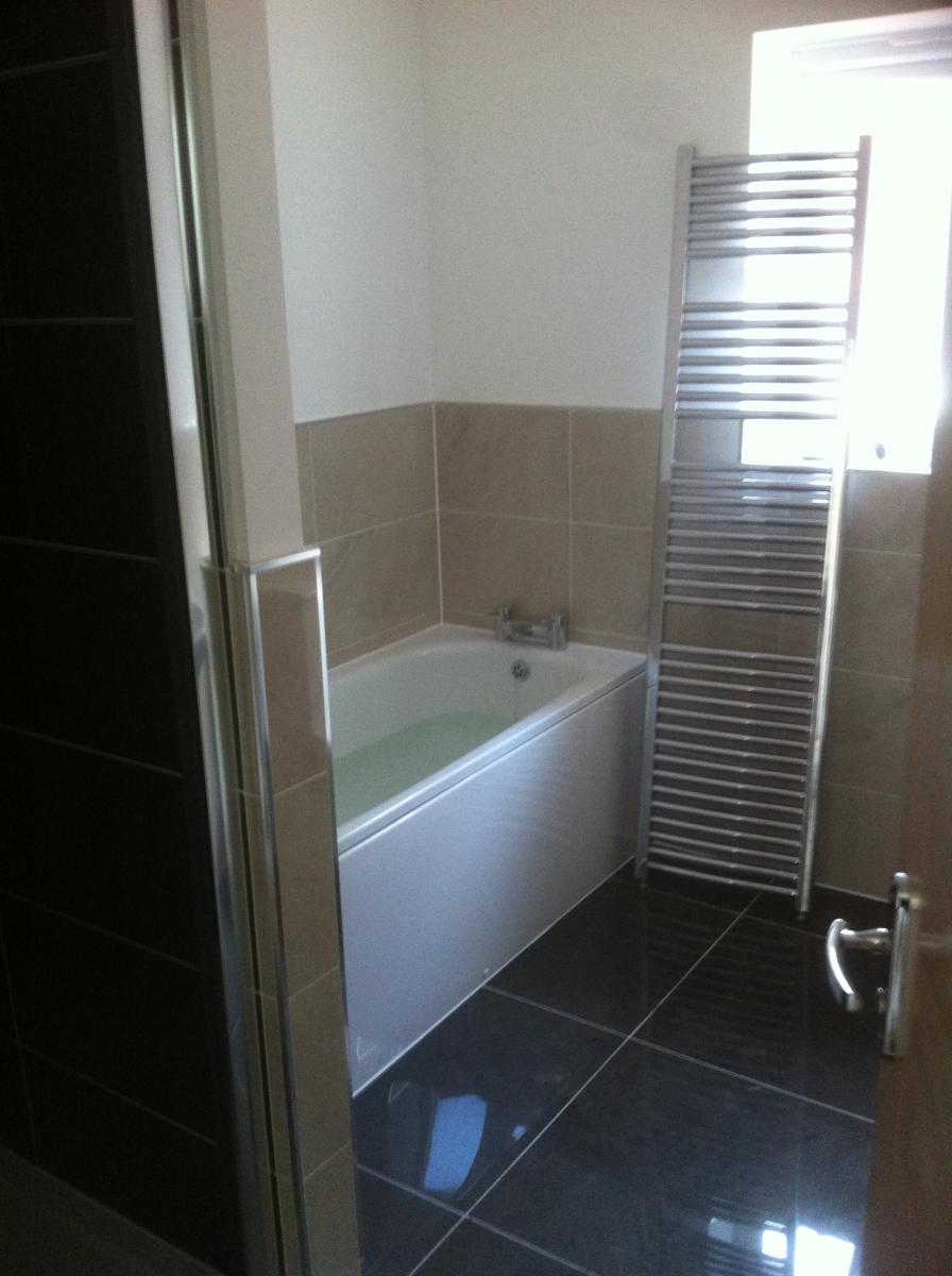

Tried to post this ages ago but wasn't getting a wifi..
2014-03-21 13.23.52.jpg :thumbsup:
You can also fully tile the full height wall on Deanotiles pics if you use L shaped trims and tile the half height wall first(bringing the tile a tiles thickness plus adh past the ext corner) and then the full height wall with your trim going upwards from the half height(apologies for no pics and the gobbledegook)
It can also be useful to use Schluter internal and external corner pieces right next to each other to avoid having to mitre trims.
