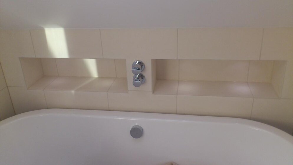

Hi all, look how other PRO TILERS do mitres :lol:
And i went in to try to repair with some paglerino akemi (stone glue), I know it's not perfect, but it's all i could do
DSC_0869.jpgDSC_0870.jpgDSC_0871.jpgDSC_0872.jpgDSC_0873.jpgDSC_0874.jpgDSC_0875.jpgDSC_0876.jpgDSC_0879.jpg
