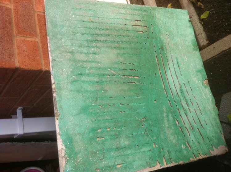

Today I have looked at the floor and I would say that 50-60% of the tiles have a hollow sound when tapped.
Below are the pictures of the tiles that were loose and removed.
You can see that the tiles were not back buttered but this clearly is not the cause of the failure.
It looks like the primer has de-bonded from the floor but if anyone can throw anything else at this I would appreciate it. I have given the customer the good news i.e. the floor probably won't take long to remove, but I think he is prepared for it all to come up. Kitchen and skirtings are all installed on top as well.
