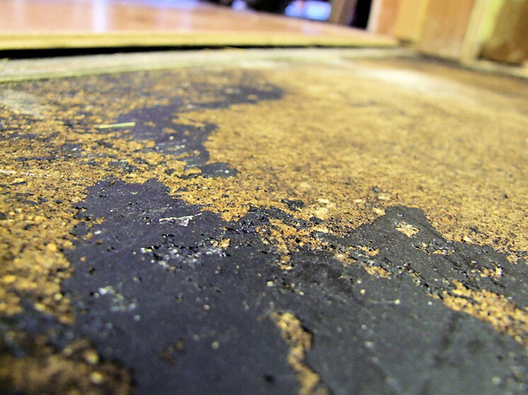

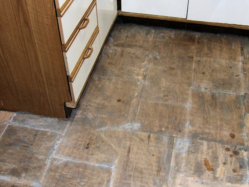

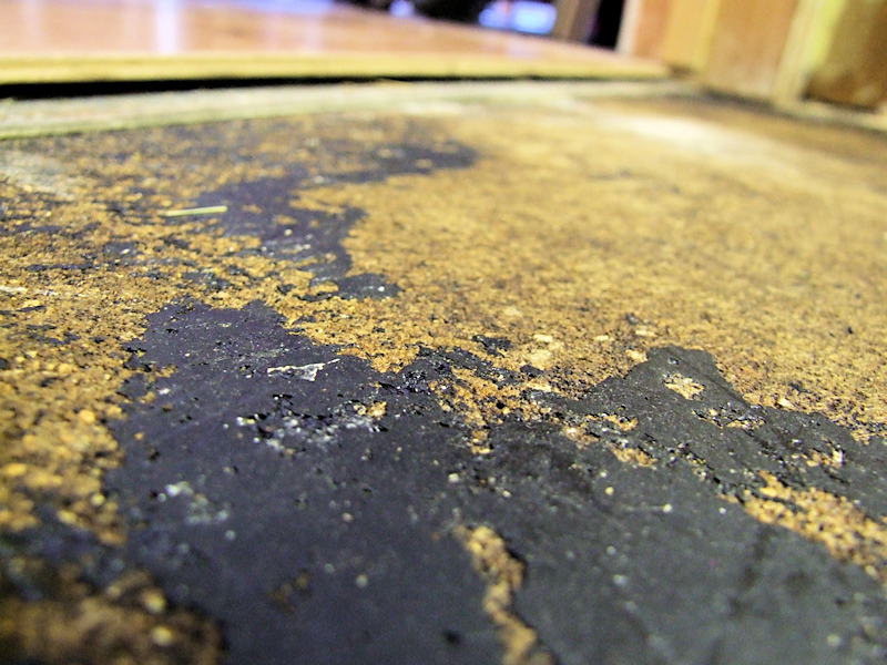

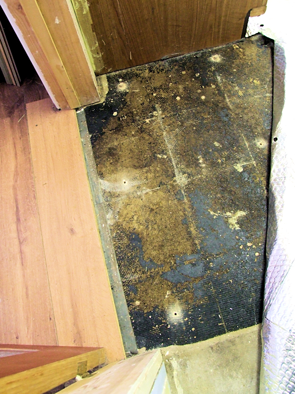

Anyway, have had more than one 'flood' in the kitchen over the years - once from the washing machine door springing open and emptying the contents and another with a bath leak through the ceiling. The thermoplastic floor tiles that came with the house started cracking and lifting and in the end we thought we would just rip it up and lay tiles.
However, although the thermoplastic tiles came up easily enough, the bitumen-like glue underneath didn't.
Research revealed that it would be inadvisable to lay tiles onto that surface without cleaning the bitumen/glue off first. As an alternative I read that you could overlay the concrete subfloor with plywood and then tile on top of that, with an appropriate adhesive.

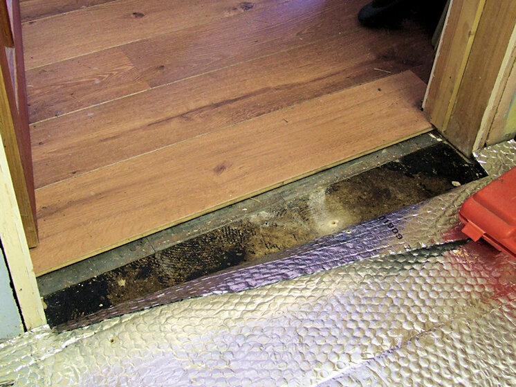

A trip to Travis Perkins and I was advised to use 5mm ext grade plywood ('this is what everyone uses') - duly delivered and laid and held down by Fischer Nylon Hammerfix F 6 x 40mm fixings at 450mm centres. This was laid over a 4mm layer of Airtec Double Foil Reflective Bubble Insulation to try and reduce heat loss through the floor.

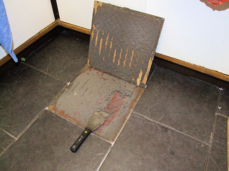

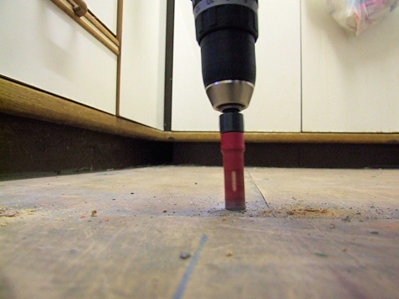

floortililgkitchen1opt.jpg Ok - thanks for all the replies - I've lifted another tile and it seems that the adhesive is just not setting even though these tiles were laid last Thursday evening.
Looks like I'm going to have to start again :(
But at least the adhesive is coming away with a scraper so may be able to reuse the tiles?
Deleted member 9966
Andy
Start now, getting the tiles up and cleaned off. as time consuming as it might sound, get one up at a time and soak it in a bucket of water. you should be able to rub the adhesive off by using your fingers or perhaps a scraper. The minute you get a tile up and open the adhesive up to the air, the adhesive will start to set and become more difficult to remove. You might be lucky to be able to save the whole lot of tiles.
