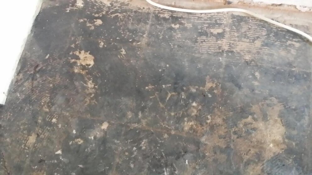

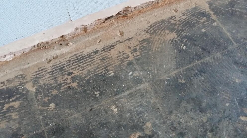

I have a 9 square metre kitchen that needs tiling, I have a concrete subfloor that has previously had marley type tiles on it (1965 house) stripped all the tile off and I an left with a small residue of bitumin ( I think) left on the concrete, I an putting down 6mm thermal boarding and then overtiling with 9mm 600x300 ceramic tiles.
Can I just stick the board down with my flexible quick set adhesive and then put tiles down on top, or will the adhesive not stick to the bitumin residue left over from the tiles ?
advice in black and white needed please.
Many thanks.

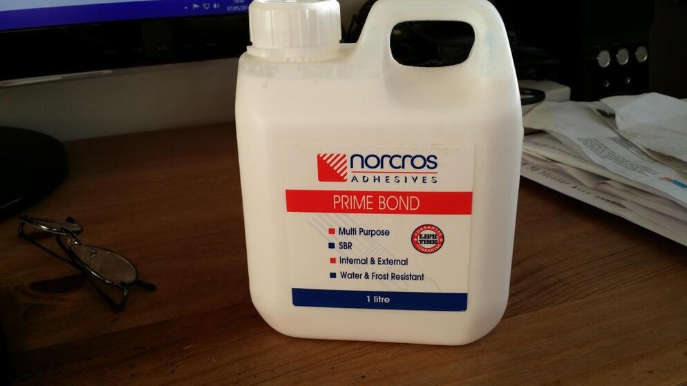

Today I bought a 1Ltr of Norcros prime bond from a tile shop, it is water based and he said you can use it neat or diluted,
1. multipurpose
2. SBR
3.Internal & external
4. water & frost resistant
have I bought the wrong stuff ? (he said it was correct for over bitumen residue) 20140507_194447_zps3b3f913b.jpg

Hi all thanks for the replies,
1. multipurpose
2. SBR
Your'll be fine with that....
