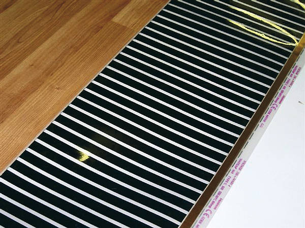

If it's the film stuff I'm thinking of, it's not suitable.
The same with Ribbon Underfloor Heating.
Cable only for tiles. In mat form or usual loose cable.
But not the film type above in the pic (not heard of your one).

Ply over the top of the film? Screwed between the film?
The film you can get in various widths. If he's screwed it down 300mm centres, and got between the 300mm film sheets, then perhaps treat it as a heated ply floor?
But if it's 500mm wide strips, so his screws about 550 centres, treat it as a ply floor not screwed down right lol

Each floor has a template. Because you buy the film in lengths, usually 500mm wide, then the last run 300mm or whatever. So you send off a plan to the supplier, and they order you EXACTLY the kit to fit your floor (hence the EcoFilmKit name).
So he has a plan for it.
But I can't see why he would ply the floor on top. That air void isn't going to allow heat through (air is the best cheap insulation - hence double glazing, styrofoam for floors which is just holding pockets of air etc etc etc).
So it's not going to heat tiles.
I can't even see why he's done it. It's not cheaper! And is loads more labour.
What's under the ply? If it's concrete with no insulation that heating may as well be thrown out.
