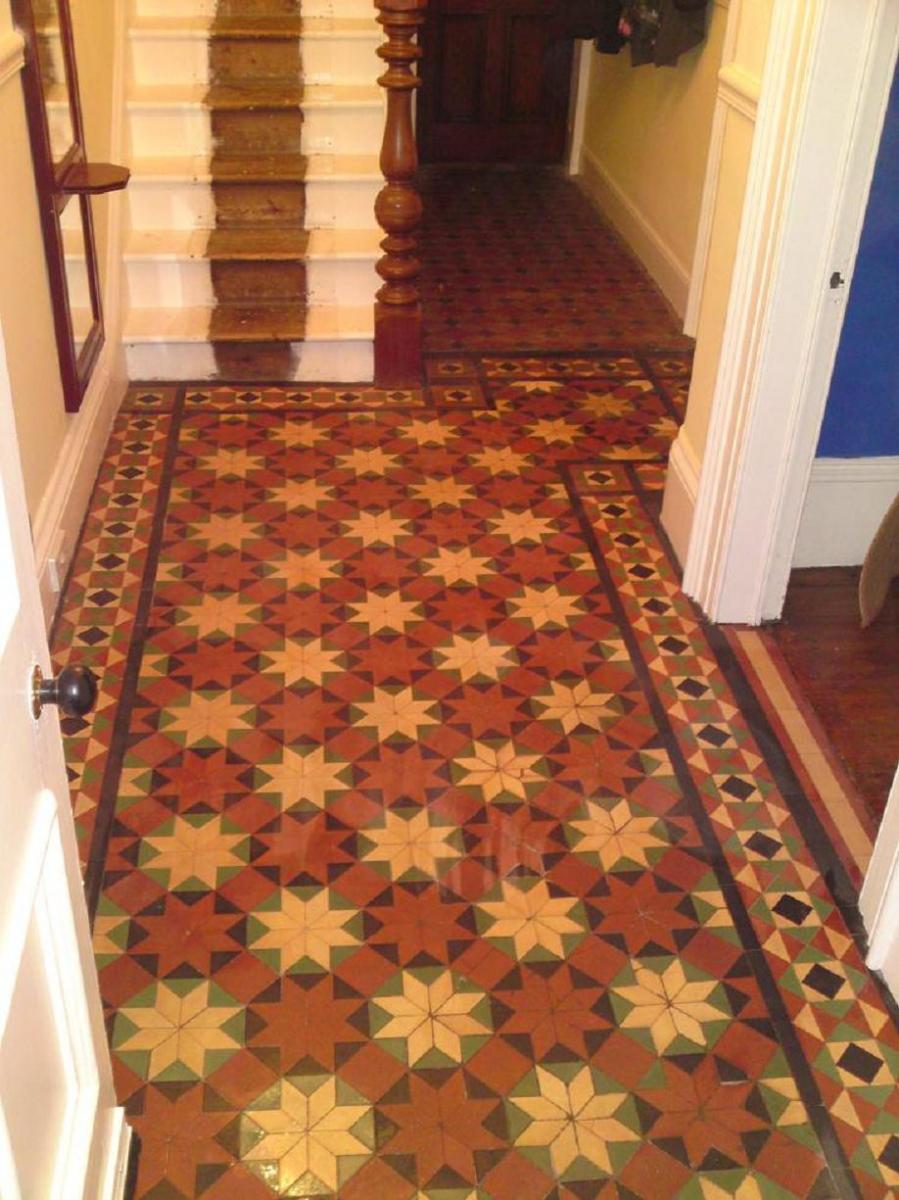

Even on the length of path in the photo there is no need to put a closure in!
If the joint had been increased by 1mm it could have gained the 20mm required to have mede it fit.
It's just poor setting out!
Mind you if you look at the brochure of Original Style some of the setting out in the actual jobs featured there leave a lot to be desired.:thumbsdown:

I think its easy to overestimate that all tile installations from way back in the 19C, 1920's etc were shining examples of tile work. Yes the tiles and designs themselves are of quality, but certainly not every job done was of the best setting or set-out. The individual tilers - and each jobs worth no doubt - would have varied then as now even if we sense they had a greater craftsmanship about them.
Over and above tiling work in general there is a most careful process to setting out geometric mosaic floors because the central field has its elements requiring their specific dimension and the border has its. As timelessjohn points out the attention to millimetres makes it work.
Of my work with these over the years the majority have been refurbishment rather than new and the 'faults', or shall we say 'accomodations' by our brother tilers back then to make the design work are common - and quite interesting to wonder at the circumstance!
I admire TimelessJohn for his bespoke formation of the tiles - as he tells us - for his floors - and no doubt is able to make them work spot on!
Where various field and border work often goes iffy at corners is where the designer / fixer doesnt allow to have the correct amount of thin rectangular border pieces , usually 6" x 1" ers, to make the span correct for the running pattern in the border centre - as shown in Gary's picture. What has happened in that work is the non planning for the border run - they started from the corners and...oppps..made what they could of it in the middle.
My most recent floor of encaustic and then border was a combination of old and then cutting down new to make the floor overall work. It was a element of input from clients (artists) architect and me as to the eventual success of the finished floors look. I was the only one on me knees mind!

What we have to remember with these classic tile designs is they were all fixed direct into the cement screed with no joint!
The base was generally levelled out and the tile designs laid straight into the wet cement.
They wouldn't have had the luxury of the whole area available to set out and dry lay prior to fixing.
We've just done a rescue on a Victorian today and if I have to say so myself it came out quite good! Central heating is no good for these floor and they get damaged very easily by modern temperatures. But this floor was very badly patched up over the years and we have managed to bring the pattern back to the full floor now.:thumbsup:
