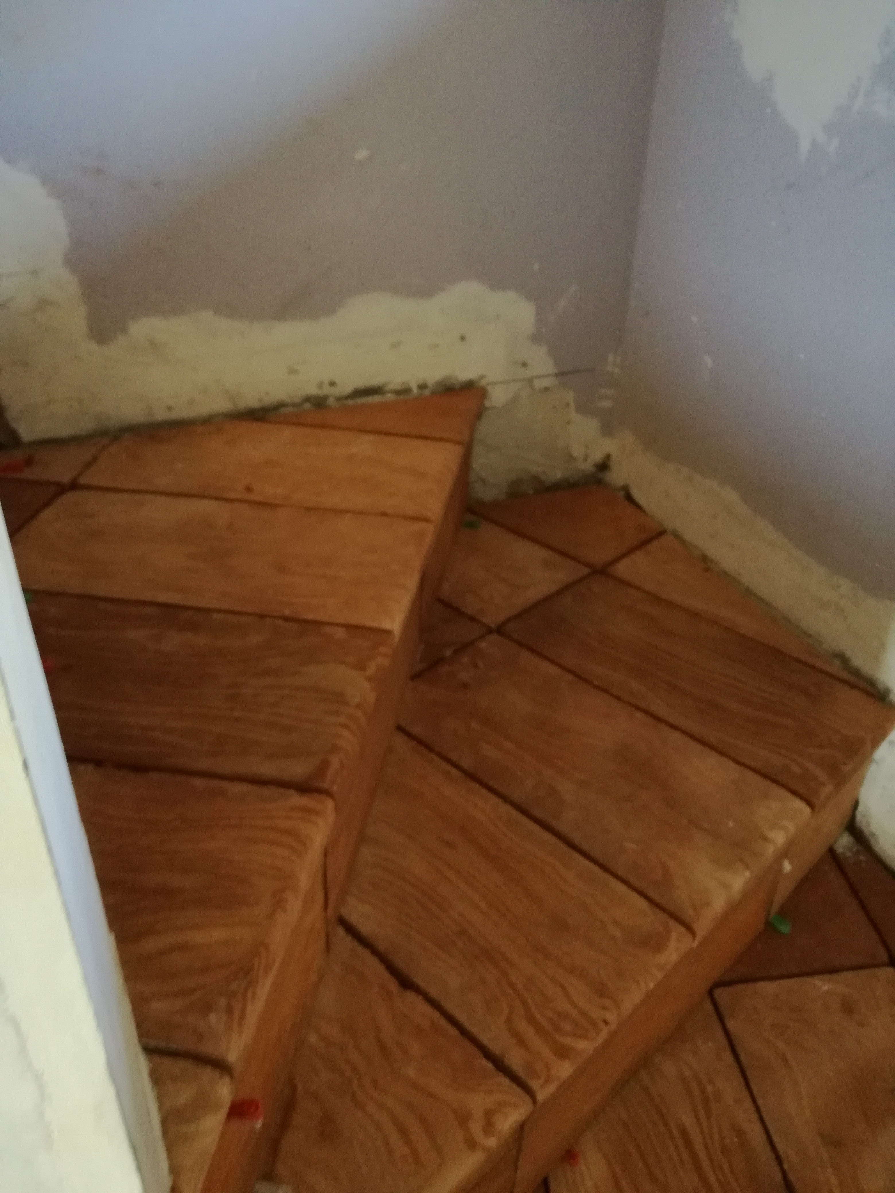

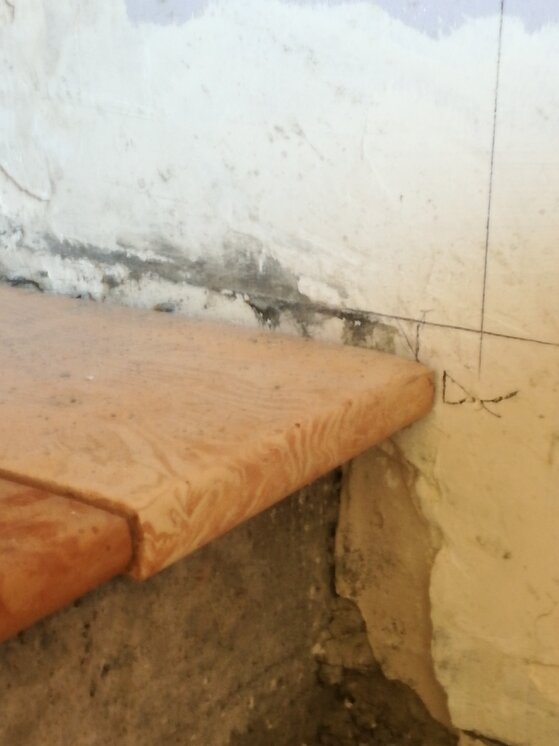

Lombard terracotta, material made by hand in my area.
20x40 size of 30 sqm cellar.
format 20x40 with rounded edge, for 2 stairs, 30 stairway steps total.

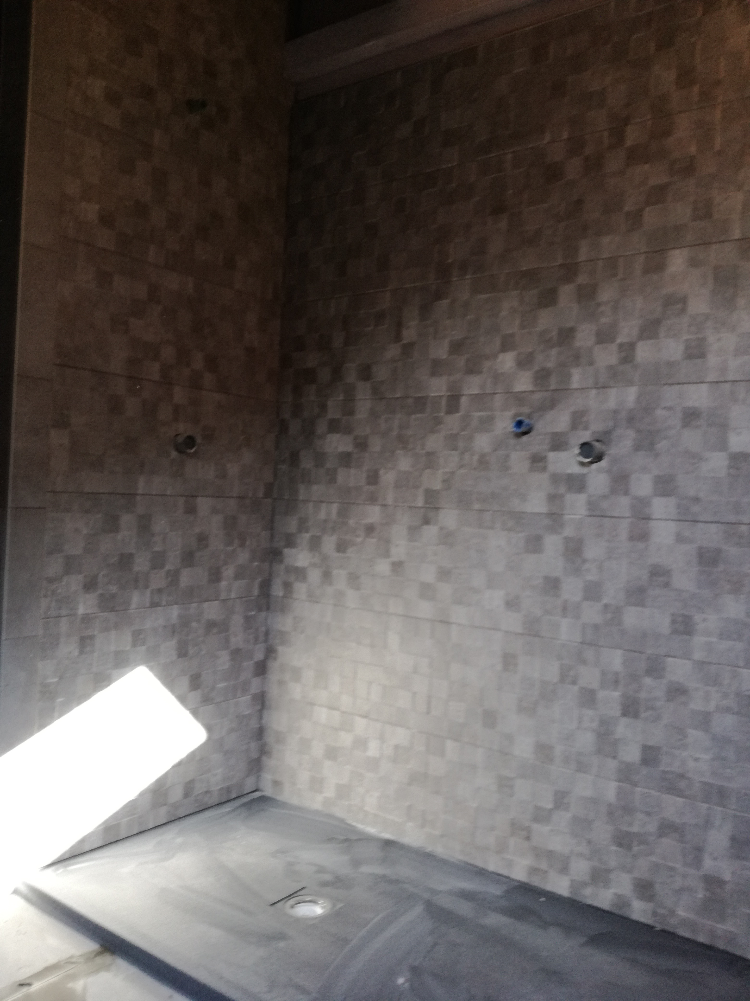

There are also three bathrooms and a terrace.

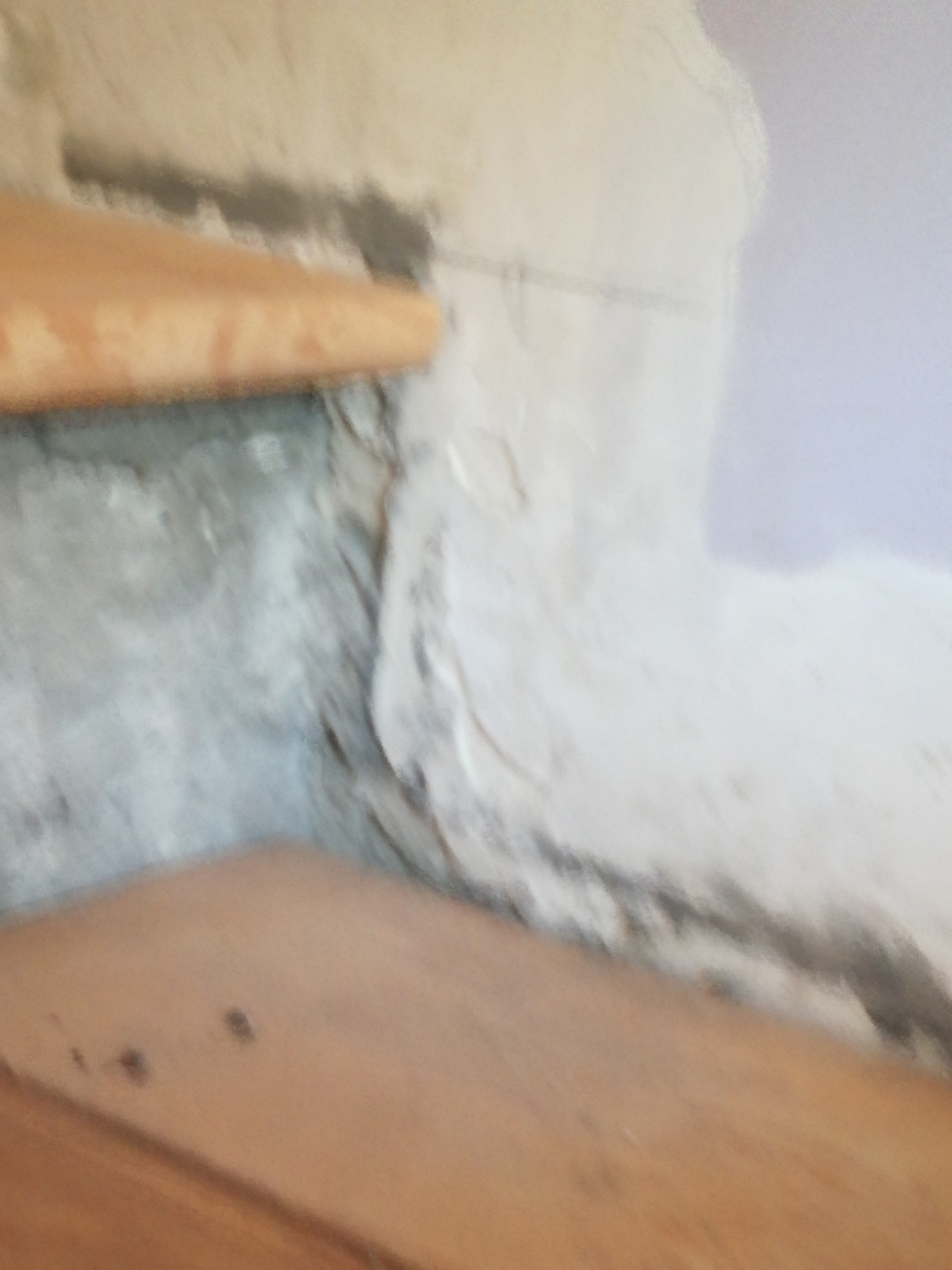

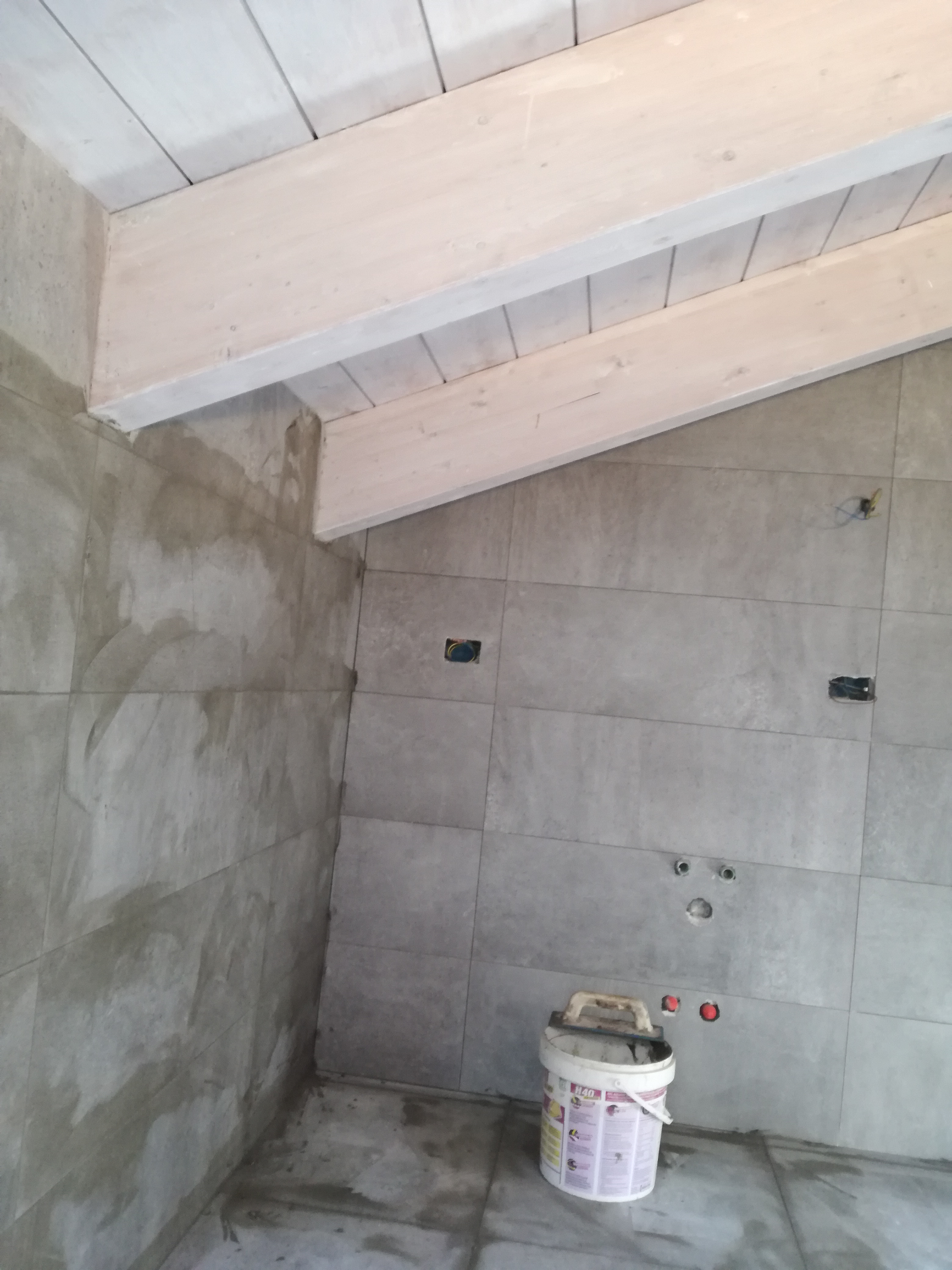

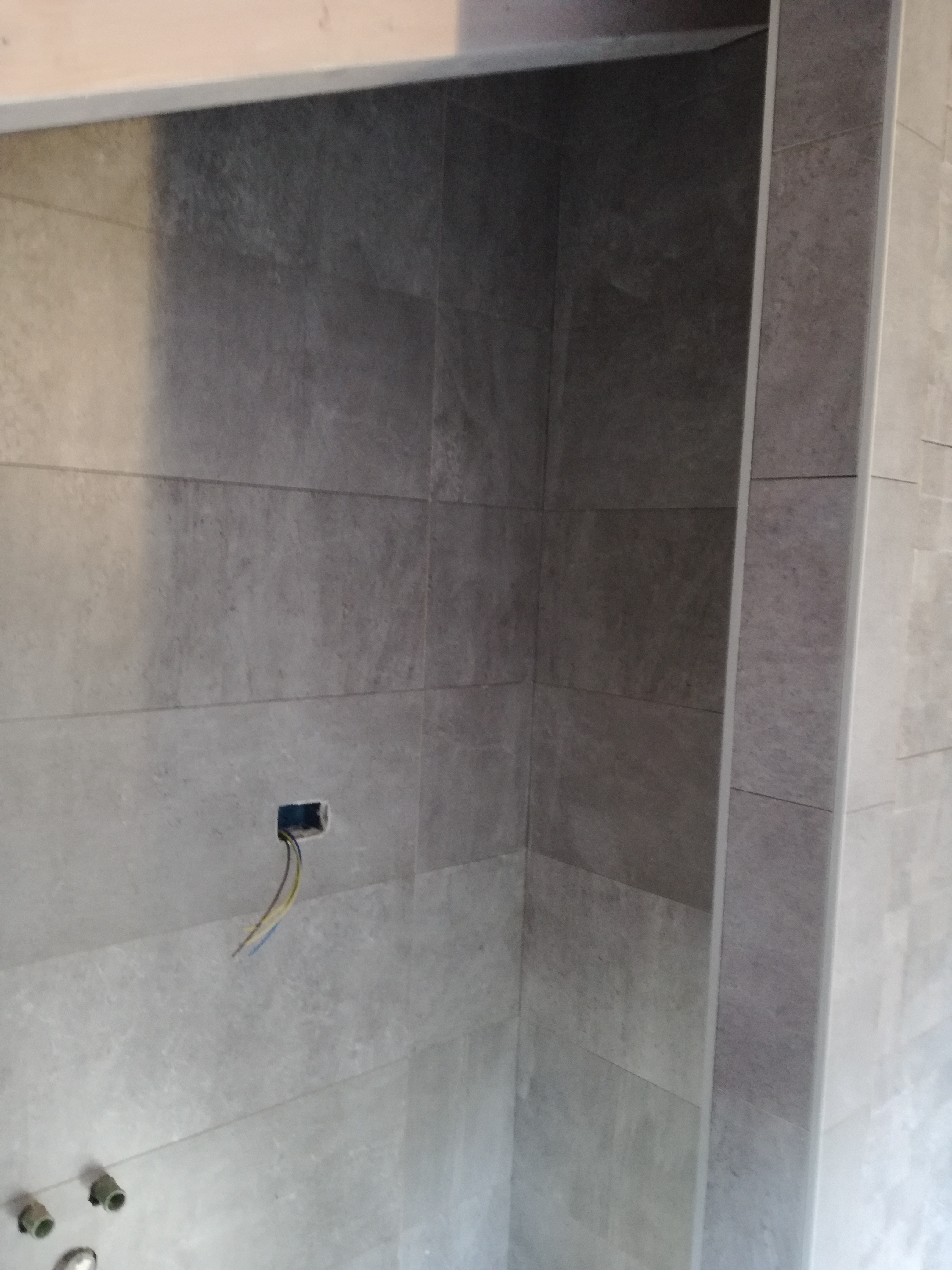

1 floor bathroom, must be laid on the product of foto3, UHF in the panel.

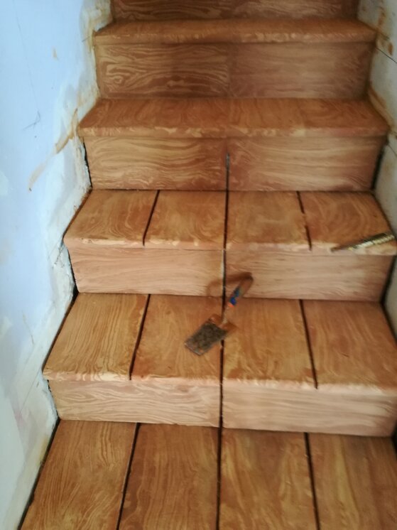

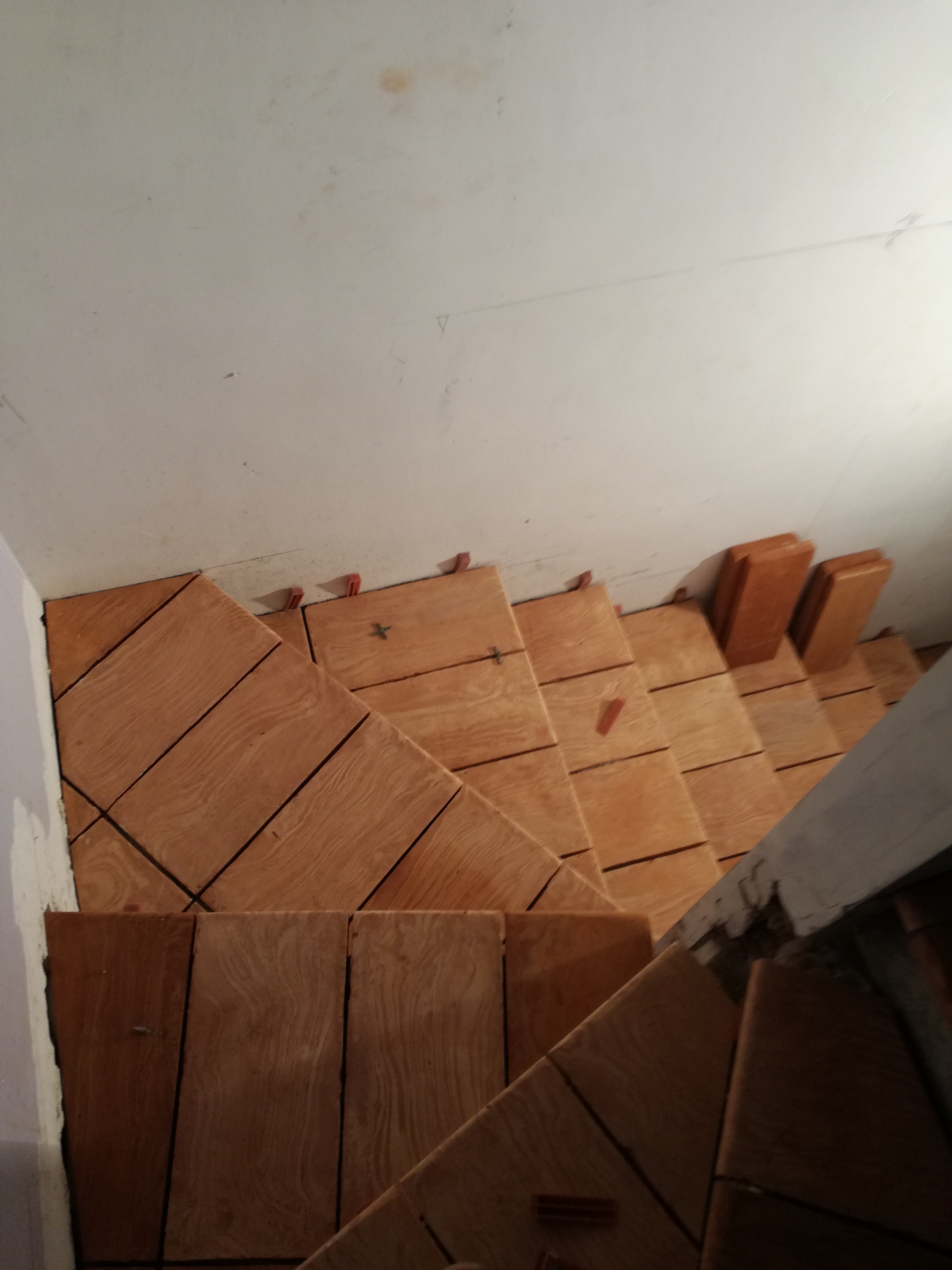

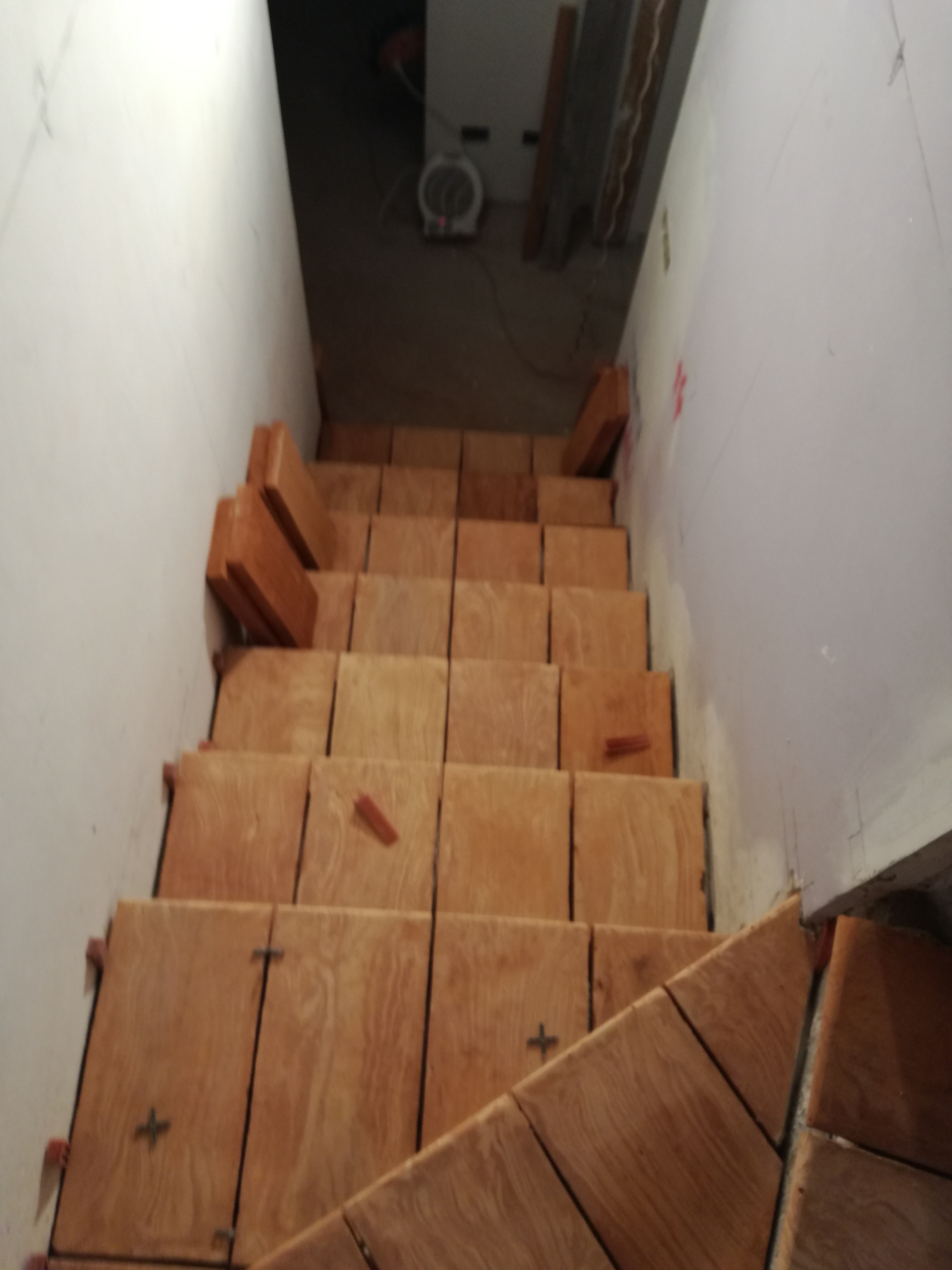

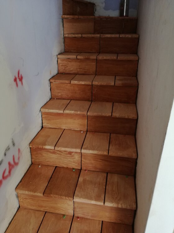

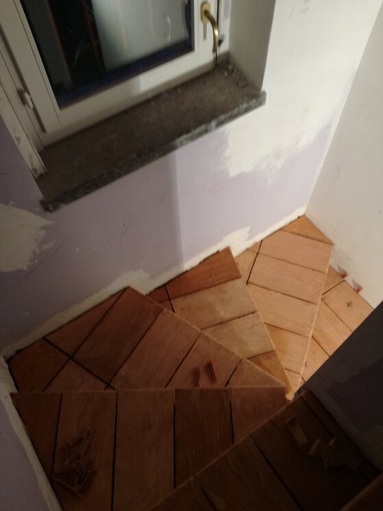

Today, I traced the two stairs, then bricklayers have made substrate.
I also made a bathroom floor, now I continue with bathrooms, stairs until drying screed.
follows

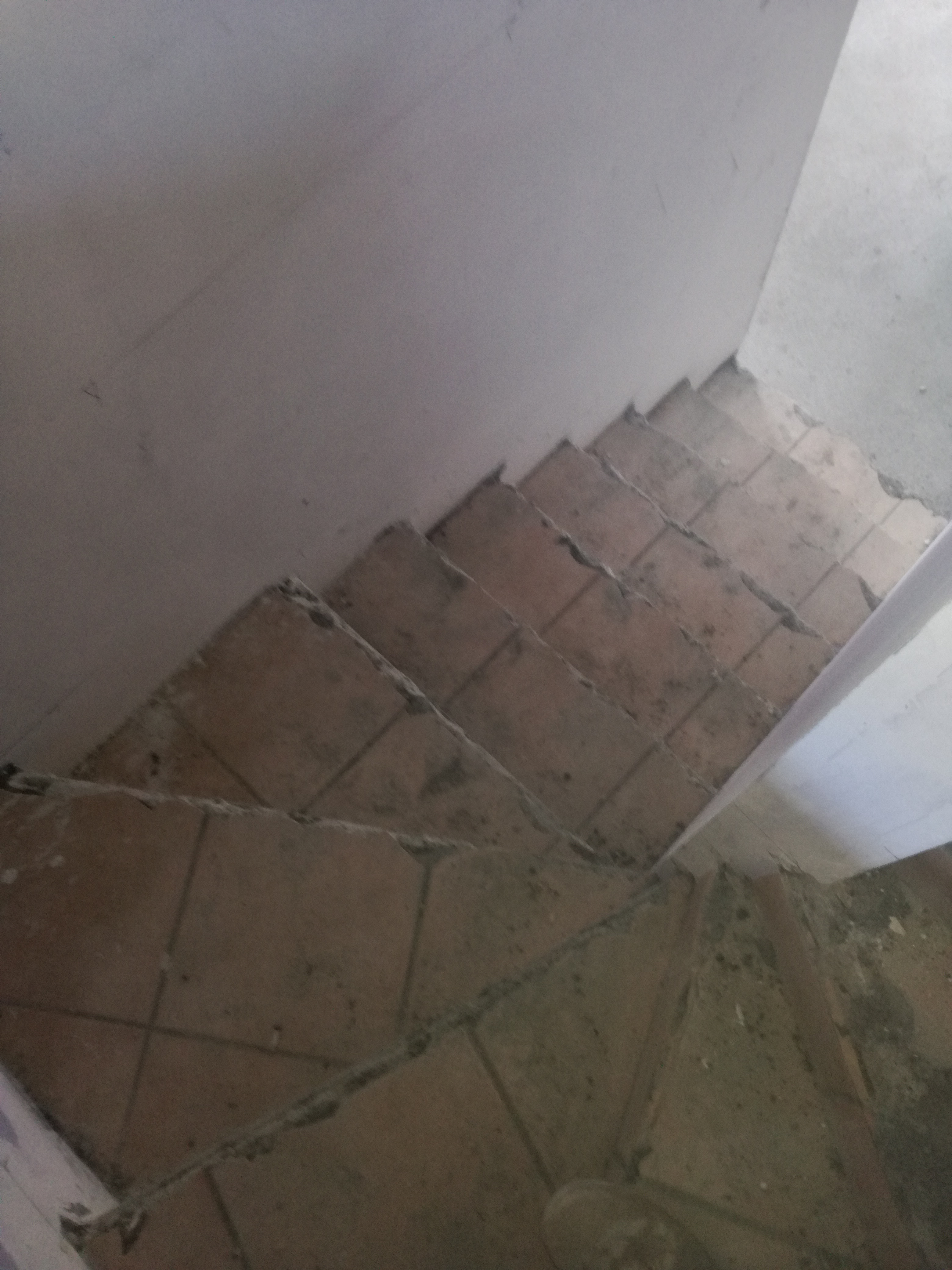

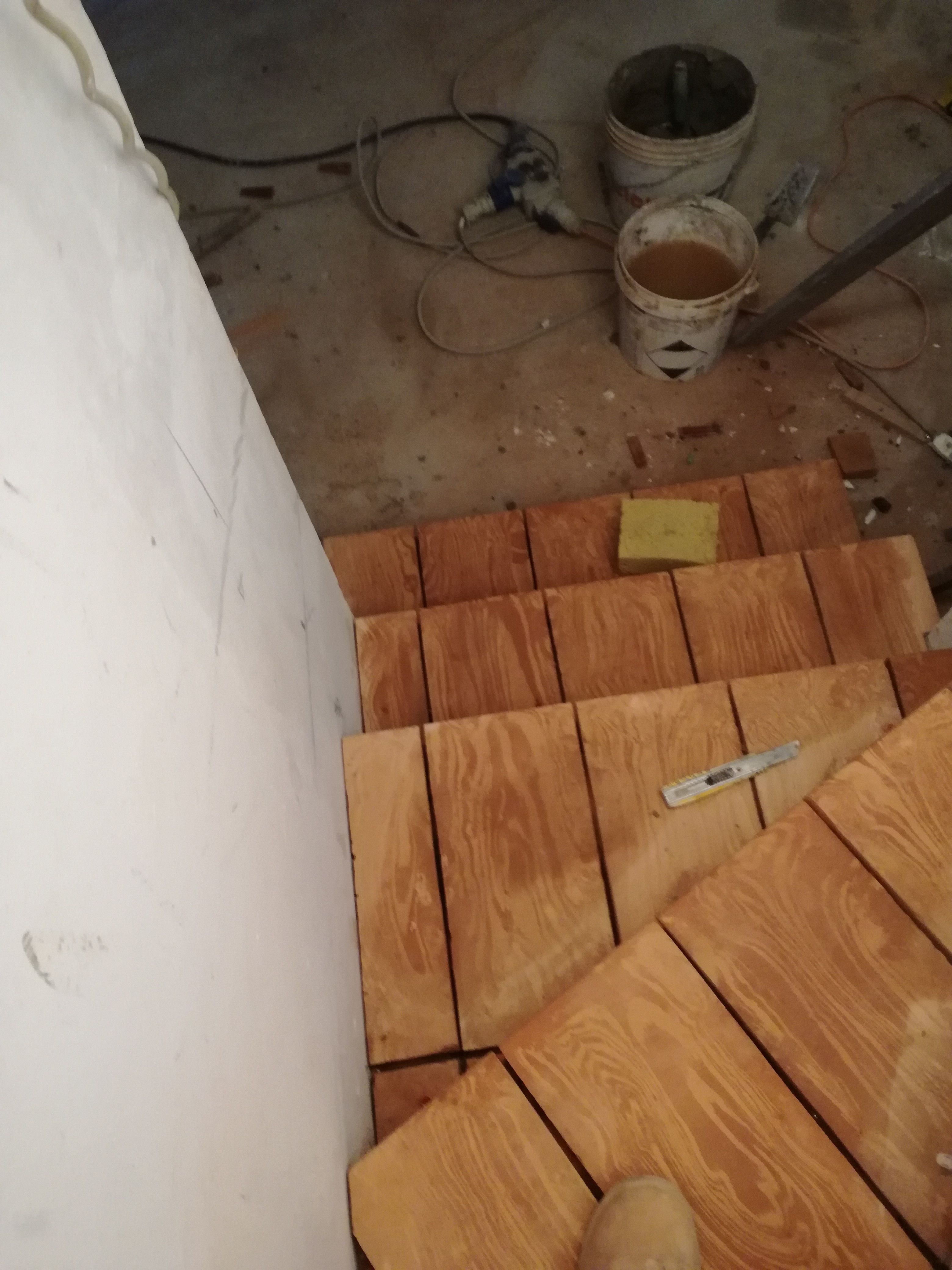

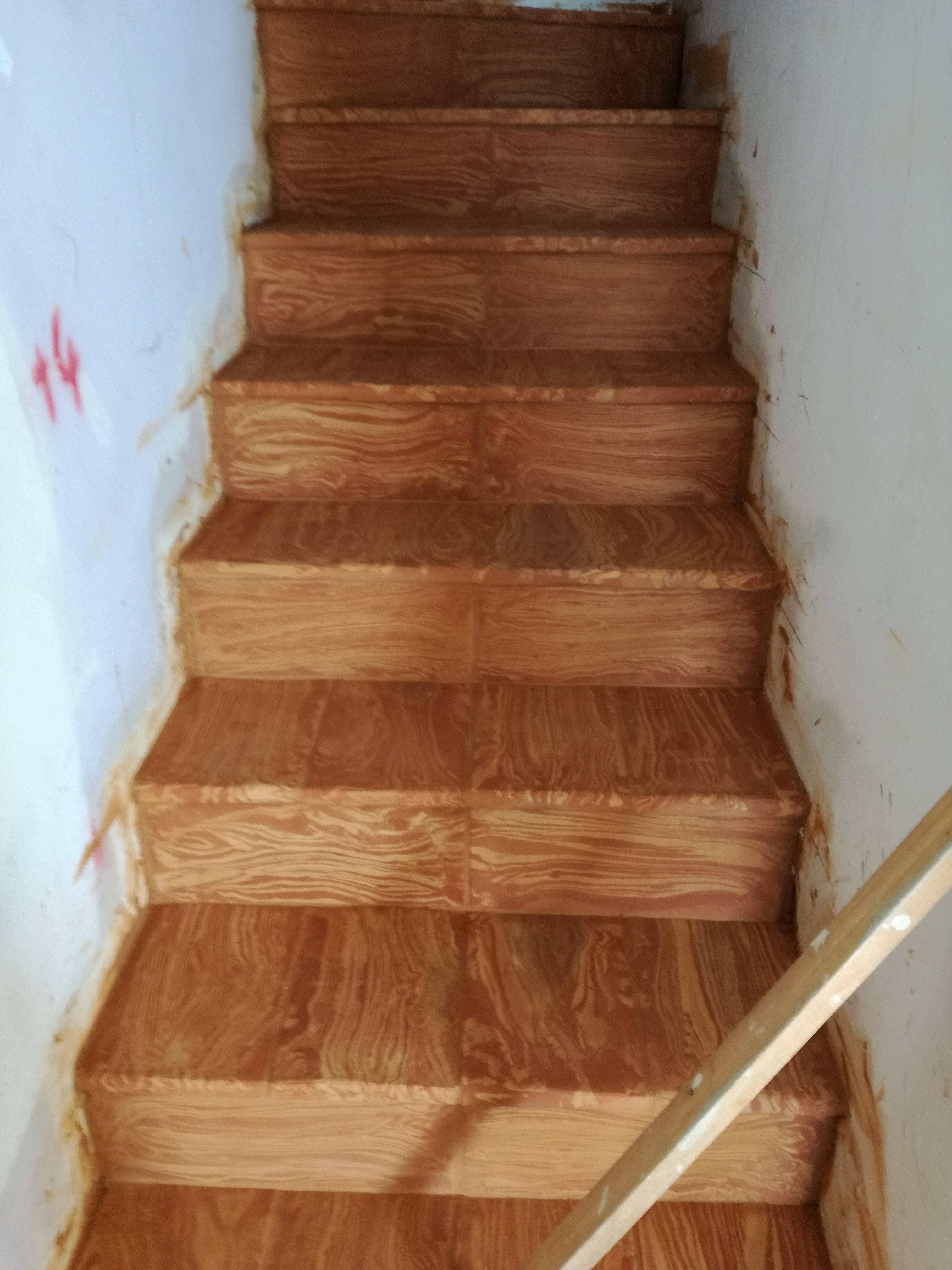

I also spoke with workers who make chemical treatment to the terracotta.
they told me to lay the whole thing and not grouting.
them, will pass with sandpaper and make pre-treatment, with the dust of sanding, I will have to do grouted.
change in plans, the steps have already been sanded, proceed to the grout without treatment.
I used "cocciopesto", mixed with white grout.
the super bricklayer was not capable of doing scale screed. 🙁
see photos .....
