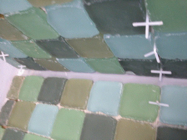

Hi Just went back to check on tiler - who wasn't there and there was a gap running up the corners - the tiles fit snuggly at the bottom but as it goes up the wall the gap gets bigger is there a way round this as thin slithers of the glass tile is gong to be very tricky surely? tile2.gif
i'd say gap is 10mm at the top, should i ring him and tell him to stop before he mucks it up more?
we need to see more photos i must say it looks a bit messy what adhesive is he using on the glass not ready mix i hope
not sure what adhesive - Bal something

I can't really understand from the pictures what is being tiled. Is it a shower area/cubicle? Are they sheet mosaic?
Looking at the adhesive i would have a stab at saying he's usinf BAL white star on glass tiles. tut tut!!
Has he started from a full sheet on the left hand side of the second picture? Looks like very poor prep is the issue here. I.E your tiler is not a professional tiler!

but yep its shower cubicle glass mosaic on sheets each individual one is 5cm
i'll check the adhesive when i see him later....he seemed professional enough......sigh, shame check a trade seems totally unreliable
Tiler has called back and he says not to worry once its grouted and siliconed I will not notice, my main question was whether as i suspected he blamed it on the walls not being true, and whether this is a valid excuse and something to accept or not?

What size is the enclosure? Is it a 1200 tray? It looks to me like the mosaic sheet are 300mm x 300mm. If he started from one side rather than the centre of the wall, and the walls went out as he went up then that would cause this problem. However, and this is the point i'm trying to make to Divad. 1200/300 leaves a full number. No margin for error, or in this case untrue walls. If the tiler had bridge the centre line with one of the mosaic squares this would of given an inch cut into the corners (25mm) this could of increased as the walls moved out going up. Rather than having slithers of varying sizes on the way up.
If the walls were that bad why attempt to tile mosaics of all things. He should of planned and sorted the walls first IMO.
The only think i will say is that if he's intending on grouting that gap and siliconing over the top then yes you would notice, and personally i would find this unacceptable.

shower tray is 1000, sheets are 300x300 and yep it looks like white star was used
The walls are newly done and flat - but width differs by ~10mm from top to bottom

White star is not suitable for glass nor should it be used a any thicker bed than 3mm. A call to BAL technical i'm 100% certain would clarifyand confirm this. They would advise BAL mosaicfix for your installation.
I know white star is said to be ok for wet areas, power showers etc. I personally wouldn't use and always go for a powder. It is of MY OPINION that your work is not being carried out correcly. What you do about it i cannot advise. I can only give you my opinion.

Is there a way round cutting slithers for the gap? Short of starting again i would say no. Asthetically i don't thihnk slithers would look right. I'm saying that because i believe although i've not seen it in photos that the tiler has started from the left hand corner. So you're going to have a slither one side and a full tile the other. This could have been avoided.
The OP suggests the tiler is going to grout the gap and Silicon over the top?? I wouldn't advise that either.
It looks like slithers in one corner is the best and cheapest option. Although i personally wouldn't be happy with that.
