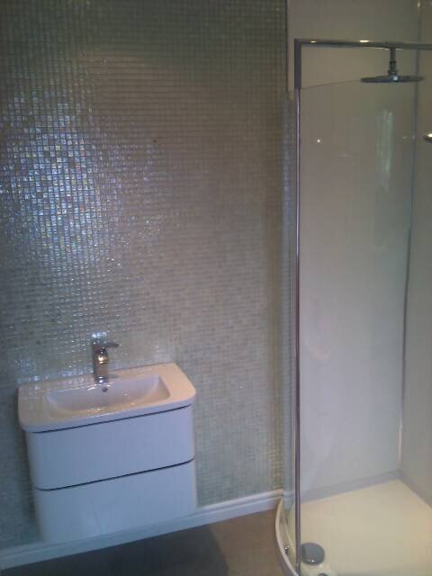

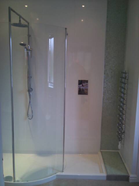

Update - all tiled and thanks for all your advice - it's certainly the place to come for all the friendly help that I've received. I won't hesitate to ask again when I start my next project - the Tyne Tunnel.

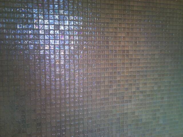

As I went to a trade show this morning I picked up a 20kg bag of Mosaic Fix - and I have to admit a lovely white adhesive which mixed to a thick smooth consistency and lasted well in the bucket for use.
Now when I go back tomorrow, to do a floor in a 450x450 porcelain, I'll check to see if they are still on the wall.
I have no doubt they will be but that is before I try to take the cellophane off the fronts, it seems very well adhered.
I shall be doing a couple of test swatches for the grout as I don't want to loose the depth of the tile that is visible at present. Does anyone know if you can get a translucent grout as I don't think I will get away with clear silicone on 11,000+ pieces of mosaic.
It may have to be white or a very light grey.
Thanks again - great place this:smilewinkgrin:
