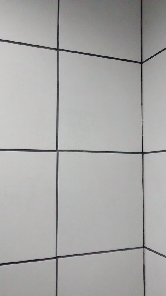

Hi all
Please advise needed if possible. How can i fix grout that has dried different shades. It is meant to be grey, but is grey and black in different parts. I treated each wall area separately as not quick enough to grout whole bathroom in 1 go, so therefore different batches were made, everything clean each time, mixed to smooth paste as per instructions. I have seen some info on efforensense, but not sure if it is that. Would it be possible or feasible to go over surface again ? Is Granfix grout any good as i have used mapei before with no issues ?

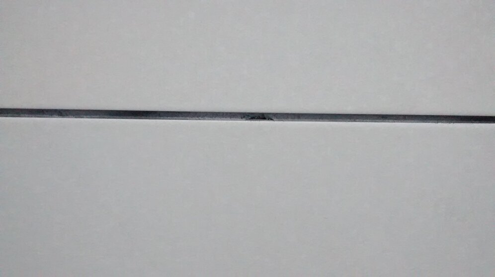

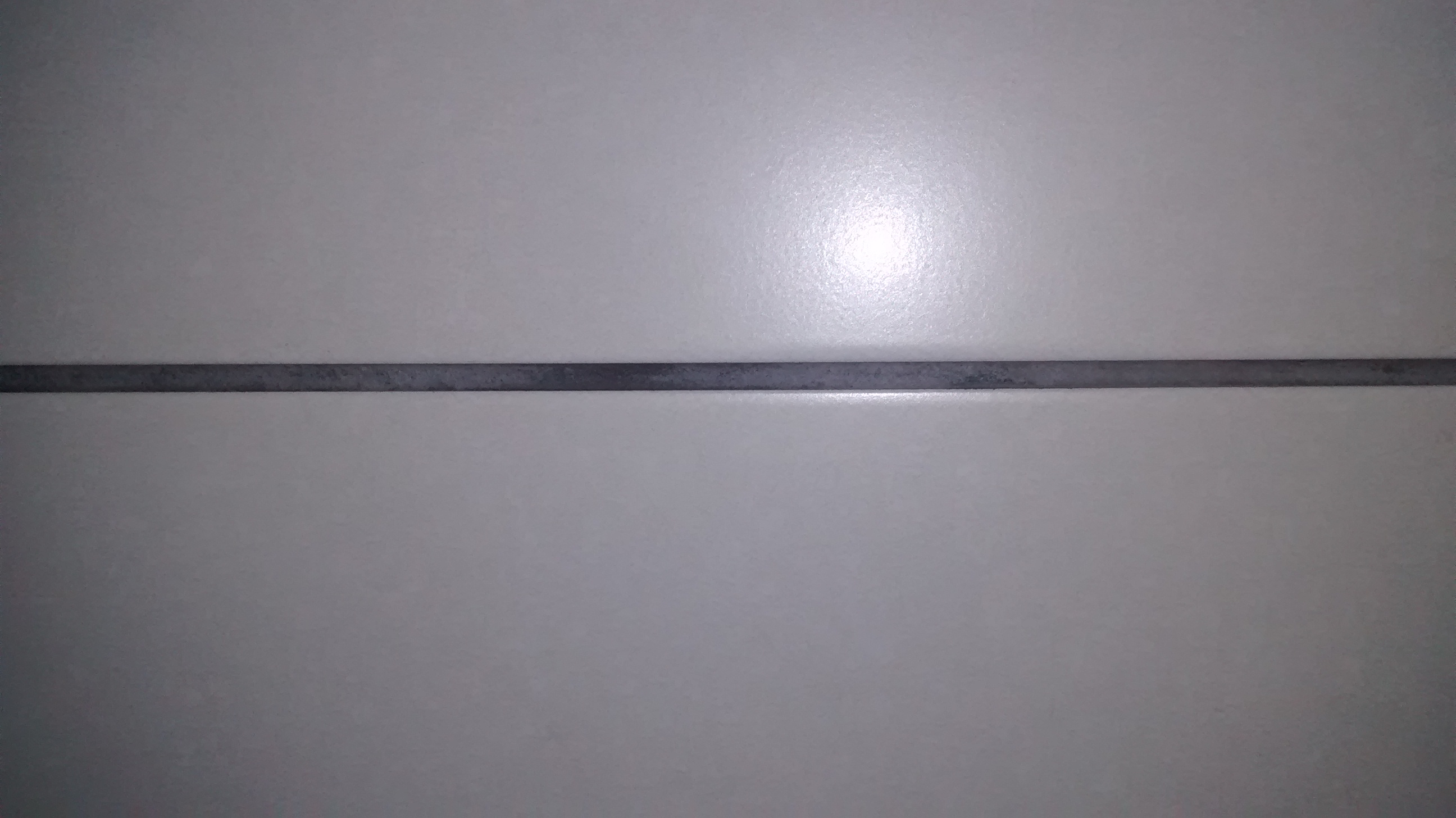

IMG_20150910_184423481.jpg IMG_20150910_184538989.jpg IMG_20150910_184557460.jpg
Hi there
I have added some pics, but not really easy to see. After some searching today, the suppliers (BB) have said they supplied the wrong colour grout, should have been light grey, but was charcoal. Customer wants me to re - grout the bathroom !!!!(21 SQM). Any tips/help/advice would be most welcome (not looking forward to this !!!!!) I will be paid extra for this, but dreading it already. is there an easy way to do this|?

Grout lines look like they've been washed off way too much. Tiles are stepping quite a bit.
Not the best tiling that.
I thought you were DIY when you first asked but you say this is a customers job. :-/
You need a tool like a Fein Multimaster with a grout removal head on it. (Available from www.TradeTiler.com) or a grout rake (also from TT). But it'll take you ages with a rake. Then re-grout.

It's more than likely moisture evaporation causing the dark patches , if you grout to early when using a dispersion adhesive , then staining can occur as the moisture leaches through the joints.
